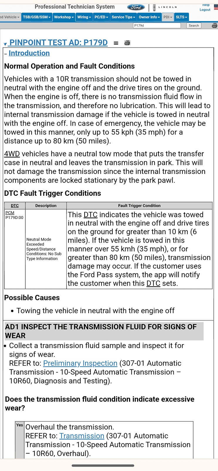

Just found this. Read carefully and you will note it calls for towed vehicle to be in park! This is the code they are using to deny warranty! What is it Ford? Owners manual says leave in neutral. This says park so parking pall is engaged.
No wonder they won't give people any information when they deny warranty.

Interesting. And it would work to tow in Neutral tow transmission in park (my Jeep was this way), BUT the procedure to disengage Neutral tow involves applying brake and putting in Park, which would happen when the Auxiliary brake system engaged, so not a good idea.
Now to disengage requires Accessory Mode to be on, but still sounds dangerous.

I believe the procedure to flat tow an F150 Raptor says transmission in park. This is also a 10speed with Advanced transfer case but the larger 10-speed transmission. I read about at least two Raptors burning to the ground and at least one taking the motorhome with it when flat towing. I can imagine the parking pawl making an incredible amount of heat should the transfer case shift back into gear while towing.

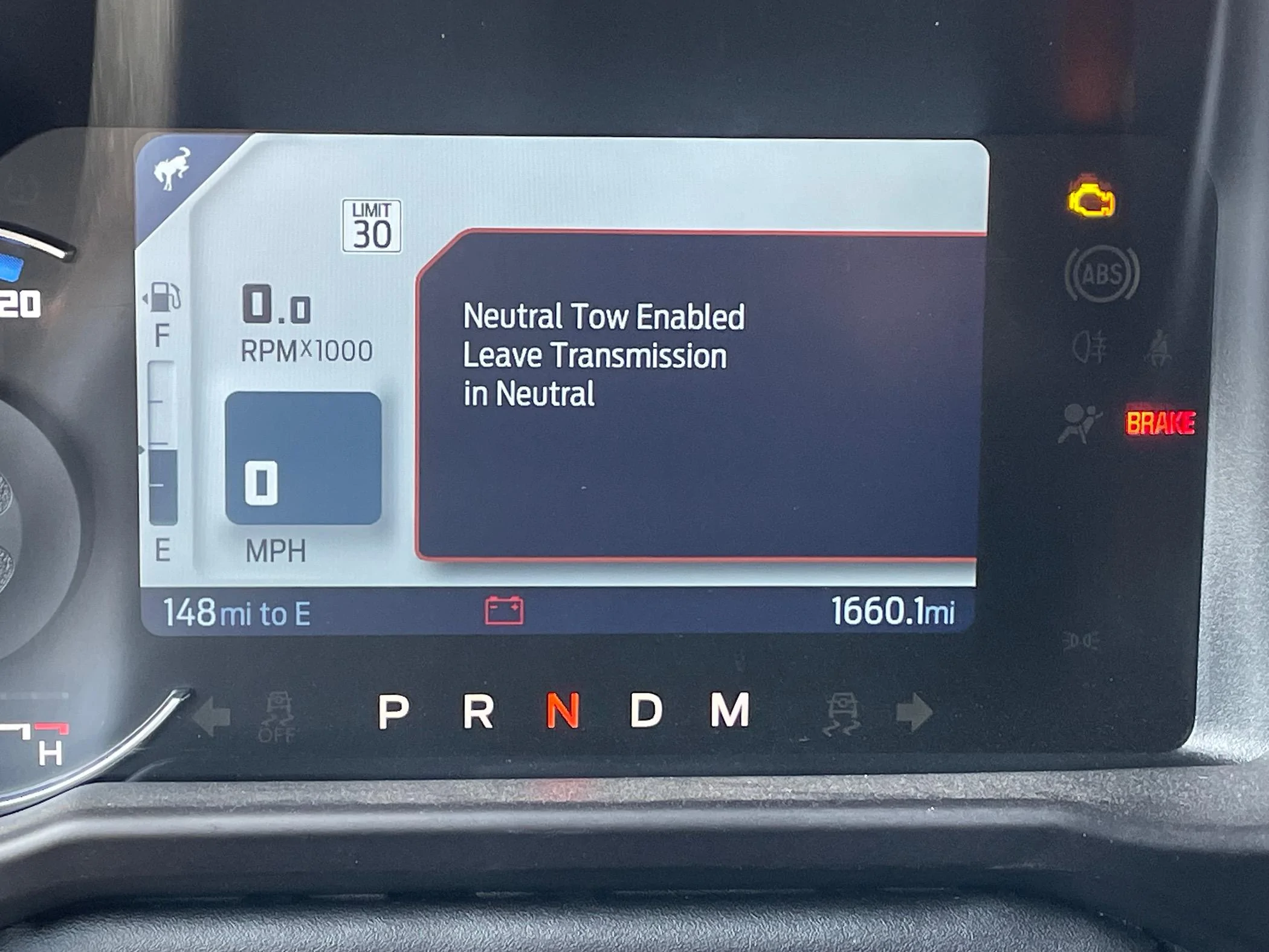

Well I just test fit the Bronco and towbar behind the MH, and for curiosity sake tried to put it in tow mode without looking up the procedure. It will NOT go into tow mode and give the “Neutral Tow Enabled” indication without following the procedure exactly. So I don’t know where Ford gets off blaming the customers for transmission failures caused by towing. NO ONE in their right mind is flat towing without the dash indicating “tow enabled”.

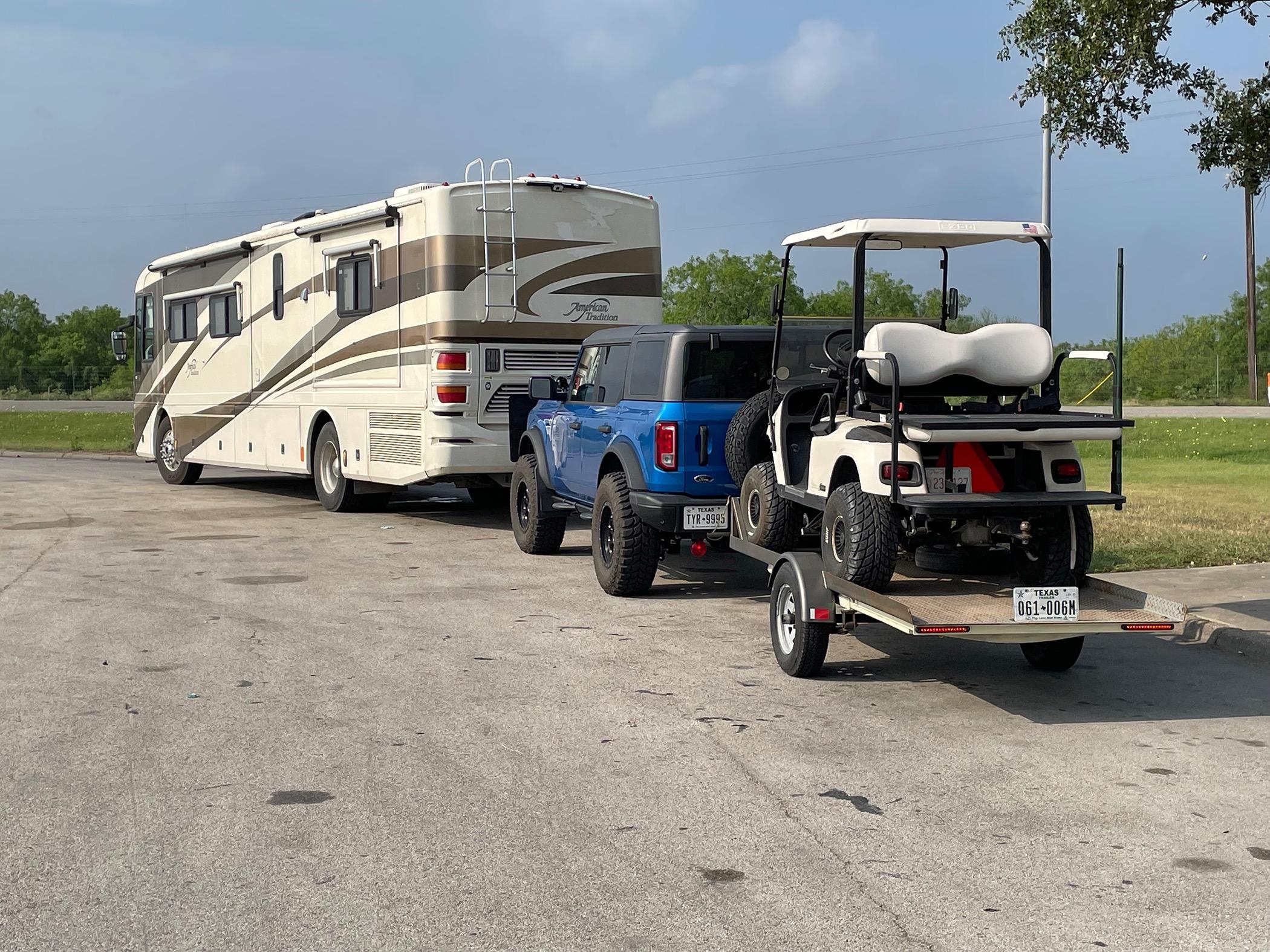

On my way to the beach Friday morning. No problems so far.

Nice American Coach, and Bronco, we just got a 2022 American Dream looking forward to finishing up the flat tow setup on our Bronco.
Hope to see you out there.
