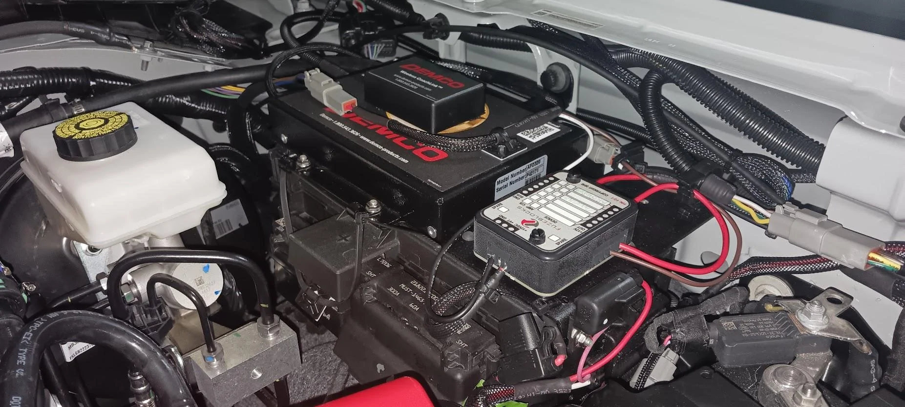

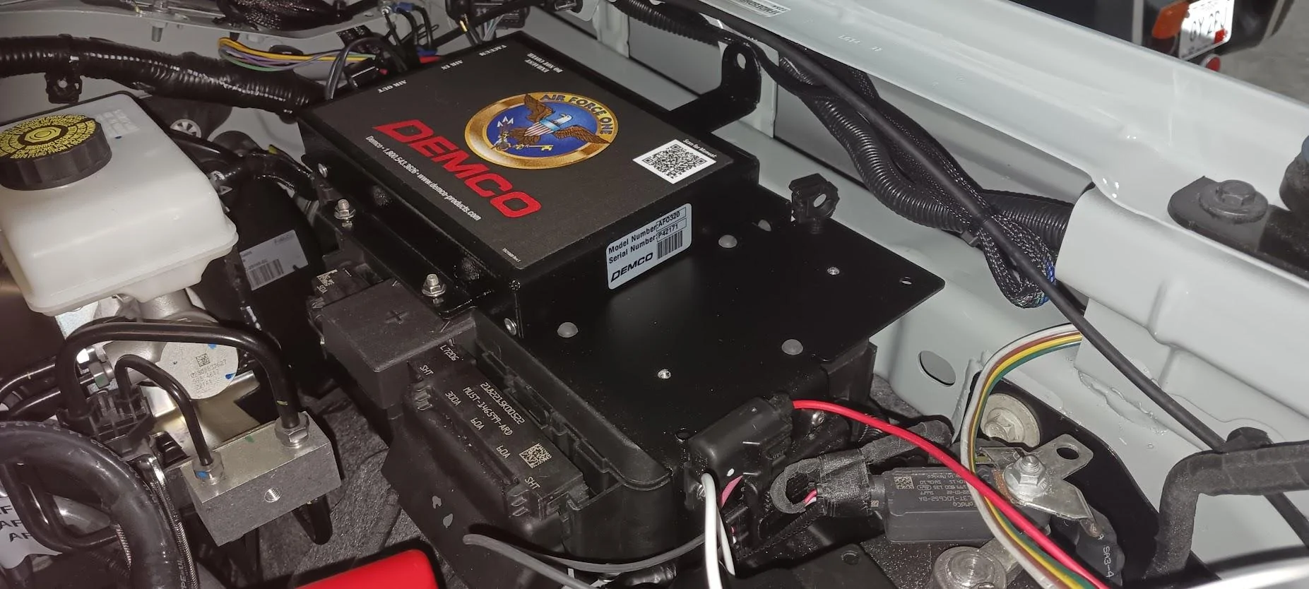

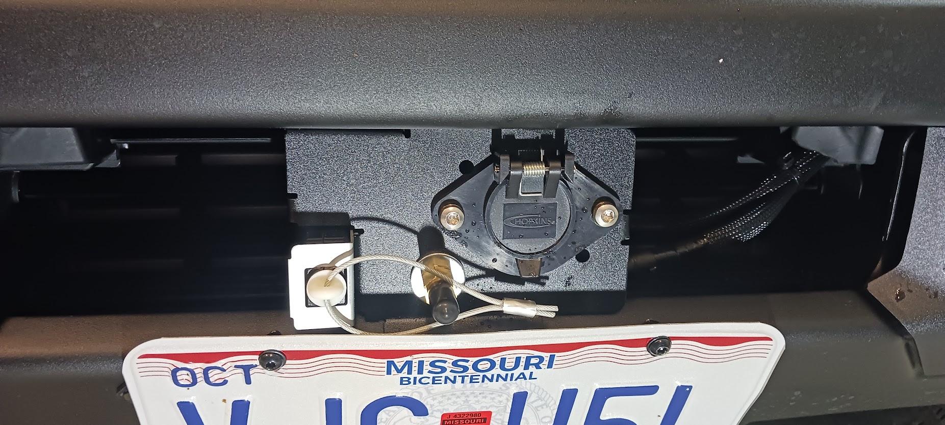

I added the charge line because I could and with my previous TOAD I left the auxiliary braking system on at an overnight camping stop and ran the battery flat. And, it is difficult to jump the TOAD battery from the RV without 40+ foot jumper cables:) My RV has air brakes so the TOAD auxiliary braking system is completely air actuated but still has a very small draw unlike my previous TOAD braking system which was fully electric. Even so, it was an easy task to add the charger when setting up the Bronco for flat towing. I used the Brake Buddy charger ($30 from Brake Buddy) and it is a charger limited to 15A rather than a direct connection so that a flat TOAD battery won't have a high current draw over 14 gauge wire. Towed Vehicle Battery Charger | Brake Buddy®
I built a plate for the connections and a plate for the auxiliary braking system (with charger mounting point). I towed it 5,000+ miles this fall with no issues. I have the modular bumper and Roadmaster Nighthawk Tow Bar and was able to get Roadmaster adaptors to attach the tow bar directly to the Modular bumper. Much better (in my humble opinion) than using the Roadmaster mounts. The only issue I had was finding a place to connect the safety cables but from this forum I got a link to the front bumper LOD frame reinforcement LoD Offroad | LoD Offroad 2021+ Bronco BLACK OPS Front Bumper Frame Tie In Brackets that have a place to connect the safety cables. I haven't installed them yet but it will beat my makeshift connection to the Modular bumper that I used in the fall.

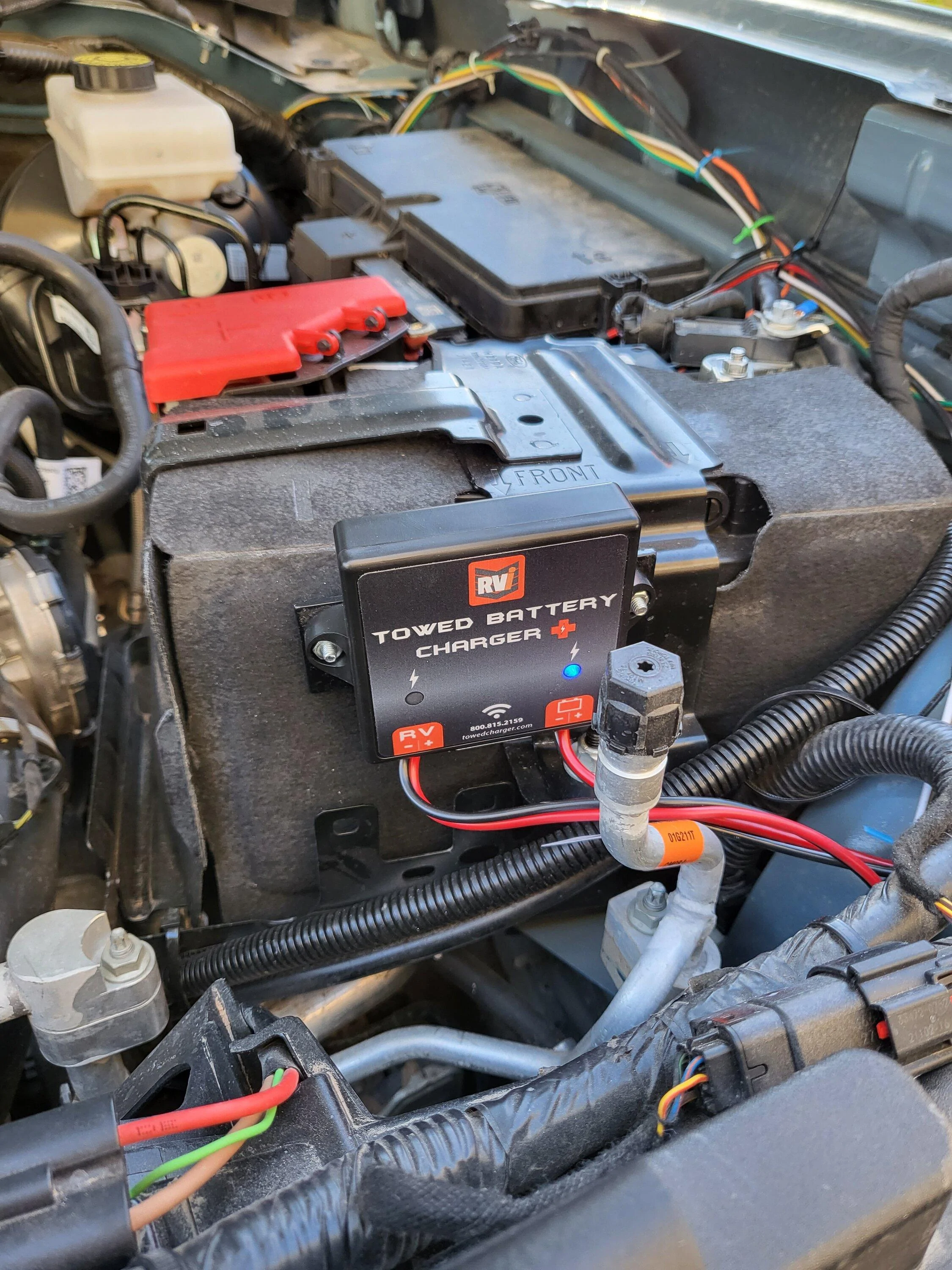

RVI charge set up
Ford Bronco Flat Tow failure 20231021_143744

RVI charge set up
I liked the RVI system with the readout but my previous TOAD used the Demco Stay-n-Play so I went with the Demco Air Force One on the Bronco since I bought a newer RV that has Air Brakes. The RVI system with the auxiliary braking and the tire pressure monitoring would be a great setup but I was also invested in the TST tire pressure monitors which have served me well. The RVI is a nice integrated system with display of tire pressure, TOAD charging and braking. If I were starting from scratch I'd probably go with the full RVI system but I didn't want to throw away what I already had.
