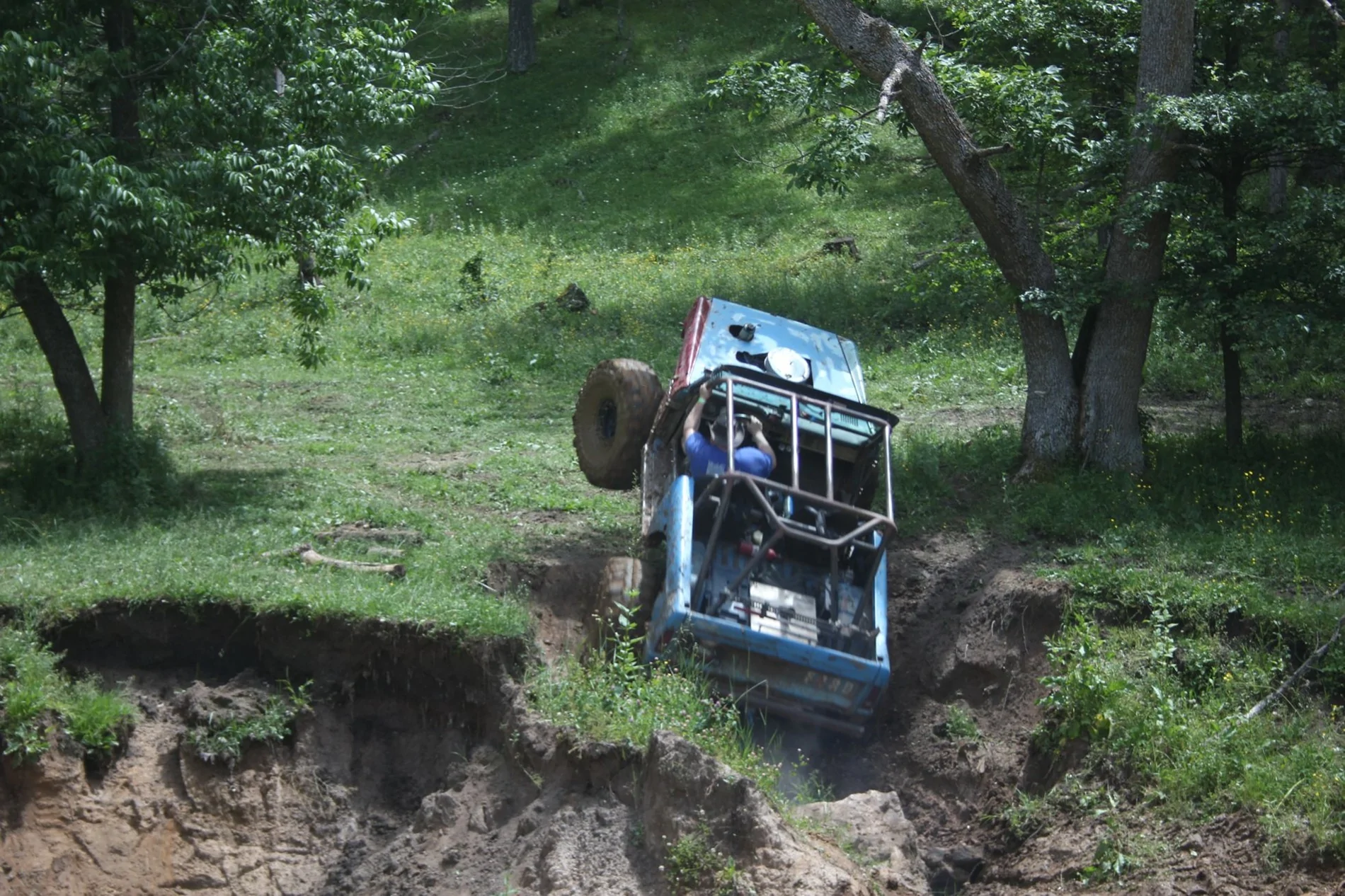

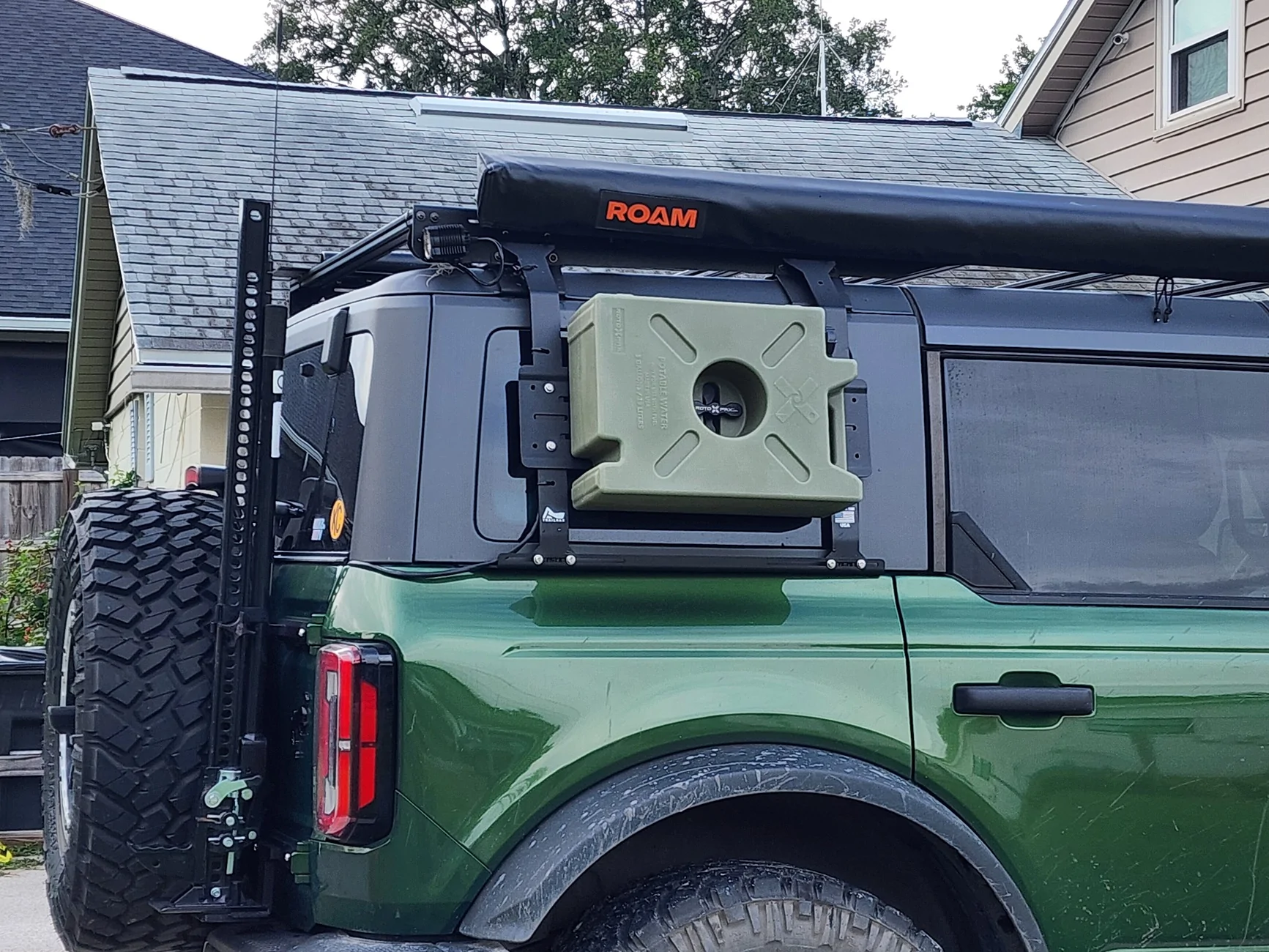

I use it if I need it and have been since the 80's. It is like any other multi tool. It does not do any one thing as great as a purpose-built tool. It replaces many. I've used them as side come along when 2 winches are already strapped to a vehicle. I've used them to get out of mud but jacking up a truck and "pushing it off the jack to get out of ruts. I have used them to lift vehicles to work on (I suggest securing with a winch and rocks as this is very dangerous). And I once used the body of two jacks as makeshift control arms to get my lifted 82 bronco out of the woods after snapping a control arm. If you were trying to remove a tire you need to chain the suspension, so it lifts easier, especially on longer suspension travel rigs. Safe they ain't, useful, I have proven they are.
As for finish and upkeep, if you use it, it will get corrosion on it. I squirt the pins and mechanism before every adventure off highway. I pressure wash it with the undercarriage upon return. As stated above poor pin engagement is an accident waiting.
