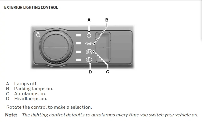

Your headlight switch will turn by itself?
Turn your headlights to the off position tonight. Check and see where that switch is tomorrow. It will be back in the automatic position.

It is not an actual switch. It is a rotation sensor with indicator lights, so nothing needs to turn for the computer to change the setting.
Oh Okay good more sensors
