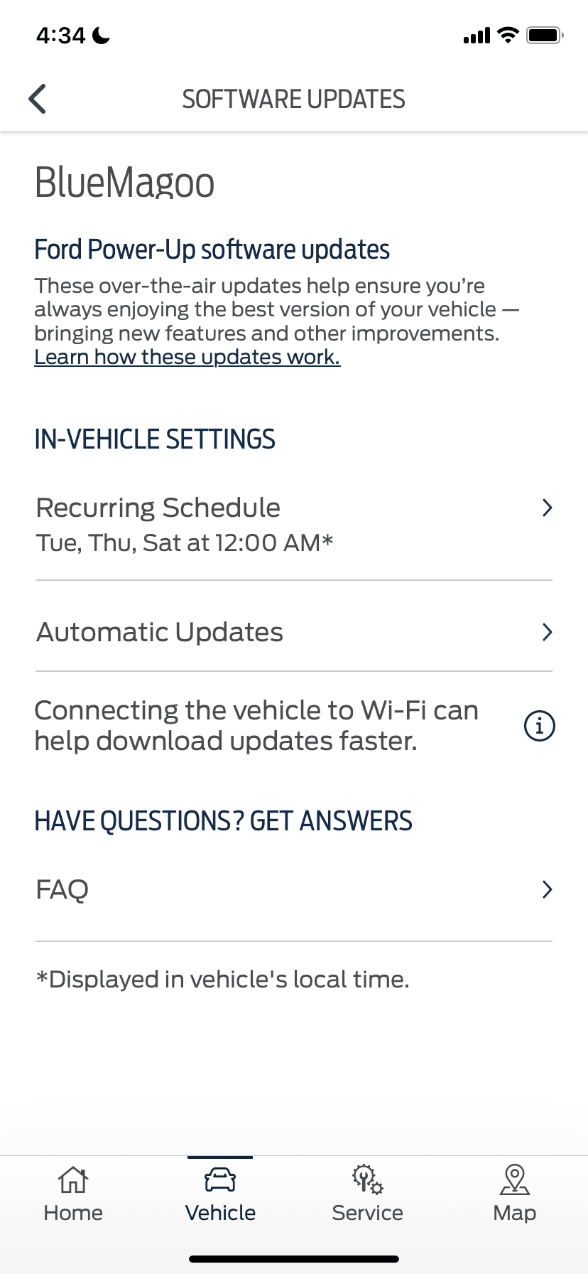

Dumb Question.. How do I tell if I had any OTA Updates Done?
Go on your FordPass app, hit vehicle on the bottom, then features and settings. Hit Software Updates and it'll tell you when you were updated. If you click that, it'll tell you what the software update did and sometimes the version as well.
I too was wondering this. I checked my app and it seems like I haven’t even received any updates at all. I would expect to see something like ā€œYou are on version 1.2.3ā€ both on my app and my car. But all I see is the below image on my app. My car just says I have the most recent version, which seems like BS. I have my car connected to my home WIFI too.
Ford Bronco Failed software update, unable to start vehicle! 04639E05-3BE3-41DE-BC23-B11510FEF517
But based on what the OP has experienced, I better change my update time - assuming I ever get an update. I don’t have full screen Car Play, so I know I’m behind on updates, but how far behind, I have no idea.
