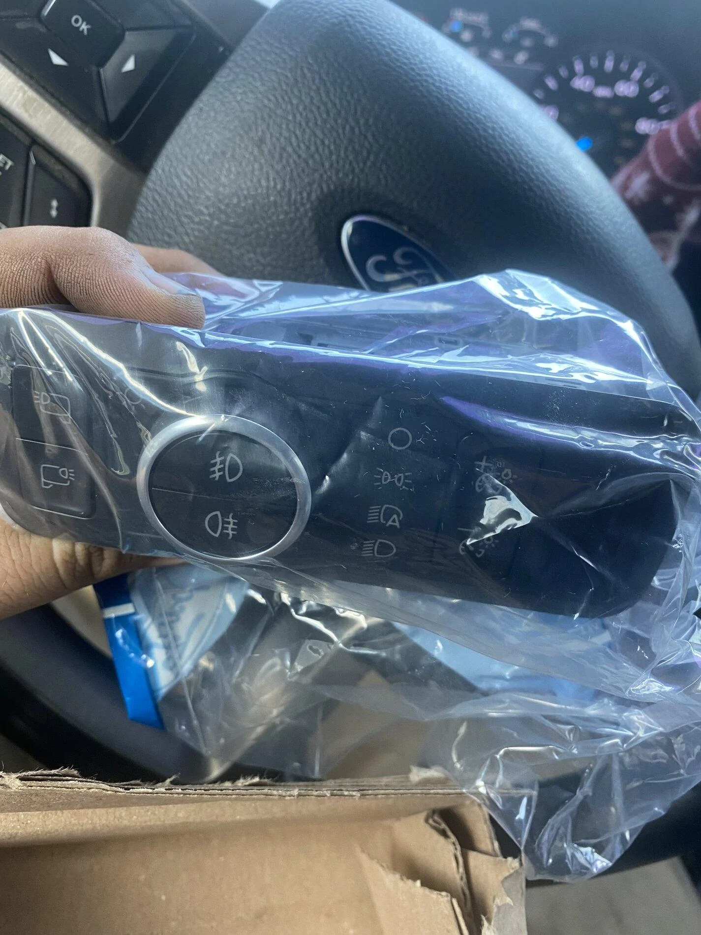

Got a switch but no bronco yet 😂
this is the one I need for my Luxe Badsquatch - I want to activate front and rear foglight - what part number is this one that has the dimmer buttons and mirror light buttons?

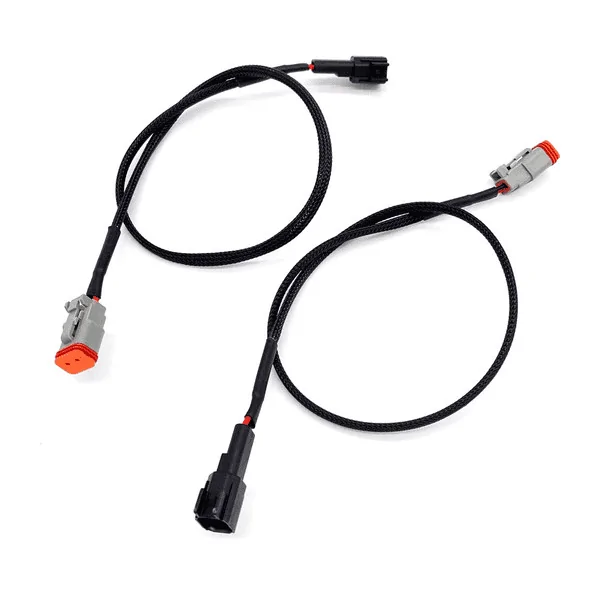

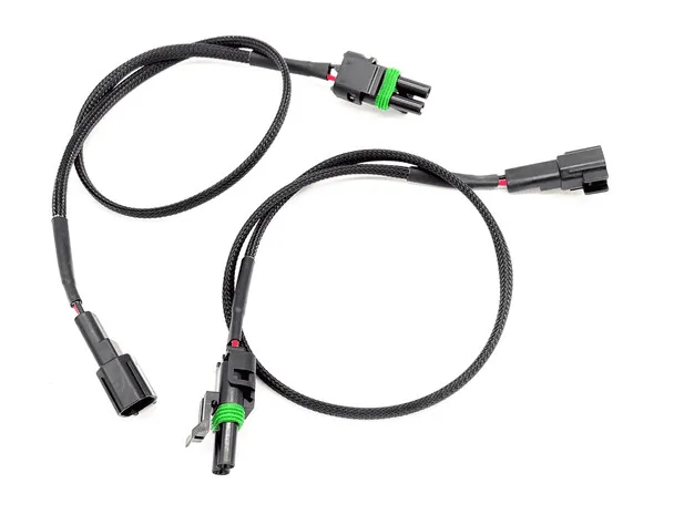

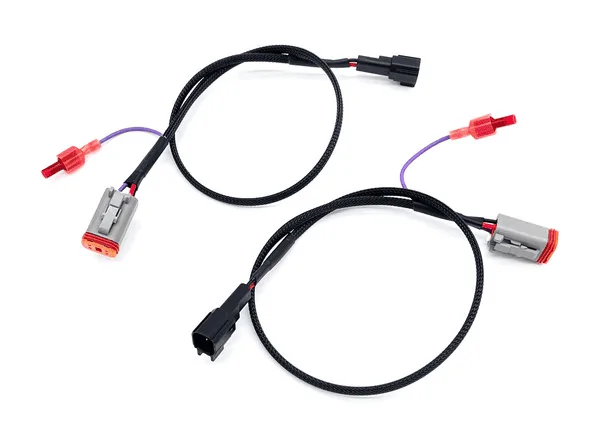

Does anyone know where I can buy a pigtail to plug directly into the factory plug from the fog light?
