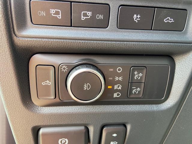

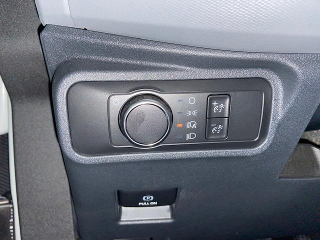

I am attaching a pic of my Bronco and my current headlight switch.
Secondly, I also have a 2022 F-150 Raptor. Is there a headlamp switch available with a dual front/rear fog lamp switch like the some of the Bronco switches posted here? Note that the Raptor has the bed light switch in the spot where the puddle lamp switches are on the Bronco, so I wouldn't be able to use one of the Bronco h/l switches.
Part number gurus, please chime in! I have attached a picture of the Raptor's headlamp switch for reference.
