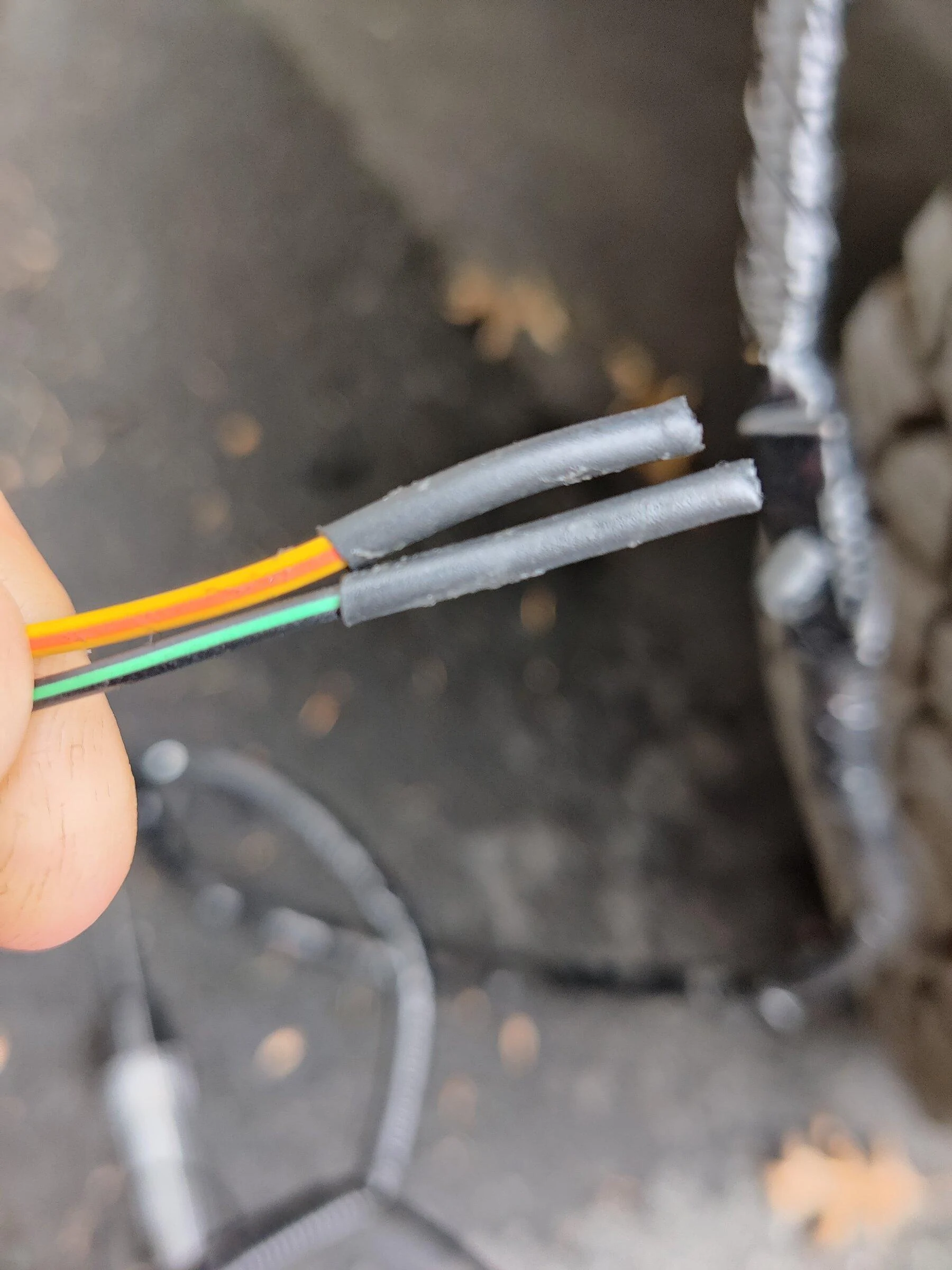

I have a big bend with factory fogs. But on modular bumper. Here are some picks of the factory wire harness for the fogs. Also what it's plugged into. Hope this helps some.
I know this post is old - but I *JUST* got my Bronco and I'm working through the pile of stuff that has been accumulating in my garage.
Including FOG LIGHTS.
So, in the above pictures, the yellow/orange is power (and brown on the other side) and the black/green wires on both sides are ground. Do I need to use *this* ground for the light to work, or is another available ground just as good?
The lights I bought have amber backlights. Will this ground work for that circuit? Or can I power the main lamp from the yellow/orange wire and use the ground available in the other wiring harness?

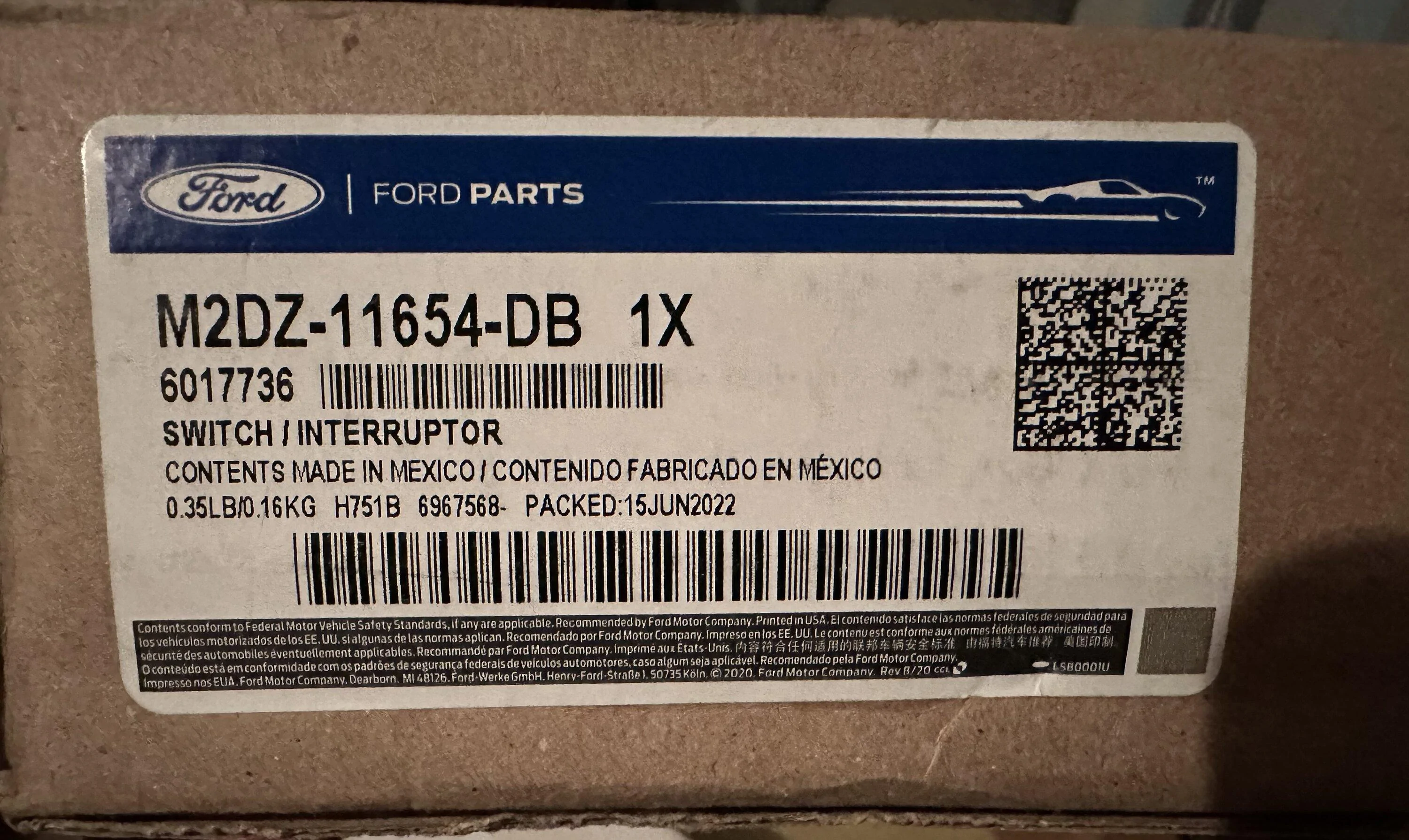

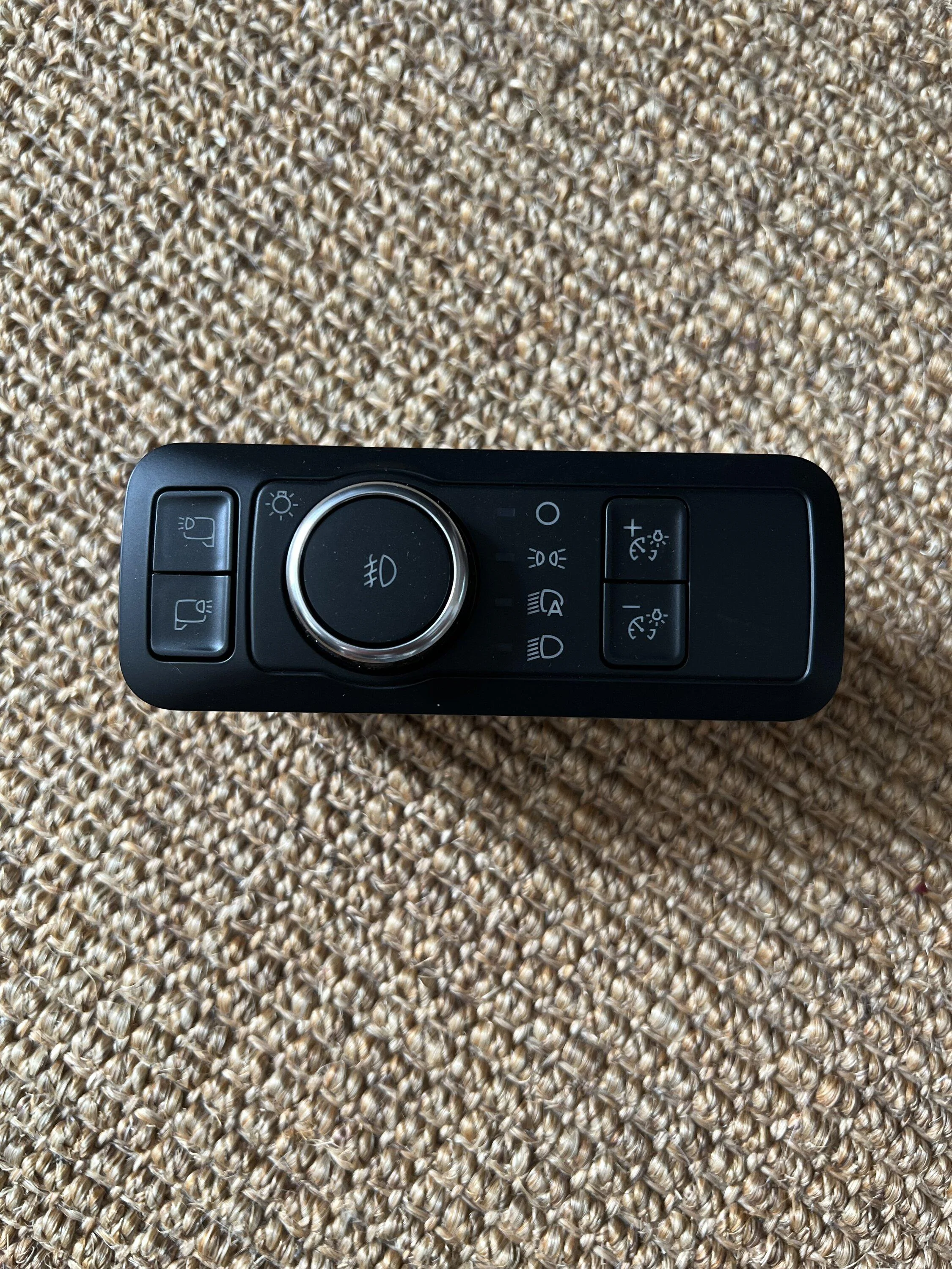

What light assembly switch did you use with the lux package? I’m seeing that the M2DZ-11654-DB is for front fog lights and puddle lights, but no blind spot monitoring. I bought the Oracle fog lights and am hoping to connect to the factory switch assembly on my OBX with Mod bumper. Thanks for sharing that the DT 2-pin works!
Did you get an answer on this? I am an OBX with LUX and all sensors, lane change, blind spot puddle lights and EVERYTHING else and cant figure out WHAT switch i need for just front FOG LIGHTS. Why FORDS mod bumper would delete this is BEYOND me....

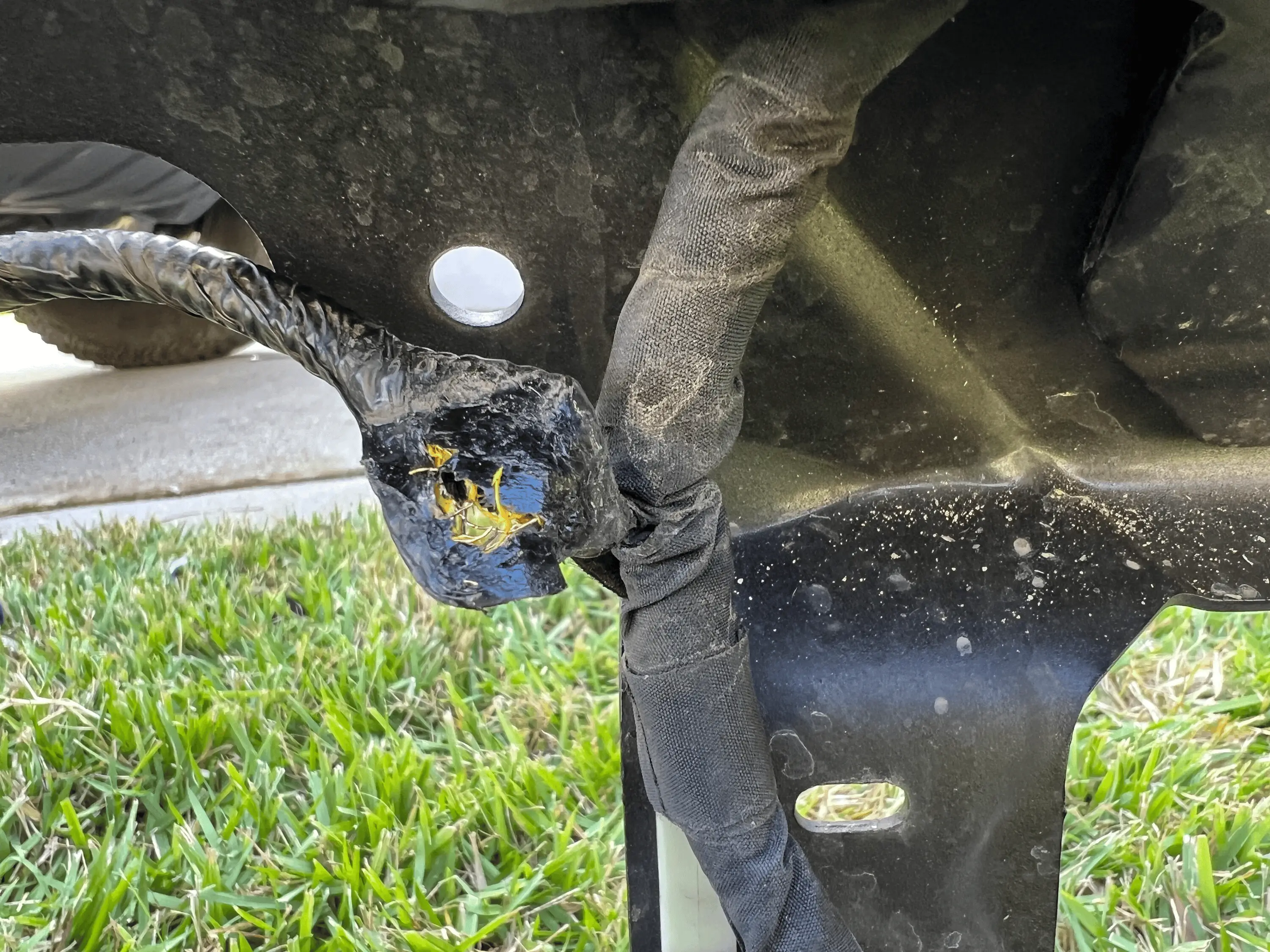

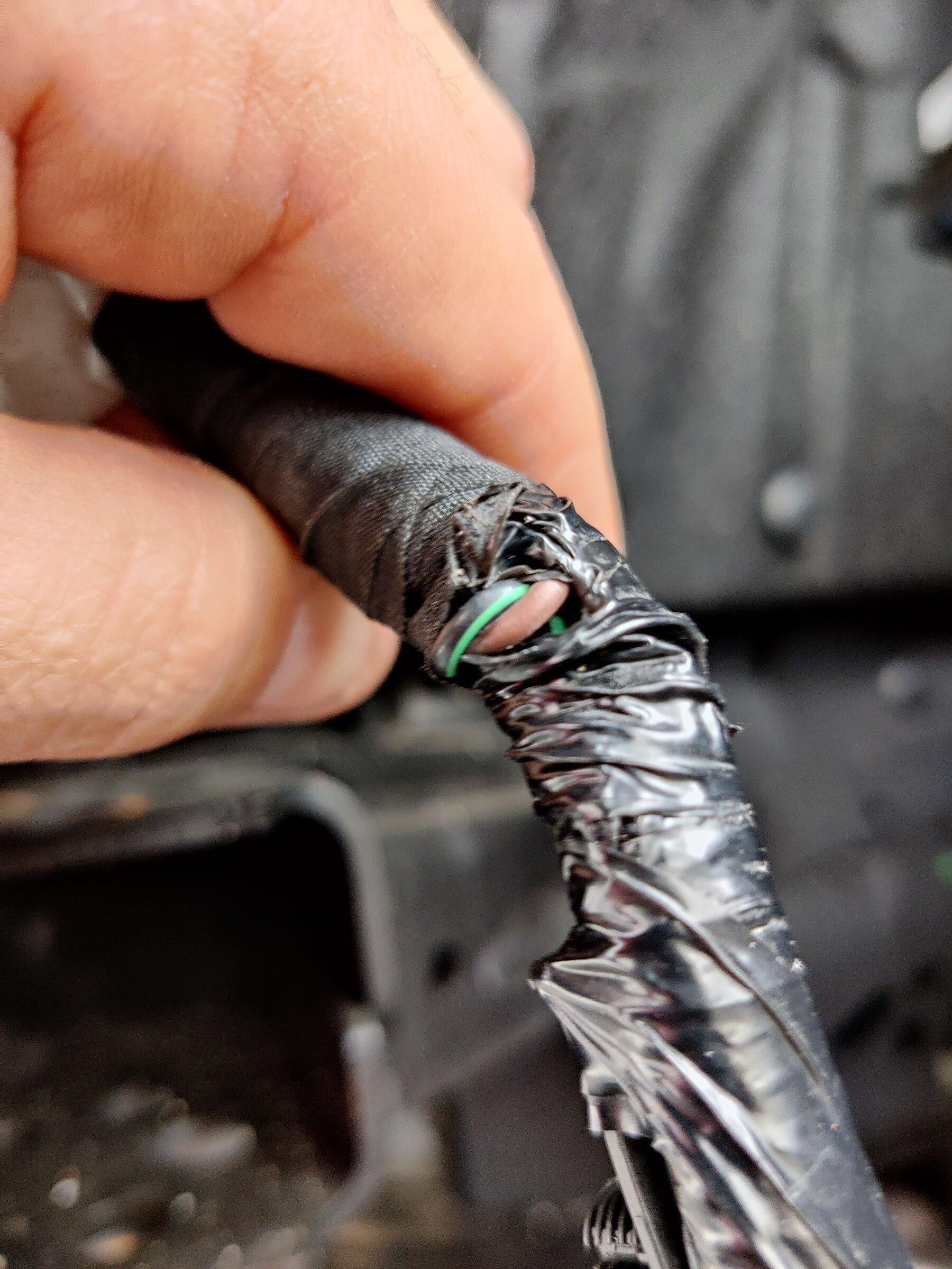

FYI.
Ford assembly pinched one of my fog light leads on the harness inside the bumper.
I was in there freeing-up the proximity sensor harness for a little bit longer reach and noticed the error. Glad I did or I'd probably be chasing my tail trying to find out why 1 side didn't work.
It was pinched between one of the backing plates inside the bumper and the bumper.
The ground you use shouldn’t matter. The BCM only controls the power side of the circuit.
I used the one in this picture… everything works perfect and it was quick and easy to swap out the light switch panel. I used the Oracle fog lights with the recommended connection adapter mentioned in my previous post. I also installed the nylon spacers on the Oracle fog lights mentioned in this thread. Everything turned out great and was really easy to install. Good luck!

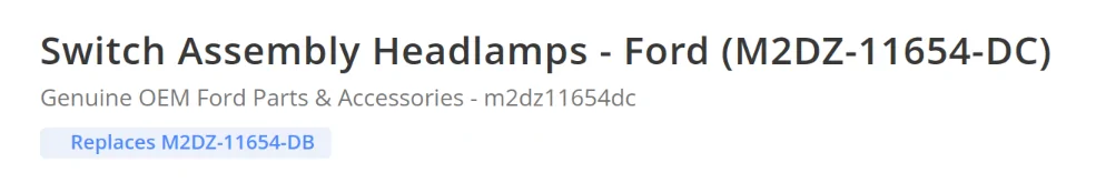

Can you confirm your part number was M2DZ-11654-DC

Perfect, I search that part number and comes up saying M2DZ-11654-DC replaces M2DZ-11654-DB. So by the sound of it, they are the same part 🤷‍♂️
Thanks dude...huge help. This thread is long and has a mind of its own!!
