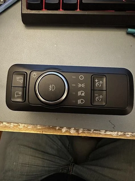

I'm looking to do the same but I have blind spot, so why in the description of the part does it say without blind spot warning????
Description:
Bronco. With fog lamps. Without blind spot warning
Are you sure it says blind spot? Some like mine have lights you can turn on the switches for those are on the headlight switch.

In my post under where is says description, that's taken right from the Ford website, that is why I was questioning the switch, I'm assuming Ford just messed up on their description. I have a WT (lux), it has all the light features on the headlight switch

That is strange I installed the dual (front and rear) switch. I wonder if since some like us have the light you can turn on if the signal for the blis indicator runs through the switch.

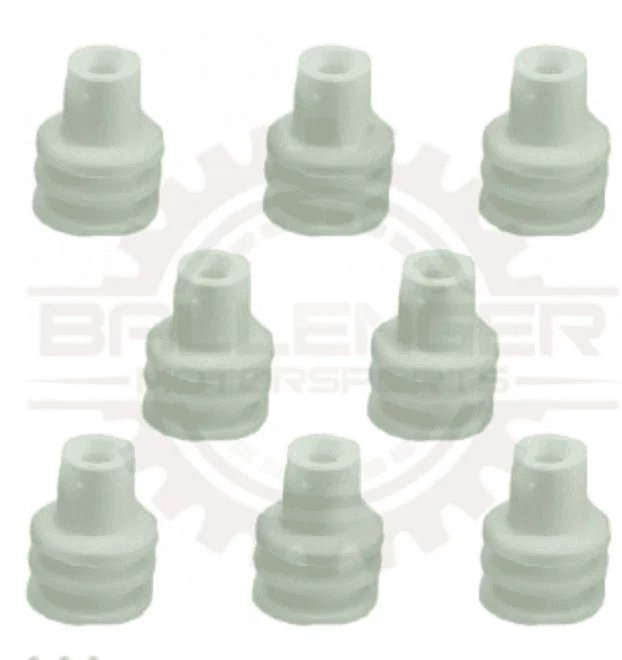

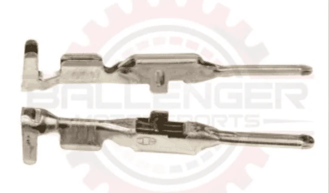

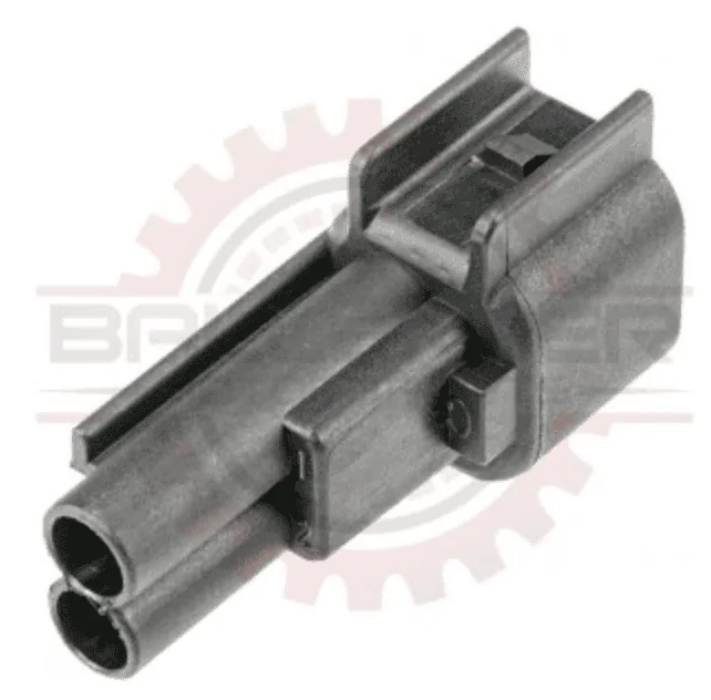

Unfortunately, a few really helpful posts in this thread were lost with d2dhanover's account being deleted. Some info provided that was really helpful and is no longer in this thread was some info on the plug for the existing factory fog wire harness tucked under the bumper shackle. It has an existing cap/plug end that is being used to keep the end water poof, and it can be re-used to connect the fog light to the factory harness. Looks like this:
Ballinger Motor Sports carries the parts (male pins and seals) needed to convert the existing cap into a usable water proof connection.
https://www.bmotorsports.com/shop/a...search_in_description=1&keywords=+CONN-100986
The males pins are: CONN-100986
https://www.bmotorsports.com/shop/product_info.php/products_id/4568
The seals are: CONN-56057
https://www.bmotorsports.com/shop/product_info.php/products_id/486
I have the pins and the seals, but can't seem to get the connector together.
Is there a specific crimper I should use? Is there an insertion/extraction tool that works with these?
Any assistance will be greatly appreciated!

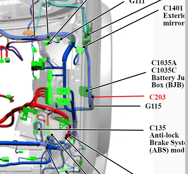

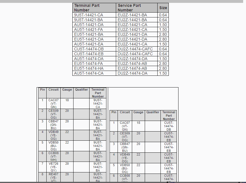

Can anyone with a 2022 Black Diamond + Modular Bumper confirm whether there is wiring from factory in the bumper? Early models from 2021 don't - which I documented thoroughly early in this thread - but, I am wondering if now that capable bumper is standard equipment that this is no longer an issue.
I would love to get the part numbers for the wiring from the bumper all the way up to C203 (I believe it's two parts/harnesses). Now that the dust has settled a bit on parts inventory - I wonder if these are available now. @flip - can you help?

flip
Base Sponsor (Level 1)
Phil
4,834
16,027
IN
www.ruxerparts.com
Fords
Ford Bronco Factory Fog Light Switch 1669031867473
Ford Bronco Factory Fog Light Switch 1669031841130

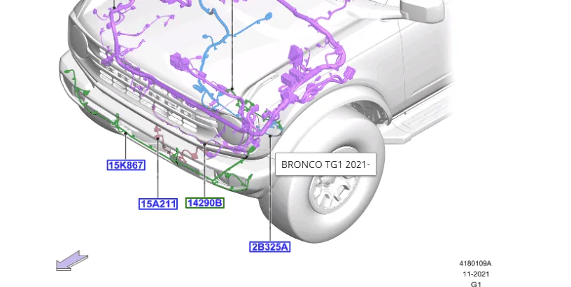

C203 is here...and part of harness 14A290 which is the purple assembly in the above pic.
Ford Bronco Factory Fog Light Switch 1669032155698

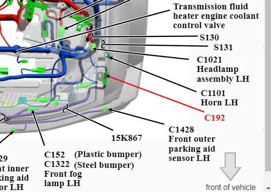

Closest you may be able to get the smaller sections is from C192 is the 14290 but that harness shows it's for the grille shudders. Probably going to be easier (and cheaper) to just add terminals to C203 out to the fogs.
Ford Bronco Factory Fog Light Switch 1669032297736
C203 terminal part numbers.
Ford Bronco Factory Fog Light Switch 1669032547587
