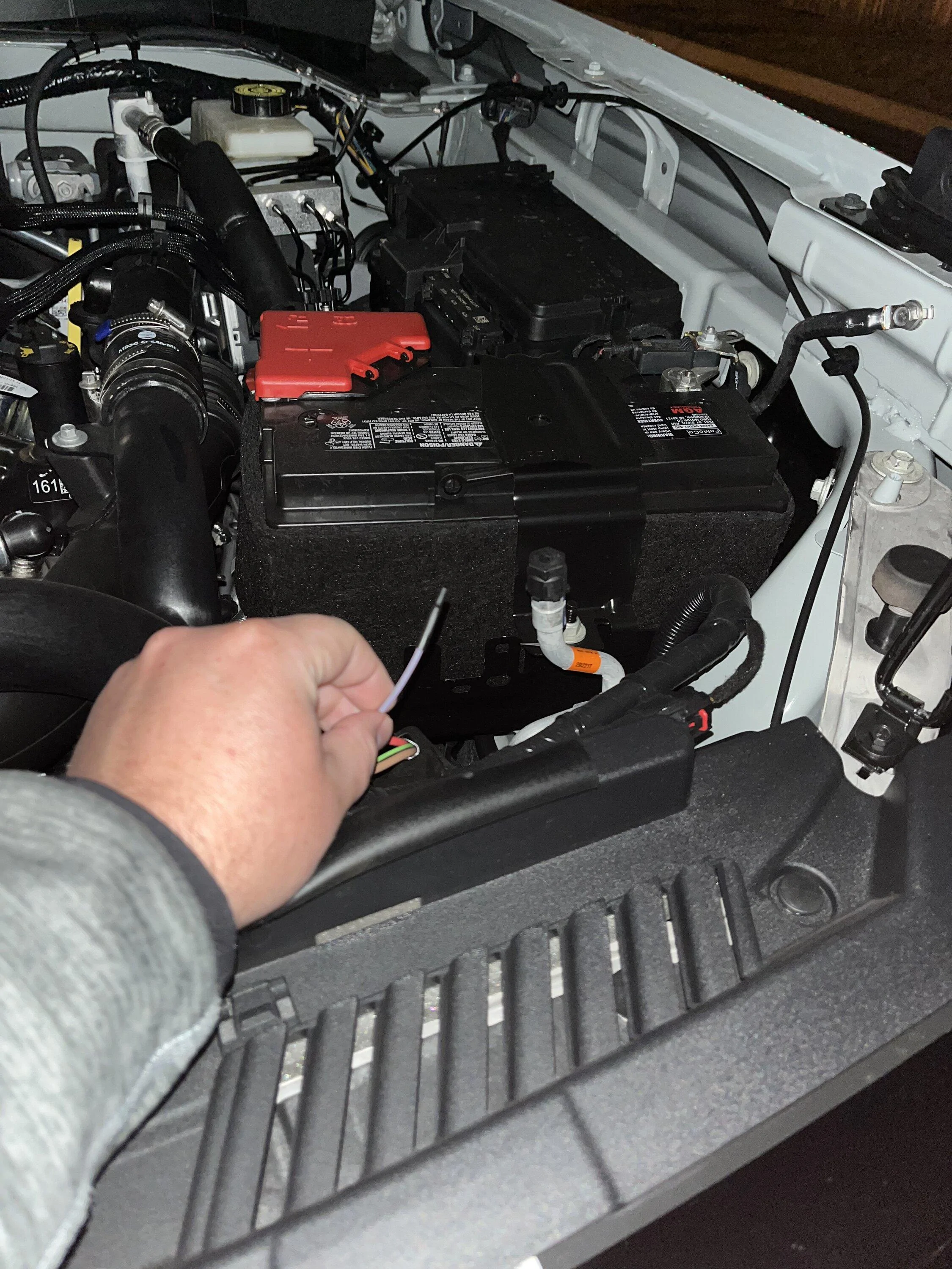

I have read through this entire thread and I'm still confused...
I have a 22 Wildtrak Mid Package with Mod Bumper (no front sensors).
I ordered the single front fog light switch, but haven't installed it just yet because when I went to find the factory wiring down at the bumper, I can't find the connector.
How do I utilize the new factory switch if the wiring is not already there?
Can I wire directly into the new switch somehow?
I also saw a purple with grey stripe wire that has heat shrink on the end at the top of the engine bay right next to the top of the grille. Is that a wire for one of the upfitter switches?
I thought they were all bundled up at the back of the bay next to the brake booster.
Any help is much appreciated!

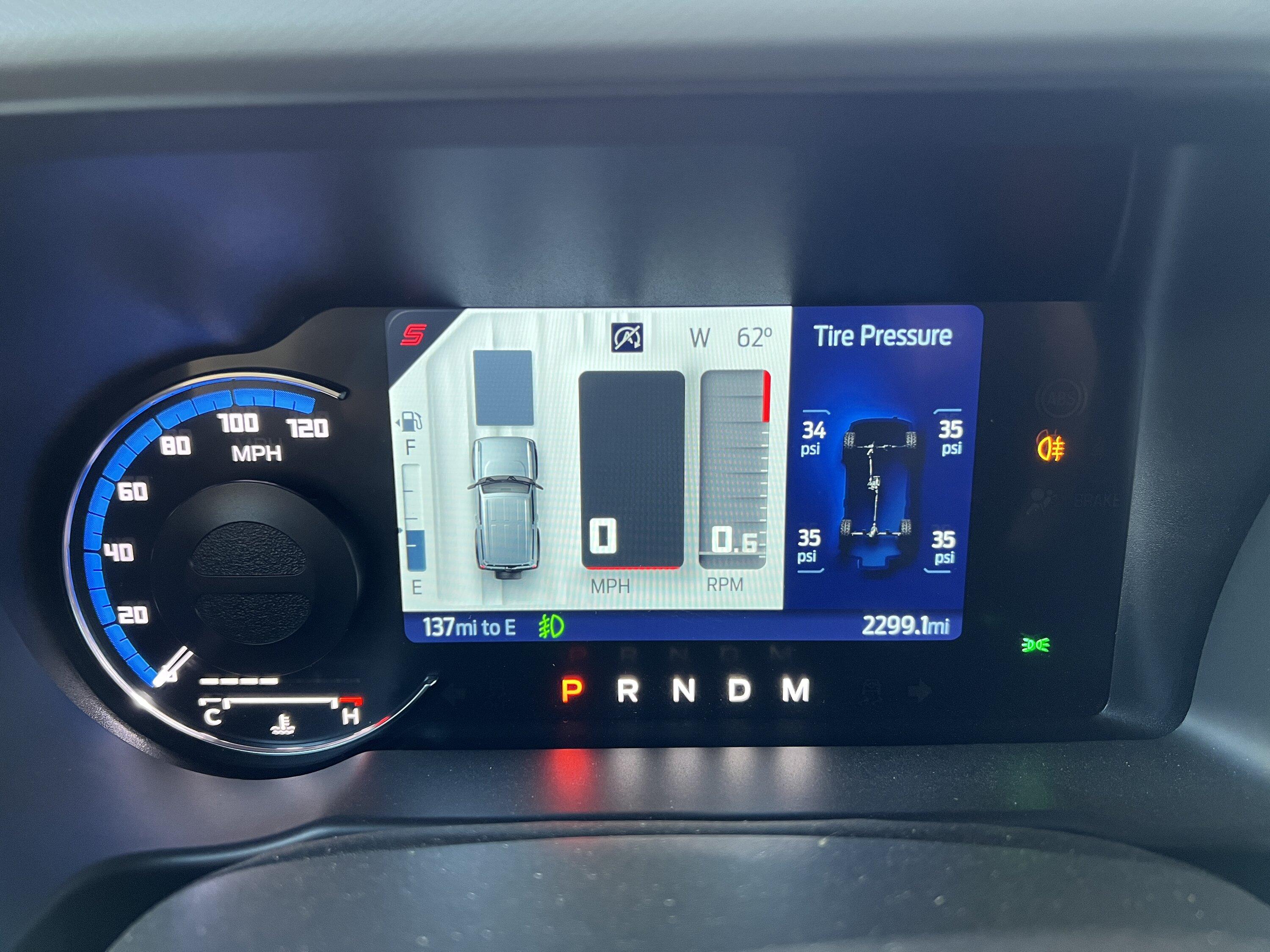

This makes no sense and let me explain what was happening.
I always have my headlights in "auto" mode, and when it is dark enough and when the conditions are foggy enough, I want to be able to turn on my fogs (which I can do)
In this instance, my lights were not turning on automatically because it must have not been dark enough for the Bronco sensors to turn on the headlights. But because the headlights were not on (via the automatic sensor), I could not turn on the fogs. I had to turn the light switch to literally any other position to turn on the fogs. If I can turn on my fogs with ANY OTHER SWITCH SETTING, I should be able to do it when in "auto" mode.
I my 2004 BMW, I can turn on my fogs at any time with any headlight setting (automatic or otherwise). Makes no sense to "disable" fog lights ever (unless the high beams are on)
I understood what you were saying. But it’s still unnecessary. I see no reason to need fog lights on without your headlights on, which is why it’s not possible on the bronco or most other vehicles.
All I’m saying is if it was not dark out, but foggy enough to need fog lights, then you already should’ve already manually turned on your headlights, which would in turn allow your fog lights to work 🤷‍♂️

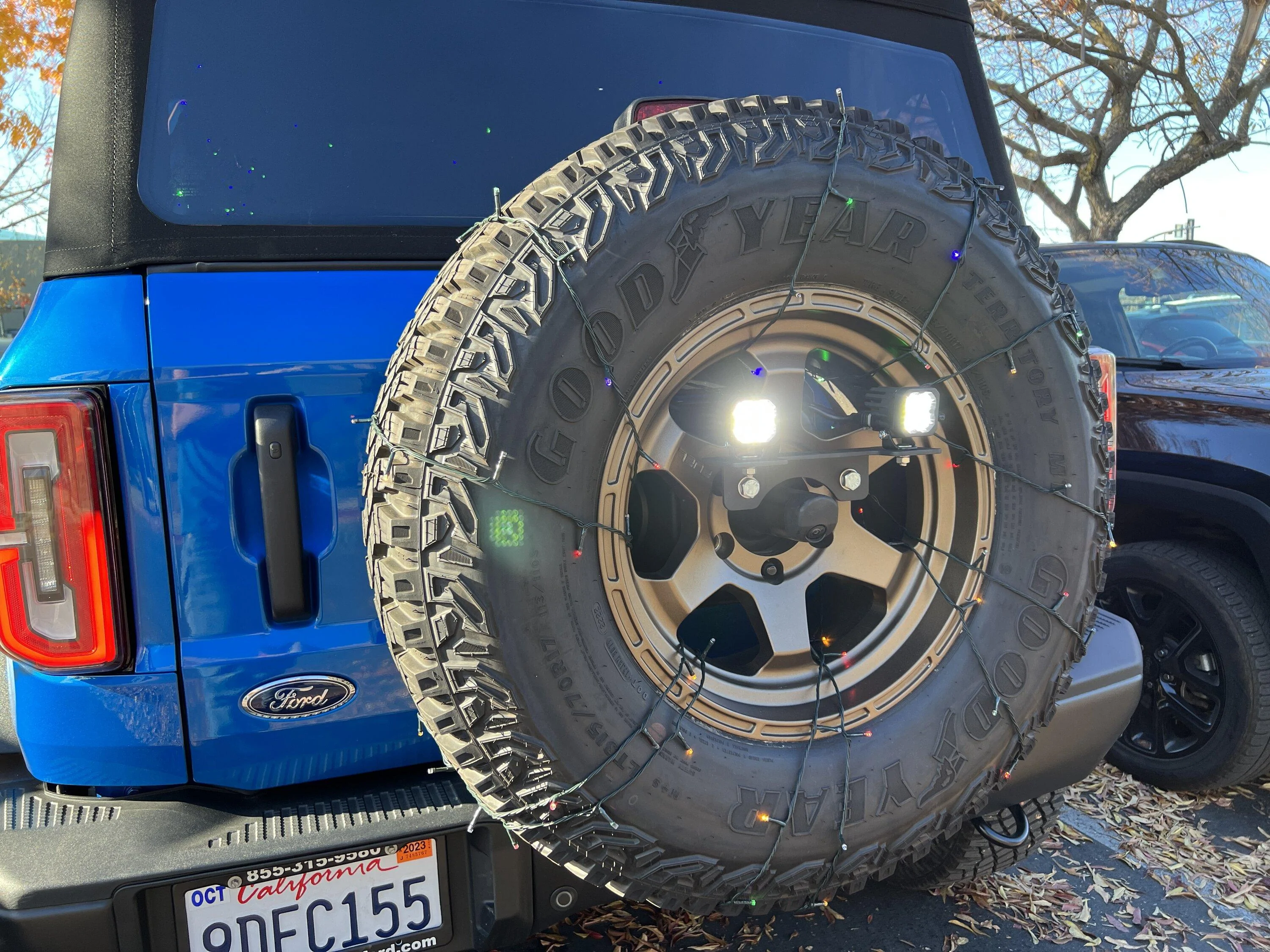

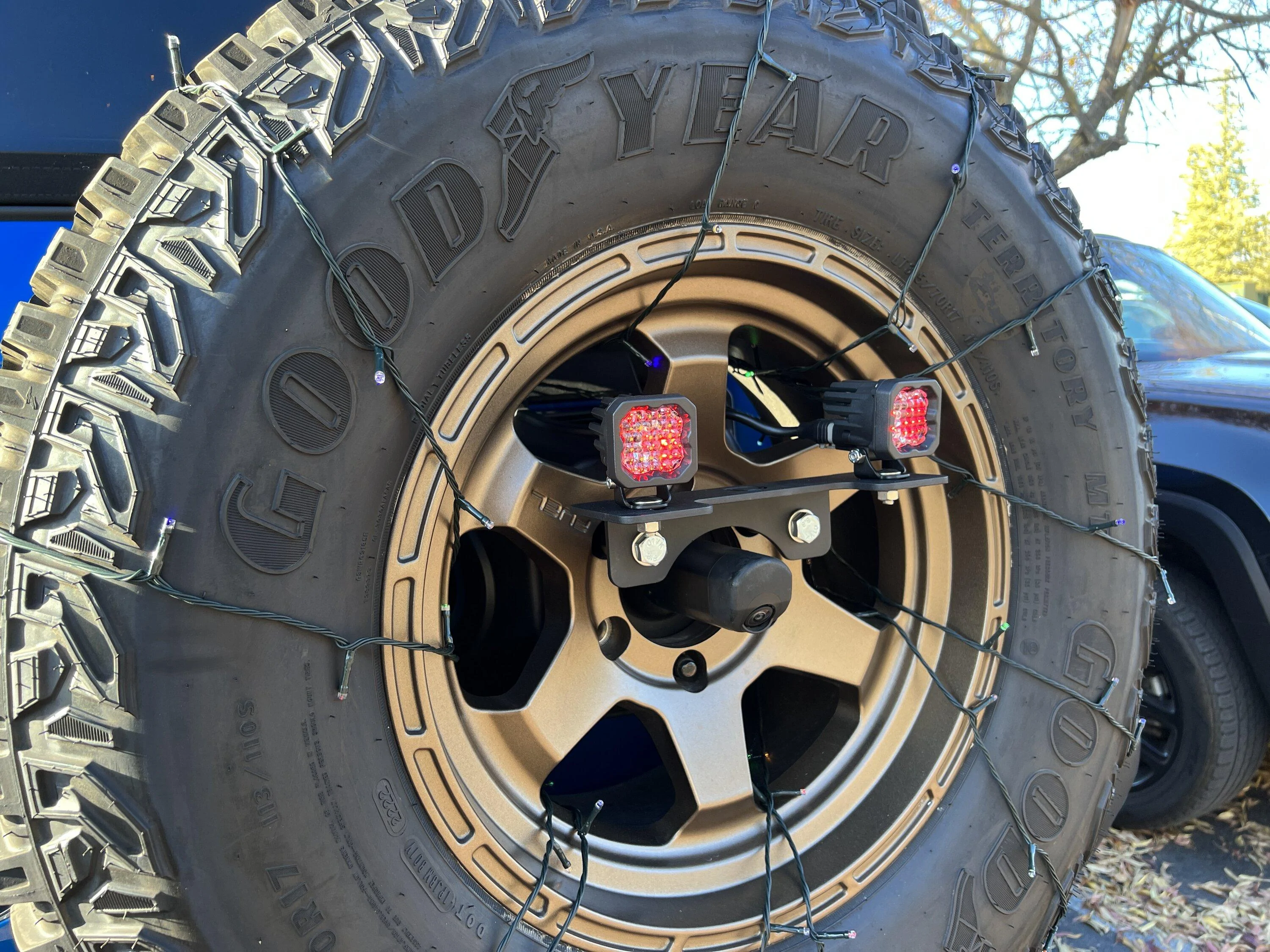

Finally. Done. Got the front fog light switch going to a pair of amber lights in the front. I added the diode dynamic reverse pod bracket with ssc1 pros. The wiring ties into factory tail/brake reverse lights so when my headlight are on, the red backlight is on low. When I hit brakes, the red gets brighter. When I put it in reverse, the white comes on in full power (zone lighting also turns them on). The kicker is that there’s a separate trigger input to turn on the white lights without being in reverse. I tapped into the white/blue wire in the door sill and ran that to the trigger wire. So I can turn on the white lights without being in reverse by hitting the rear fog light button. And the front/rear fog light icons on the dash work as expected.

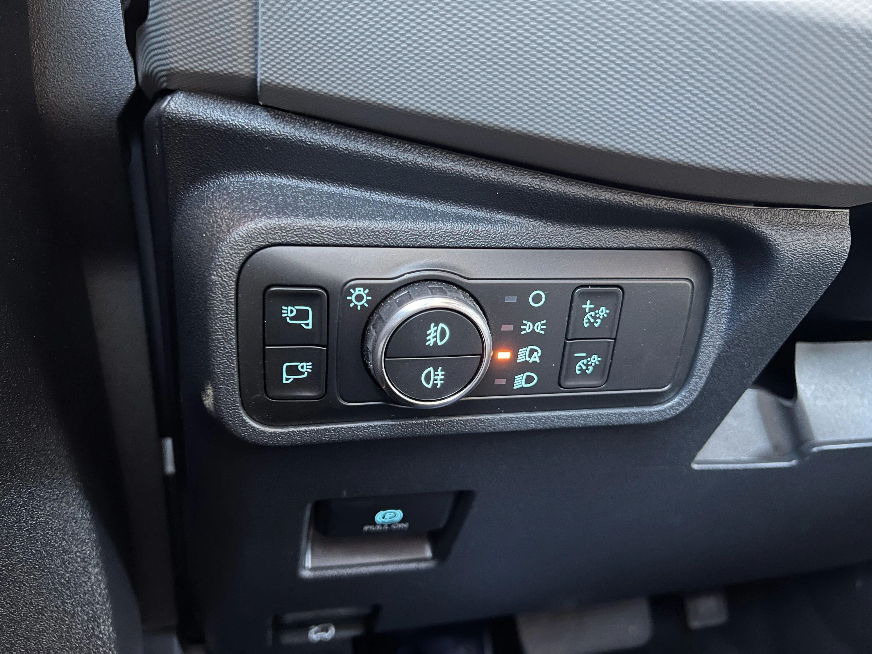

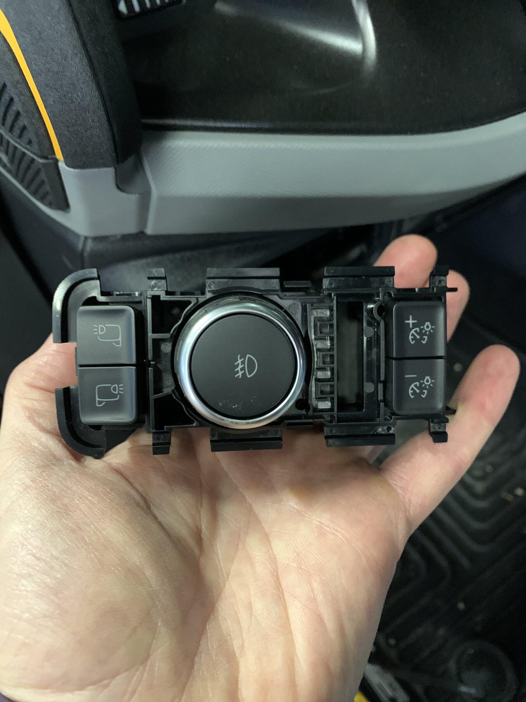

any tricks to remove the factory headlight switch to swap in the one with fog lights and not break anything?
About the 50 second mark. The switch is easy to get out.

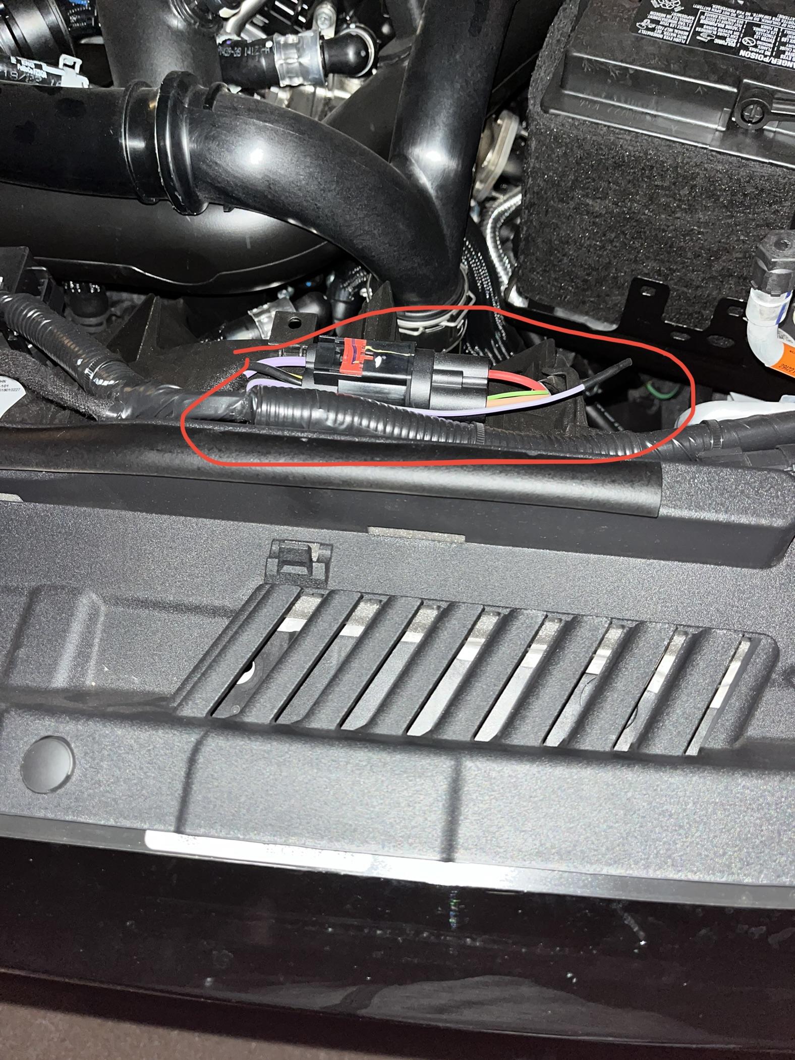

That purple wire above grill is not one of your Aux wires, it is a pre-run wire that should terminate near your Aux wires in engine bay (back right). You will see a few other wires bundled together that also run to different areas of the vehicle. This set of wires are covered in the owners manual, they are not powered but can be linked to an Aux switch wire for power. Without the OEM fog wiring I’m not sure how you would manually wire fogs from the factory switch with fog option (that’s well above my pay grade!!)

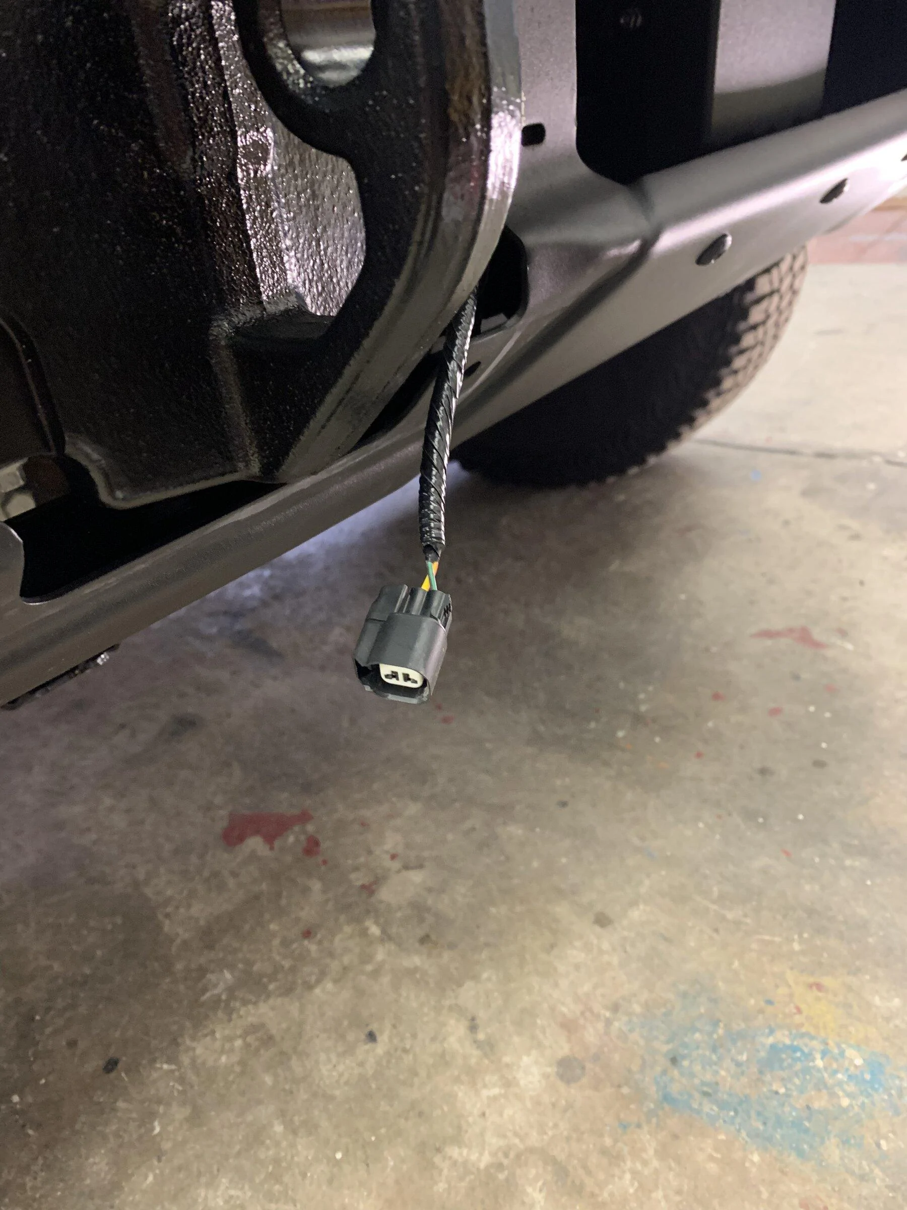

Ok guys, I hava badlands squatch Lux so I have the wiring harness for front fogs I am assuming that is what this photo shows. I replaced my factory headlight switch to one that includes fog light button which entailed ordering one of the switches that is in stock without the puddle lights and taking the puddle light module from original and adding it to switch with fog light (as someone else her showed us could be done). Puddle lights are working with the new switch for what it is worth. Next I went in to forscan and changed the BdyCM and IPC as instructed here to activate switch which included changing Some people f the coding in the BdyCM as built configuration. I am getting the fog light indicator to show up on the display but I am not getting any power to the plug. Has Anyone else run in to this problem? I am in my shop with no access to a computer. I can check forscan when I get back home but thought I would ask for any other ideas first. You should know I have 0 experience with electrical wiring or forescan. I would not have even attempted to do the fog light switch/ forrscan changes if not for this forum. So thanks in advance for any help
Does Anyone know if the for this harness if Red/ Black should go to green or Yellow. yting to figure out which side of the two pin connector is Ground and which side is power. any input would be helpful so I can get this correct the first time I try it.
Black with green is ground on the factory harness.
Brown is power for the left side and yellow with orange is power for the right side.
