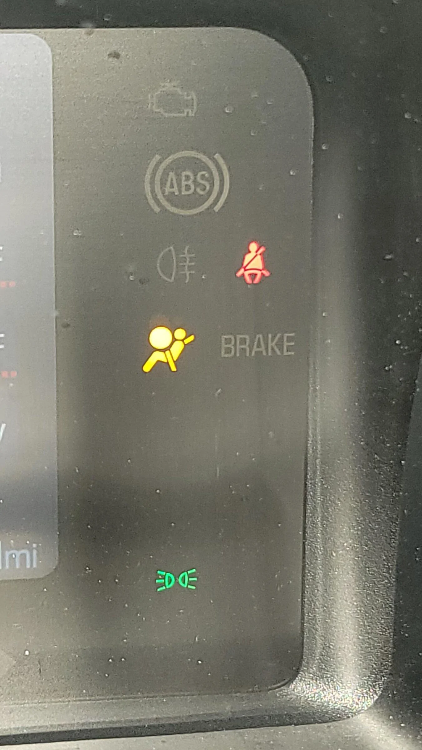

I'll try this, but I think the system runs a self check and checks the resistance in the micro switches in the seat belts....once the switches are removed then I get a restrains with seat belt and airbags in icon warning light, this is different than the "put your seat belt on "light.
It's the yellow one I'm trying to omit.
