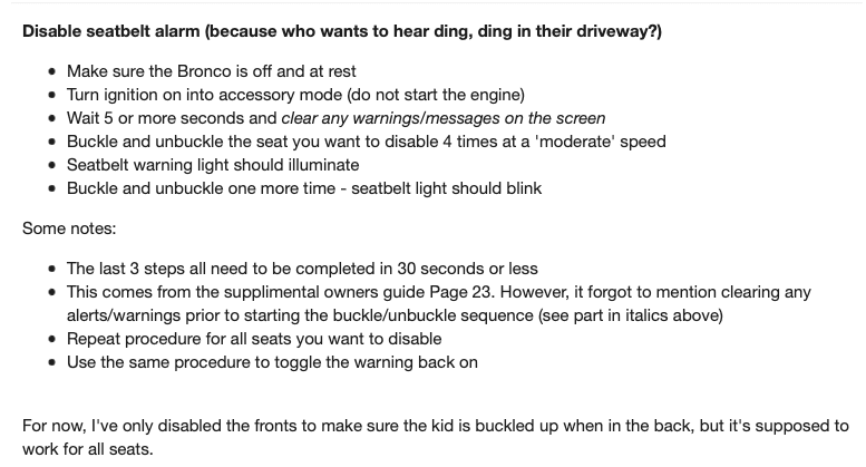

Well this is interesting as I'm trying to turn OFF the rear seat belts ...due to my U-14 conversion I no longer need rear seat belt switches or sensors and without those parts, the idiot light stays on. I do still want the restaints indicator light to be able to work on the front.
Wonder if the as built off a 2dr F-150 would have the correct number of seat belts?
See if this would work for you.
https://www.bronco6g.com/forum/threads/how-to-disable-the-seatbelt-chime-less-than-2-minutes.42934/

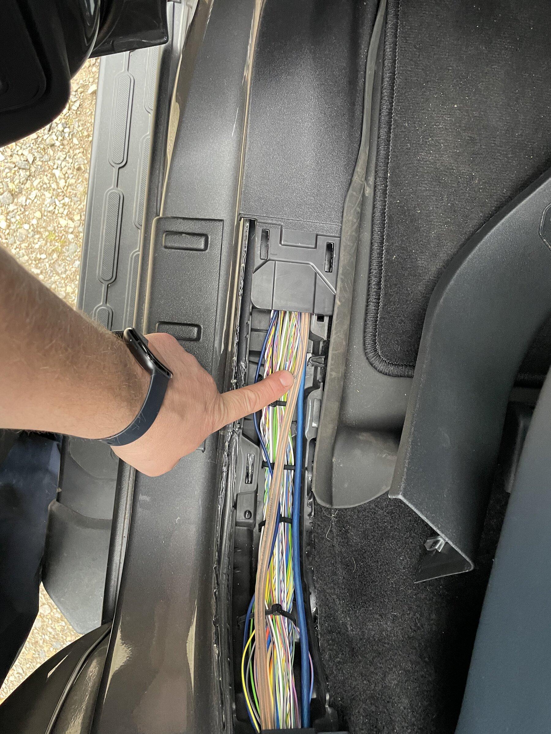

To the white/blue wire that runs to the back of the car. This wire runs down the drivers side sill under all trim. I actually grabbed it under the sill trim in the rear drivers doorway. This gave me enough wire to run it out under the hood. It’s all in this thread a big thanks to @flip for the diagrams he posted. They are live and working. Now to find out where the drl/turn signal wires are as the lights I bought have amber as well. And I want to hook them to either the turn signals , drl or both as it’s not a real bright amber.

My situation is: I have already installed a rear fog light and it’s connected to one of the auxiliary switches… Now I’m waiting for my new switch to arrive in order to modify the connections. So, if I got it right, I just need to link the rear fog wire to the white/blue wire in order to make it work with the rear fog button.?
This came from another thread. I did this for the driver seat but its supposed to work for all seats. Give it a shot
Ford Bronco Factory Fog Light Switch Screen Shot 2022-04-27 at 1.30.05 PM.PNG
In your case I would trace the wire all the way back. You do have to enable it in forscan.
