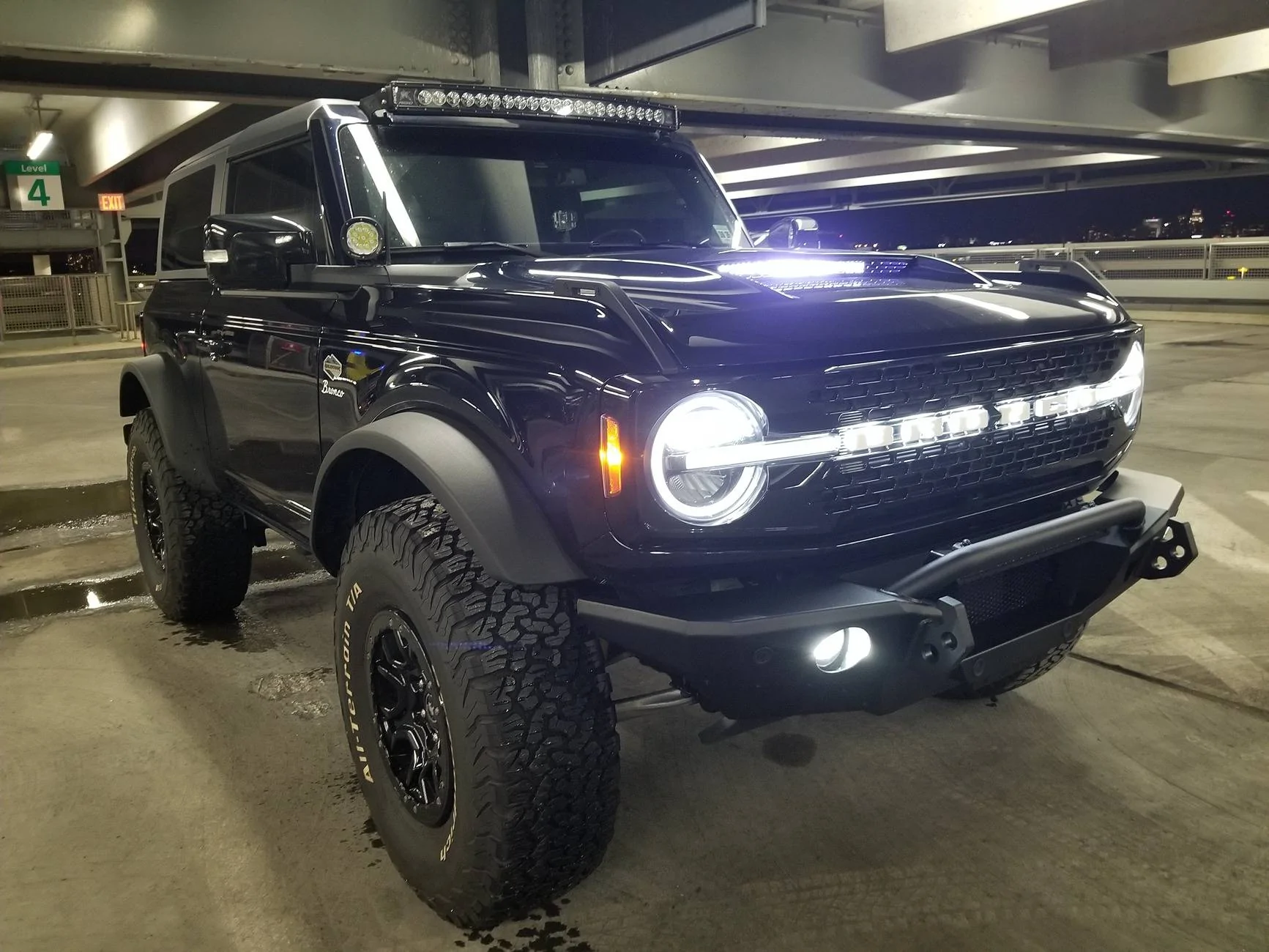

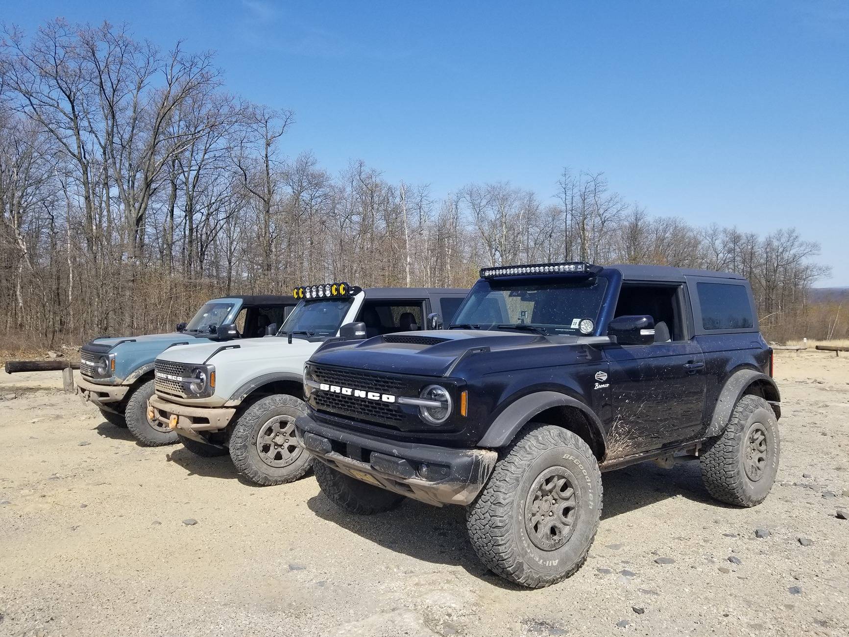

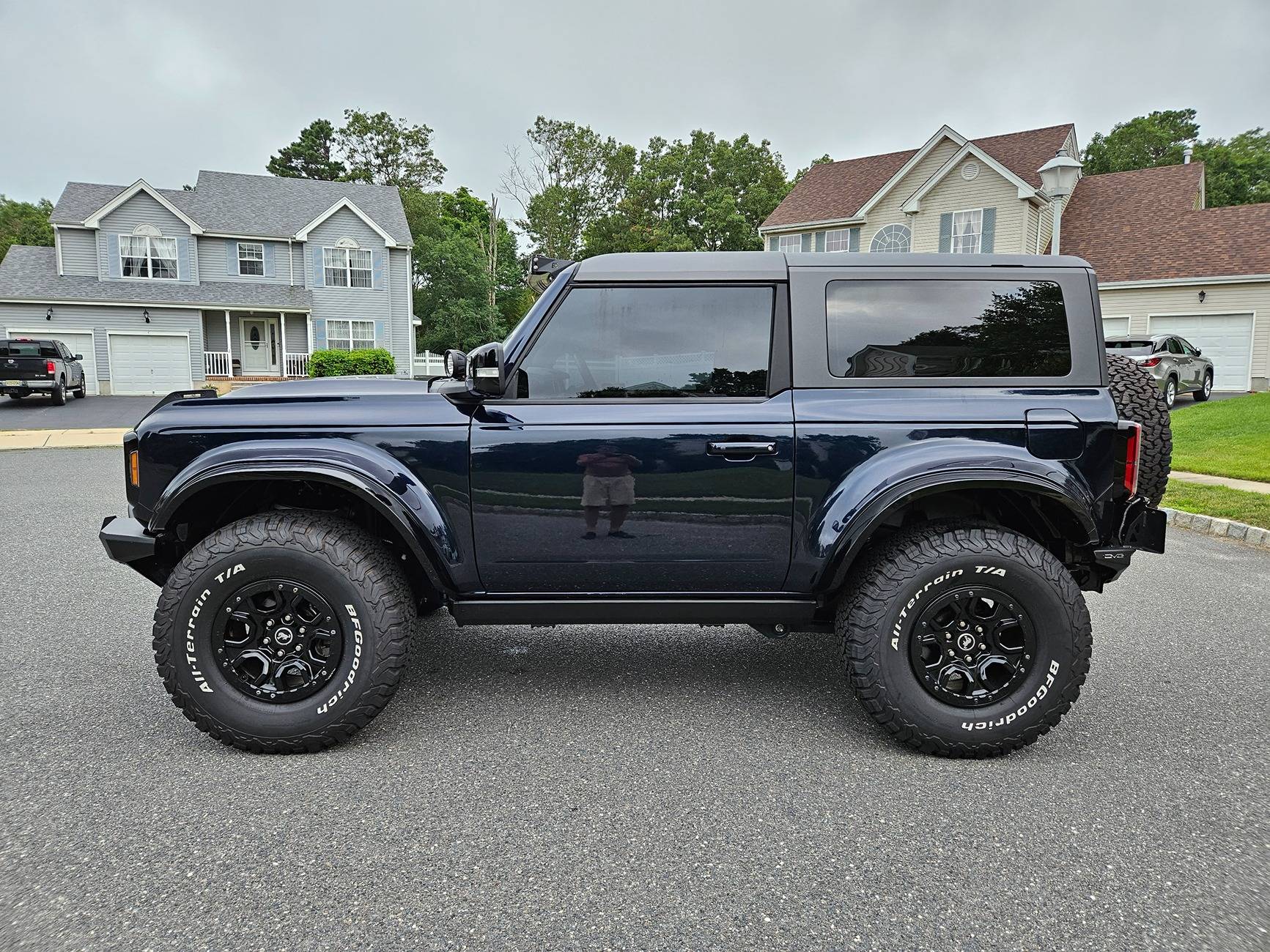

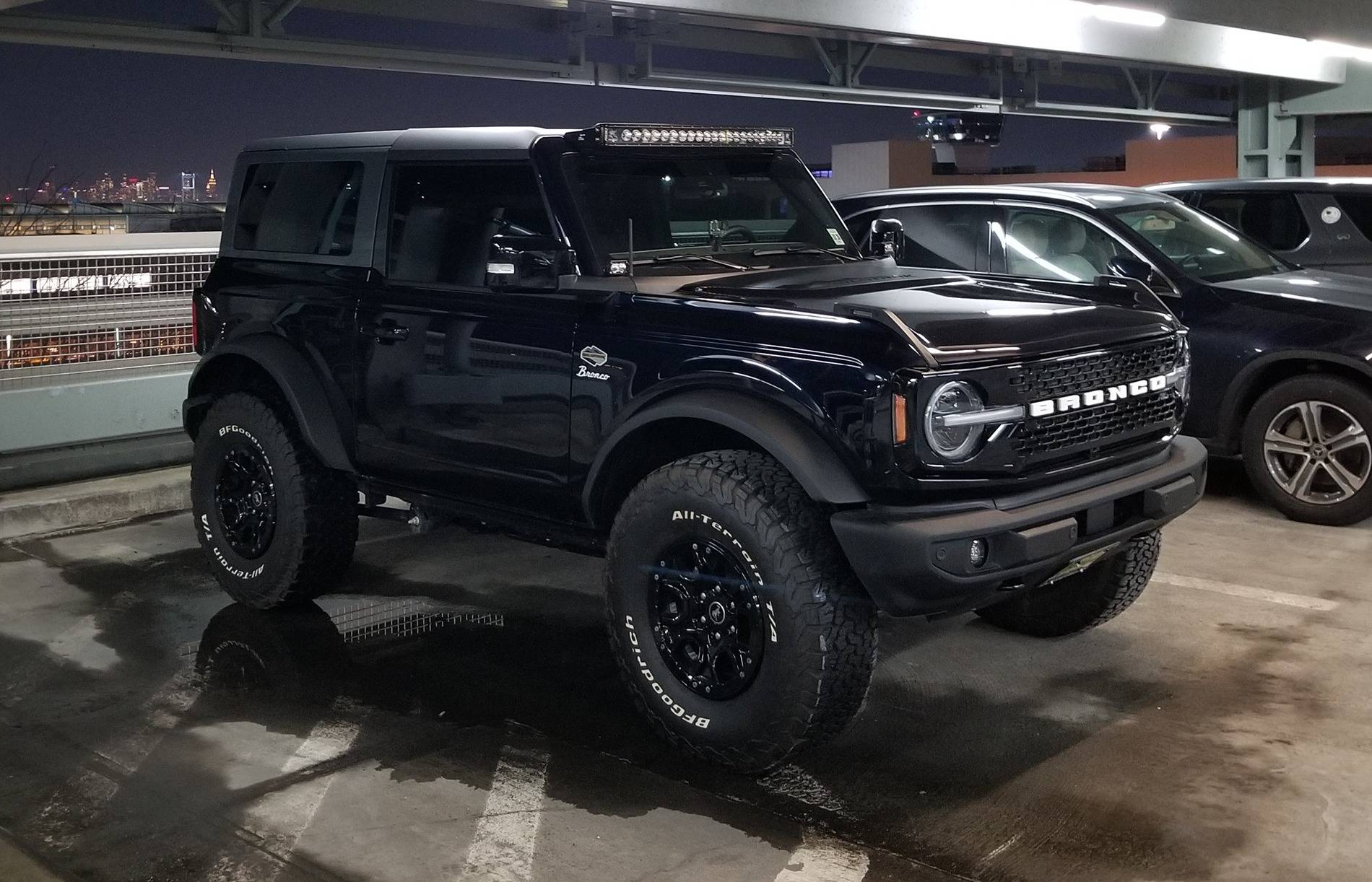

Here are some older pics from before I went to AFC fenders.
Fyi, i just installed a long travel kit with Fox 2.5 coilovers and set them to factory ride height. They are adjustable to 3.5" of lift.
In short, the WT is the same height now as the pics below.
Ford Bronco Eibach vs 4WP for 37's 20221002_191711
Ford Bronco Eibach vs 4WP for 37's 20220430_153049
Ford Bronco Eibach vs 4WP for 37's 20230715_194926
Ford Bronco Eibach vs 4WP for 37's 20220208_185831

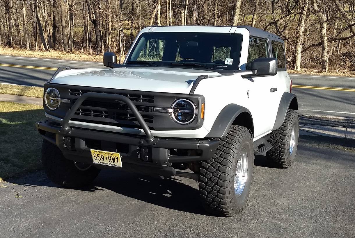

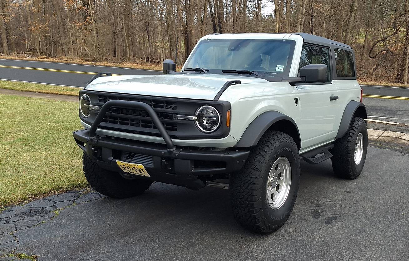

My wheels are 17x9 with -6 offset (so -12 would stick out another 1/4") with the 37x12.5x17 BFG KO2's, they aren't raised white letters though.
Ford Bronco Eibach vs 4WP for 37's mybronco_37stock13
The poke was more obvious with the 35x12.5x17 BFG KM3 tires I had previously. The KO2's have more of a rounded shoulder vs the KM3 which is more square. The 35's were E rated and weigh almost 10 lbs more than the 37's which are C rated.
