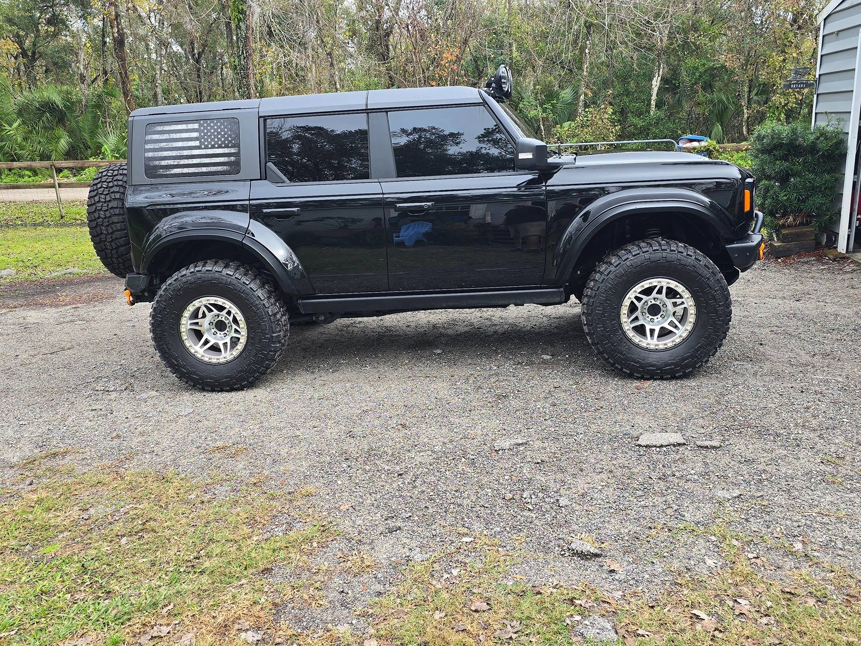

Did you look into the 4WP as well? Seems like the pkg with the UCA's are around $1200
I looked at them , but did not get a warm fuzzy feeling from my local 4wp . So i passed . I have made several changes over the last few months , with more coming . I started with a Badlands with SAS , and still modifying/changing to make my Bronco mine . I suffer from a Bad case of Fuckwithititus ..

Been running the Eibach coilovers and 37's for about a year now . Yes I would suggest UCA's at time of install . Yes the ride Great , no i have never felt any fade or issues running 37's . Am I saying they are the Best , for the price point I would say they are hard to beat .

So you were running the 37” BFG’s on OEM wheels without spacers? I have seen so many mixed answers to this it’s hard to know. I have a BAD SAS with Zone UCA’s and Eibach Pro Coilovers. Wanting to either get BFG’s or Coopers in 37”’s.
[/QUOTE]
Hey, not sure what the actual size the Coopers are. The K02s are 36.5" that's why there were no issues. Later I cut the crash bars bcuz I got tired of seeing them n added the max clearance kit to box it in.
Others that ran something other than the K02s had some rubbing issues. Do a search here n you can find what they did....
The Max clearance kit should be there answer, just not 100% sure.
[/QUOTE]
Thank you! I will look into the max clearance kit. When searching most people went with the max clearance kit but others also mentioned running spacers on OEM wheels and I am not a fan of spacers. The Coopers and KO2’s are very close in size. Also the particular set of KO2’s I am looking at are the C rating so not much added weight. The Coopers that are only slightly bigger are D rated and a few pounds heavier. I just really like the OEM wheels but with the Eibach pro on the SAS feel like there is too much gap. I also need new tires so was either going to go bigger or stay with 35’s and lower the coilovers.

Just grabbed eibach coils and 37 ko2s after I read what you said, you didn’t have any problems off-roading at higher speeds and doing moderate crawling on difficult terrain with stock wildtrak wheels??
Hey,
All has been good since day one, no issues with that set up.
