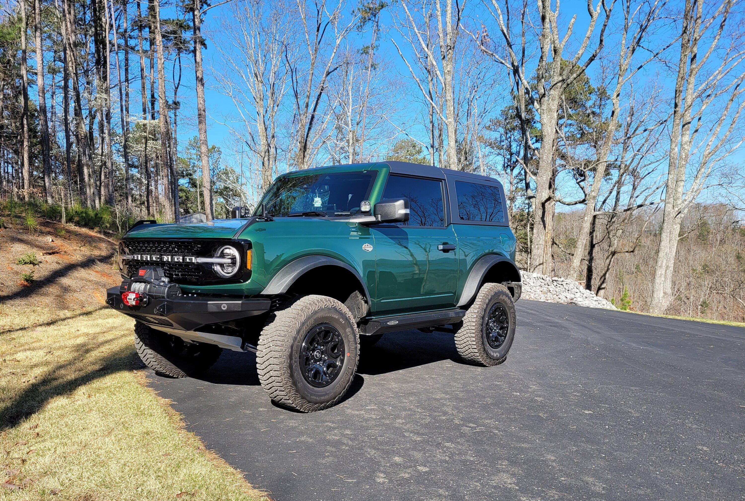

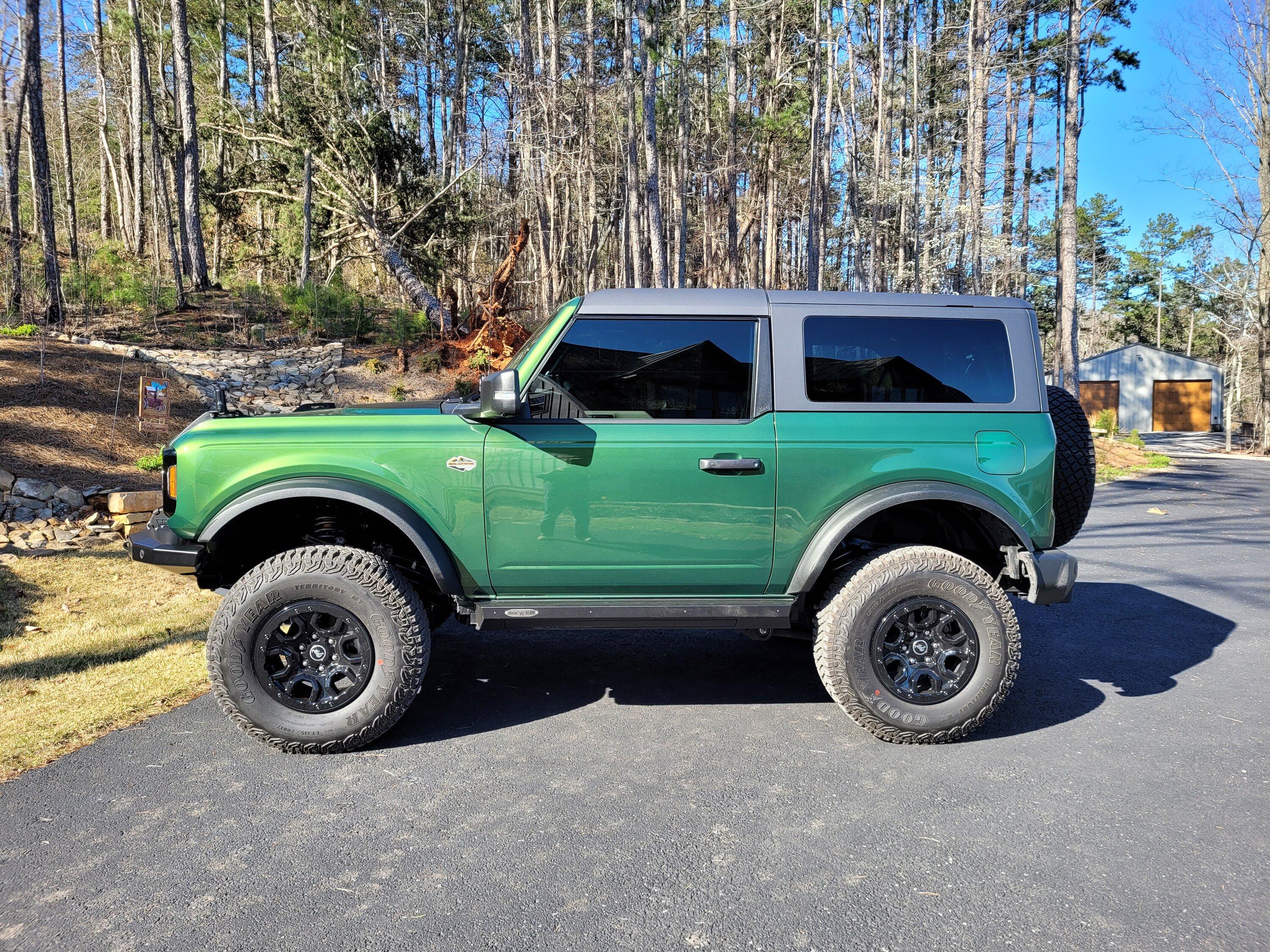

Finished up my install today. It took me 2.5 days to do it by myself - would have been easier with a 2 post lift and a helper. Not gonna lie it was a PITA! I used my QuickJack, which is great, but the up and down is hard on the old bod. I've always done the suspension work on all my previous rigs - it's a great way to learn the vehicle, but if there's a next time it's going to a shop. I'm not as good as I once was... getting old sucks! I spent way too much time with the bolts on the top hats. If I could meet the Eibach engineer that decided using bolts instead of studs was a good idea, I'd kick him in the butt - maybe even the balls. :ROFLMAO: It's close, but I might need to make a few height adjustments...
Now off for an alignment and install my 37s. (y)
EDIT: I am using the heavy spring weight coils in the front due to the extra weight of the bumper and winch. The front end dropped nearly an inch with the HOSS 3. 0 Fox's. I jumped on the bumper and the Eibachs hardly moved - hopefully it won't be too stiff. The test ride around the block felt pretty good...
