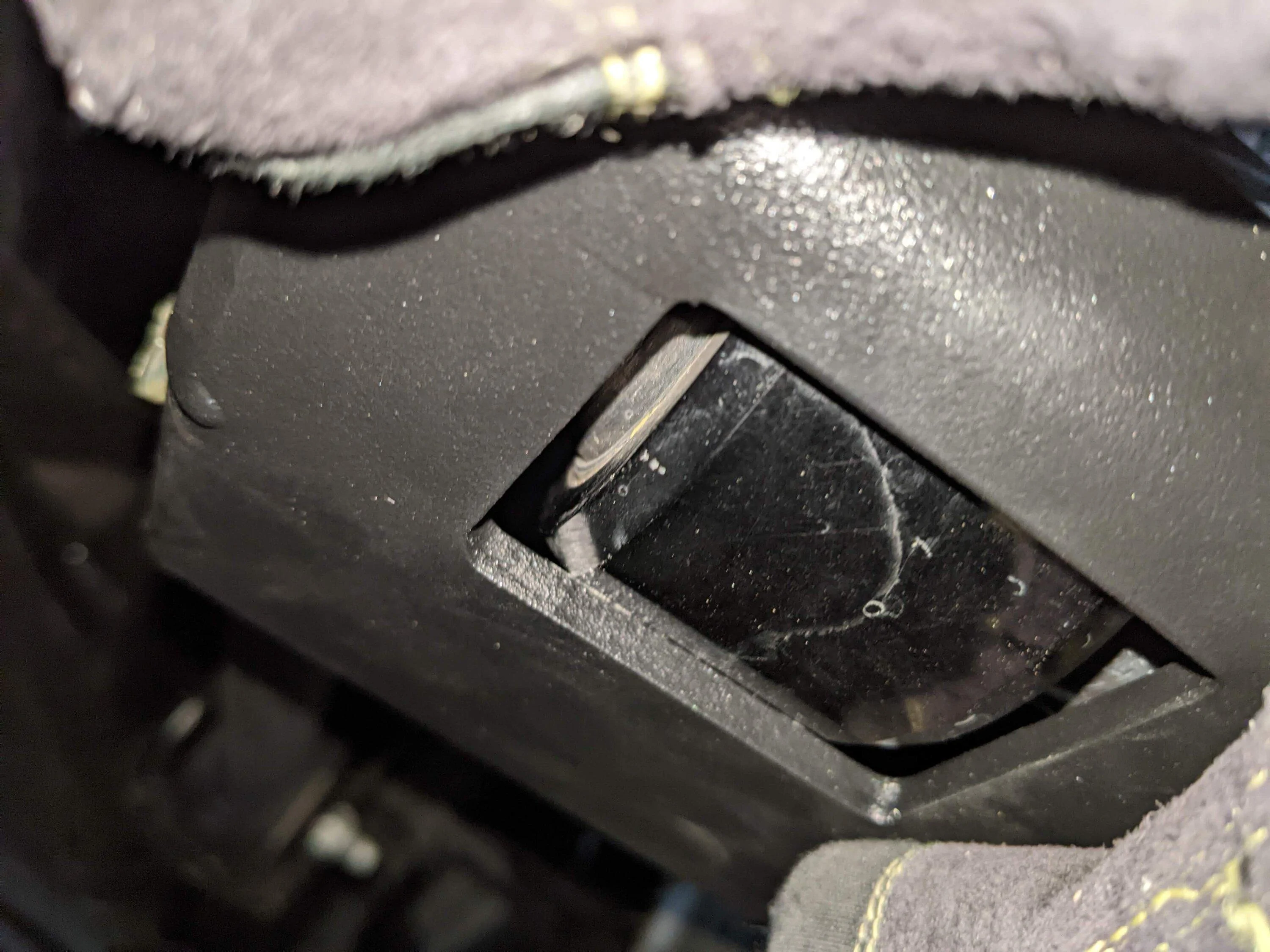

Yeah, I'm really disappointed as the price is great and the installation method (not having to remove strut bolt/nut) was preferred.
Here's a photo of where they rub, and this is with nearly a 1/4" space remaining between the skid plate and the strut mount tab on the outboard side that it attaches to:

File or grind that area of the skid down where it’s rubbing, re-paint and re-install. Not a big deal. Looks like you just need to open up the opening more.

Yeah, I suggest to drill holes on the corners, about 1/2" forward and 1/2" aft of the trim out to establish the corner radii and then cut the metal in between with a Dremel metal cutting disk and follow up with a grinder bit to smooth it out.
I'm already at 1/2" larger cut out (1/4" forward and aft) and still need to trim more. Thought it would have been more than enough but I misjudged.
I'll eventually get to it. Just need to find the time. It's just kind of a pain to work with because it's too small of an area to use my angle grinder on. I only have so much patience with a Dremel on steel that thick, LOL.
