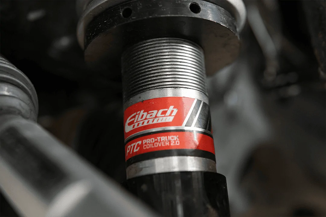

Are the Eibach shock bodies painted or galvanized steel like the Bilstein 5100/6100?
That galvanized coating lasts maybe 2 years max anywhere the roads are salted (from my own personal experience). Eibach's website mentions "Anodized 6061-T6 Billet Aluminum Coilover Mounts" but those are only the black mounts on the bottom. Maybe the bodies are aluminum?

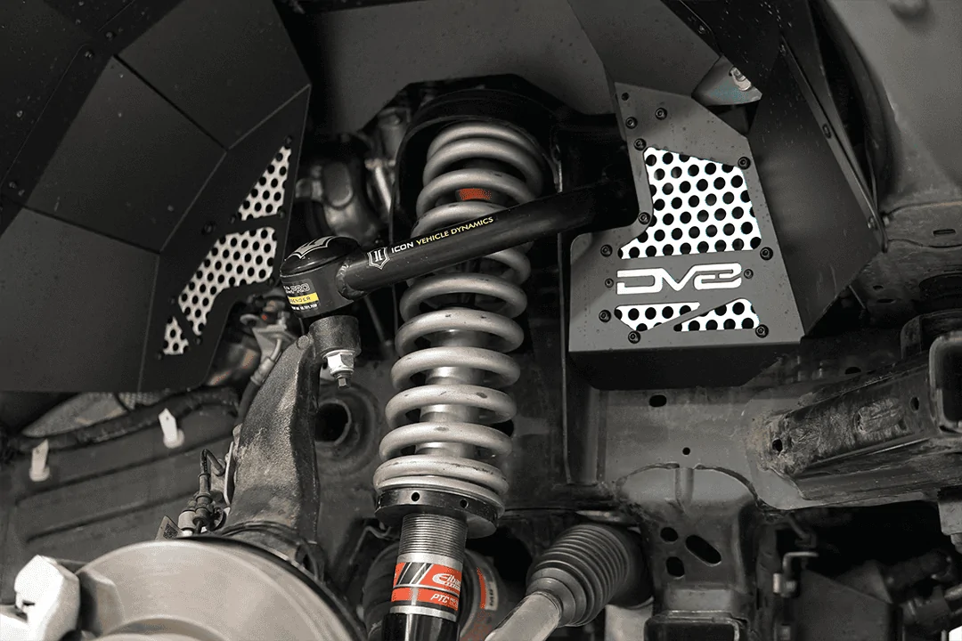

Does anyone with these coilovers have a recomendation on which shock skid plates to install?
I had purchased the Barnes4WD shock skid plates, but they actually interfere with the end of the coilover.
Arokcrwlr
Kraig
Jun 2, 2021
32
887
1,633
US - Alabama
2014 F150, 2014 Focus, 1973 Bronco
Well crap! I haven't installed my coilovers yet, but I have a set of Barnes skids waiting... :mad:
