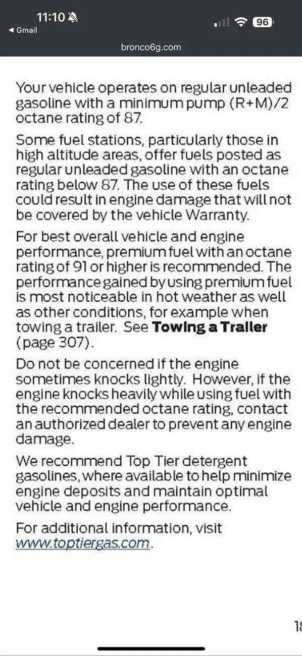

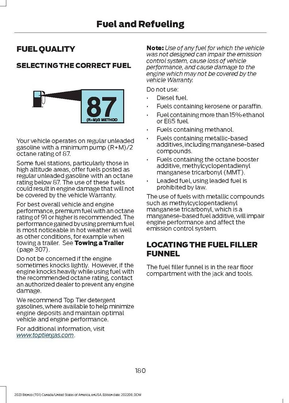

OK....what part of Ford powertrain engineering do you work for again?
That's WAY different than saying that I need to run 93. As for your comment "cheap out," how is that "cheapening out"? There's no damage being done; the truck has plenty of power and torque with 87, so why should I pay for more (assuming there's more to be had in the first place) if I don't need it??
Or did I "cheap out" by not buying a Braptor, for example? By your logic, I "cheapened out" and left power on the table by buying a 2.7. What do you say to those who bought the 2.3?
Ummm....no, it doesn't "want" 93. Not by any stretch.
"Should be"??? I'll follow the manufacturer's documented lead, if you don't mind. No E20 or E30, thank you very much.
I somehow doubt that.
Right back at ya.
Anger issues?
