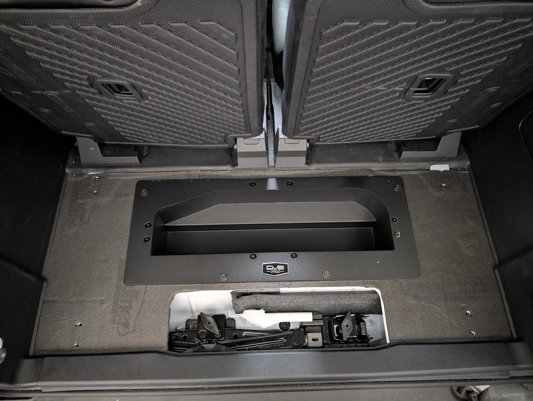

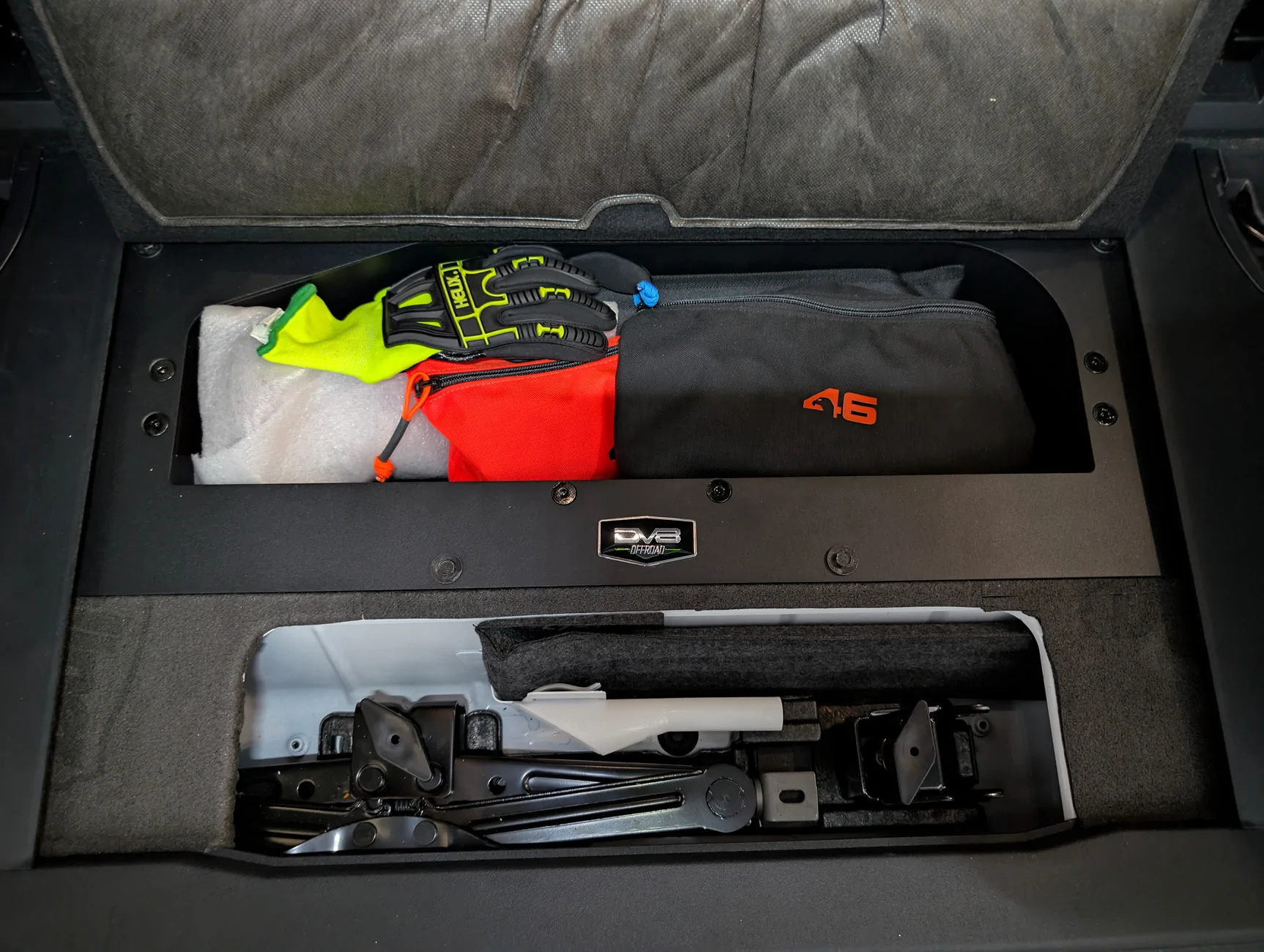

I just installed mine. Have a Borla Touring exhaust so was hoping I could drop it in from above but no dice, muffler is too big. I did not actually have to remove the muffler but did have to loosen the clamp and drop it from the hangers to get enough clearance. Even doing that it's not a hard install but make sure you have a 10 mm ratcheting wrench to get the factory heat shield off. I also installed some Dynamat on the trunk area while I was in there.

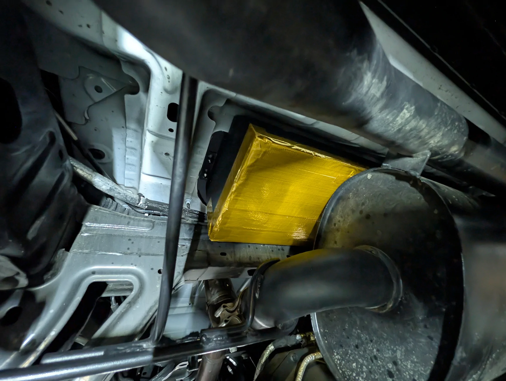

I had read before that there's very little clearance to the muffler. That is true - mine is basically touching. Comes with a heat shield but I went ahead and bought some 800F thermal tape and wrapped the bottom just to be safe. I'll be honest I was a little nervous but did a few long drives and the box is not warm at all. Seems to be fine.
Overall very happy with it. Got it because I lifted my Bronco and needed a bigger jack. Got a safe jack and it was just a little too big for the cubby. Now fits like a glove with tools, a bigger breaker bar, etc.

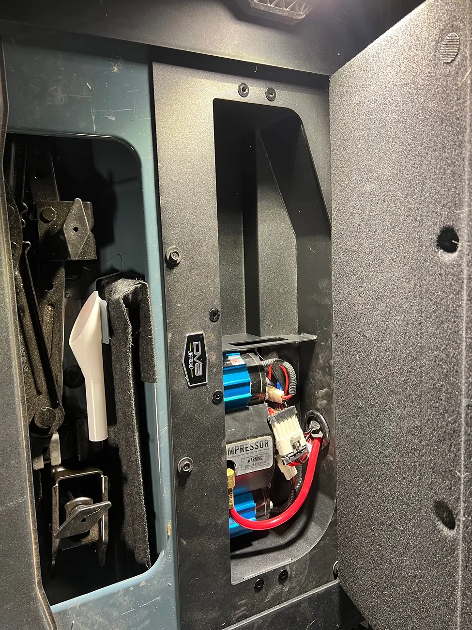

I have it. Storing gear in it currently. May relocate my twin compressor there at some point.
dropped exhaust to do it. Helps to have four hands.

Quick update - mine was touching my muffler on the driver's side and the muffler was starting to mark up the heat tape. Bought an adjustable muffler hanger and was able to drop driver's side about half an inch and that did the trick. You might consider buying a couple of adjustable height hangers just in case - I got four for like $15 on Amazon

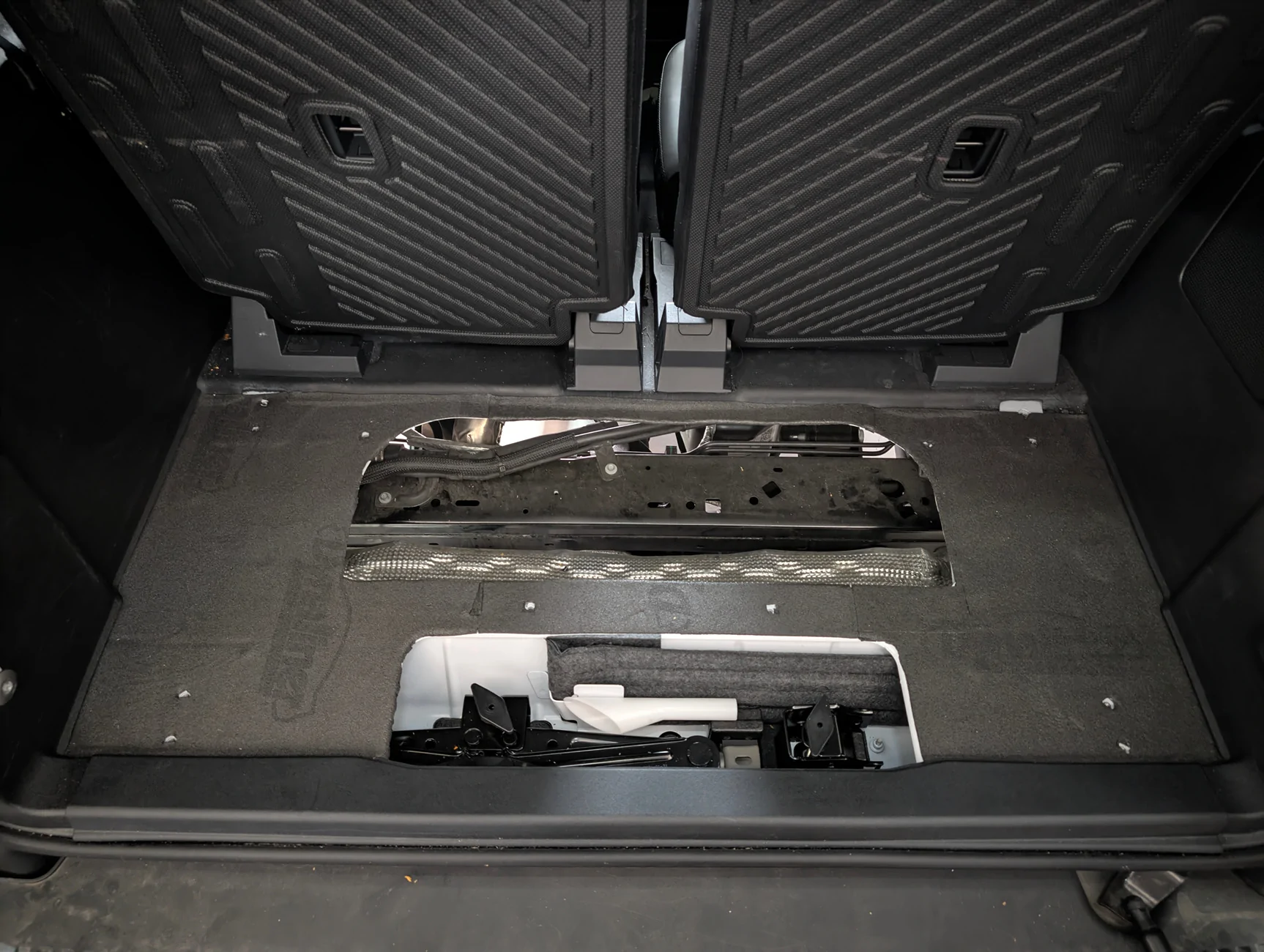

I did the Dynamat Dynaliner at the same time - my son (8) and I did the whole thing in about 2-2.5 hours and that included dropping the muffler. Pics of the Dynamat install below.
