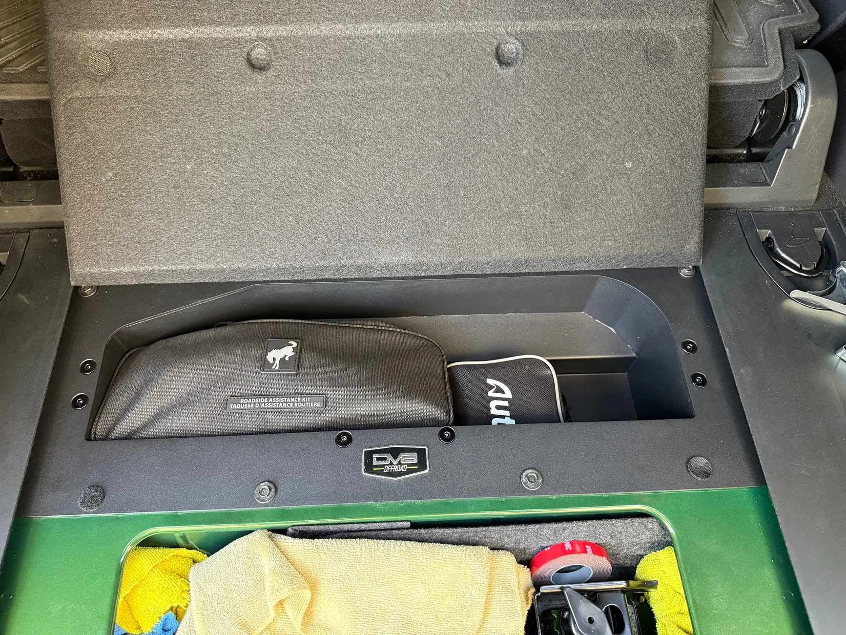

Mine went in super easy. I have the Steeda axle back exhaust so the factory heat shield was very easy to get off. The factory muffler was easy to get off as I remember as well, in case you still have that in place. I had no problem holding the box and top trim panel in place by myself to put the bolts in. The only thing I added was a very thin weather strip around the perimeter as the factory box had. I did not want any water spray to find its way up around the trim panel into the Bronco. Probably not really needed but the factory box was sealed so I added it just in case. It's a very well made box and I got quite a bit of stuff in there. I put a few small things in the jack area also but they could easily go in the DV8 box. It is very loosely packed,
Wow, you are an amazing packer! Even though the DV8 bin is larger, that is still a lot of stuff.

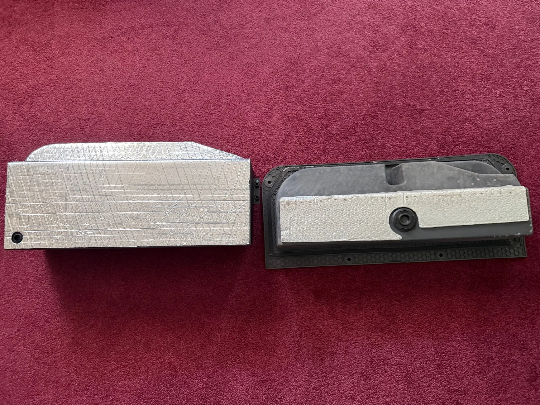

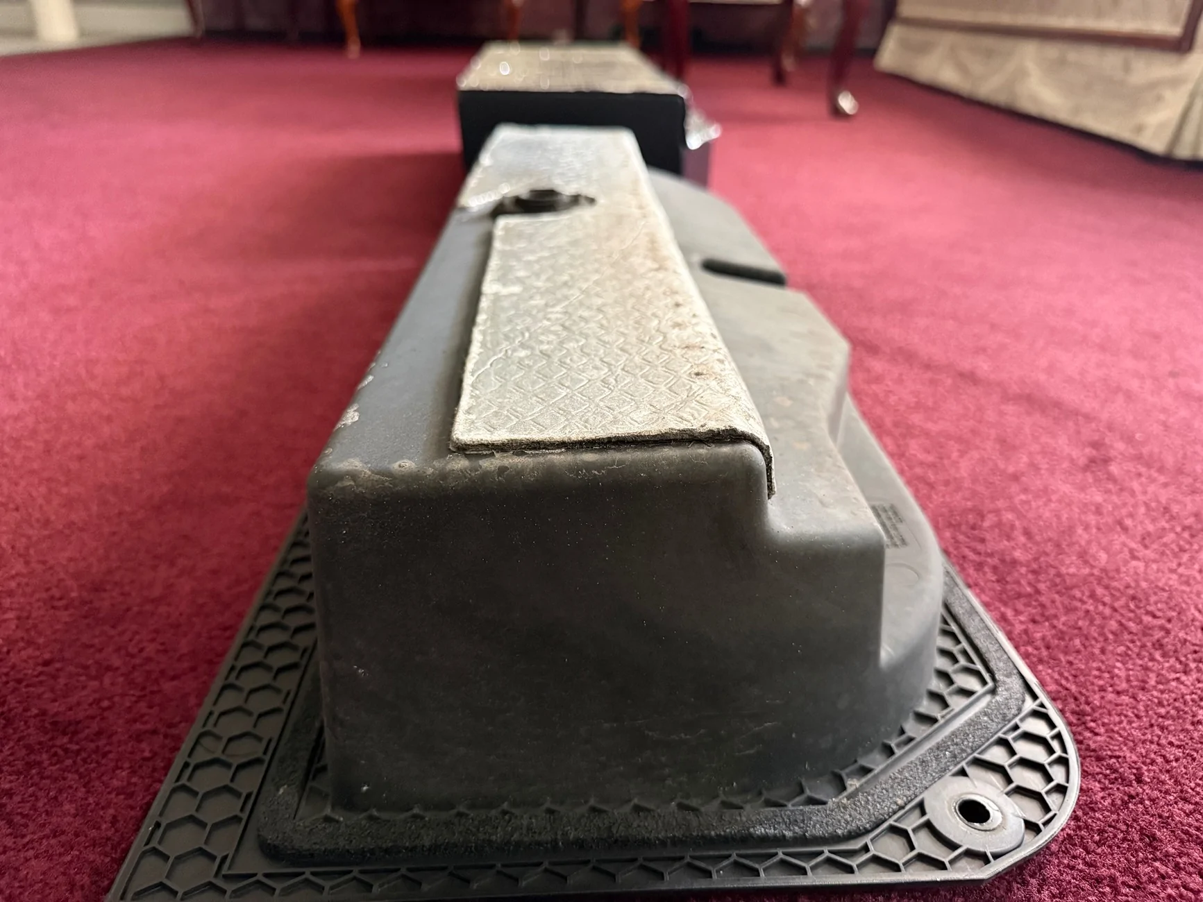

Body lift helped for sure. I was able to remove the heat shield without touching the muffler. I was also able to install it from above. Took me only an hour because of this. I reused the Velcro latches off the old one as well to hold the lid down. Factory unit did have a gasket installed on it…
