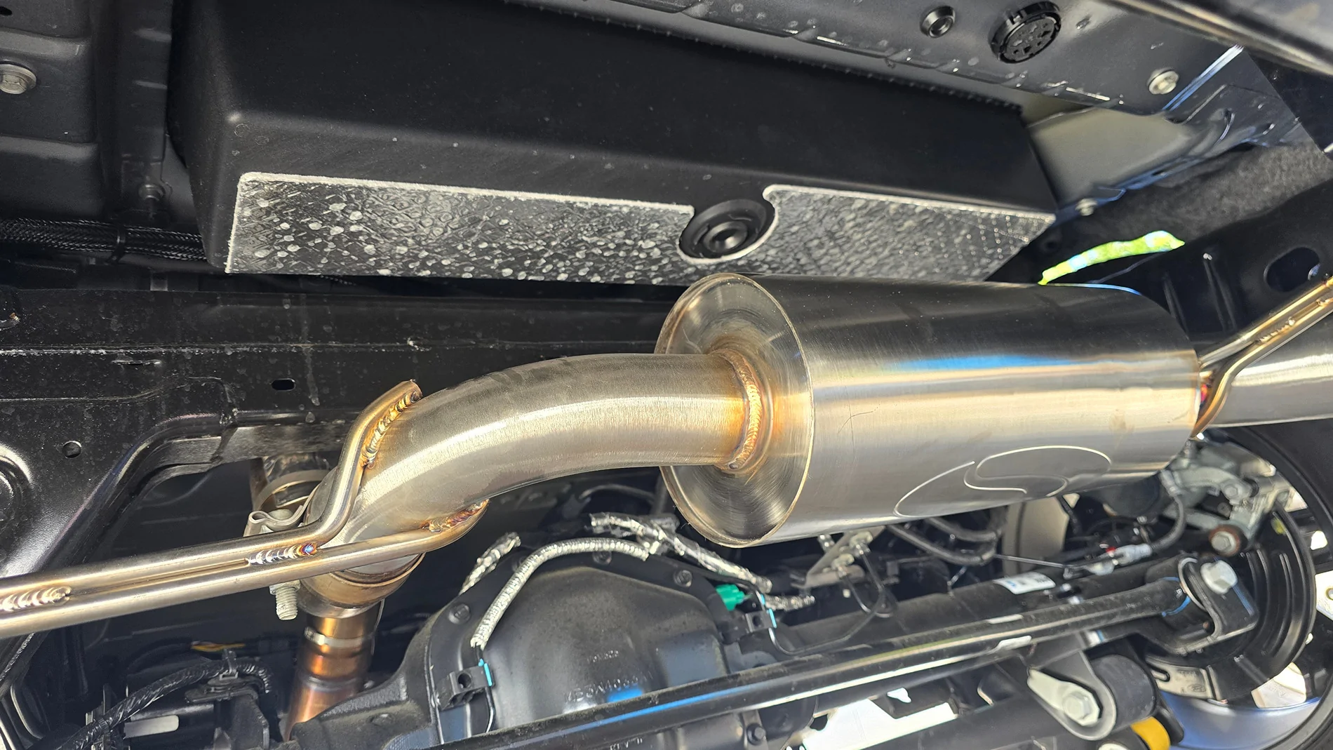

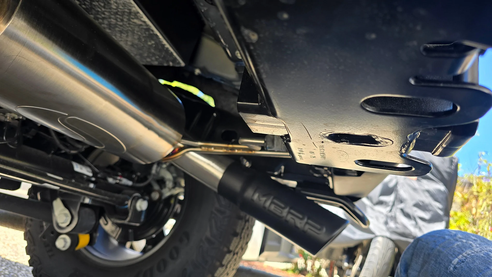

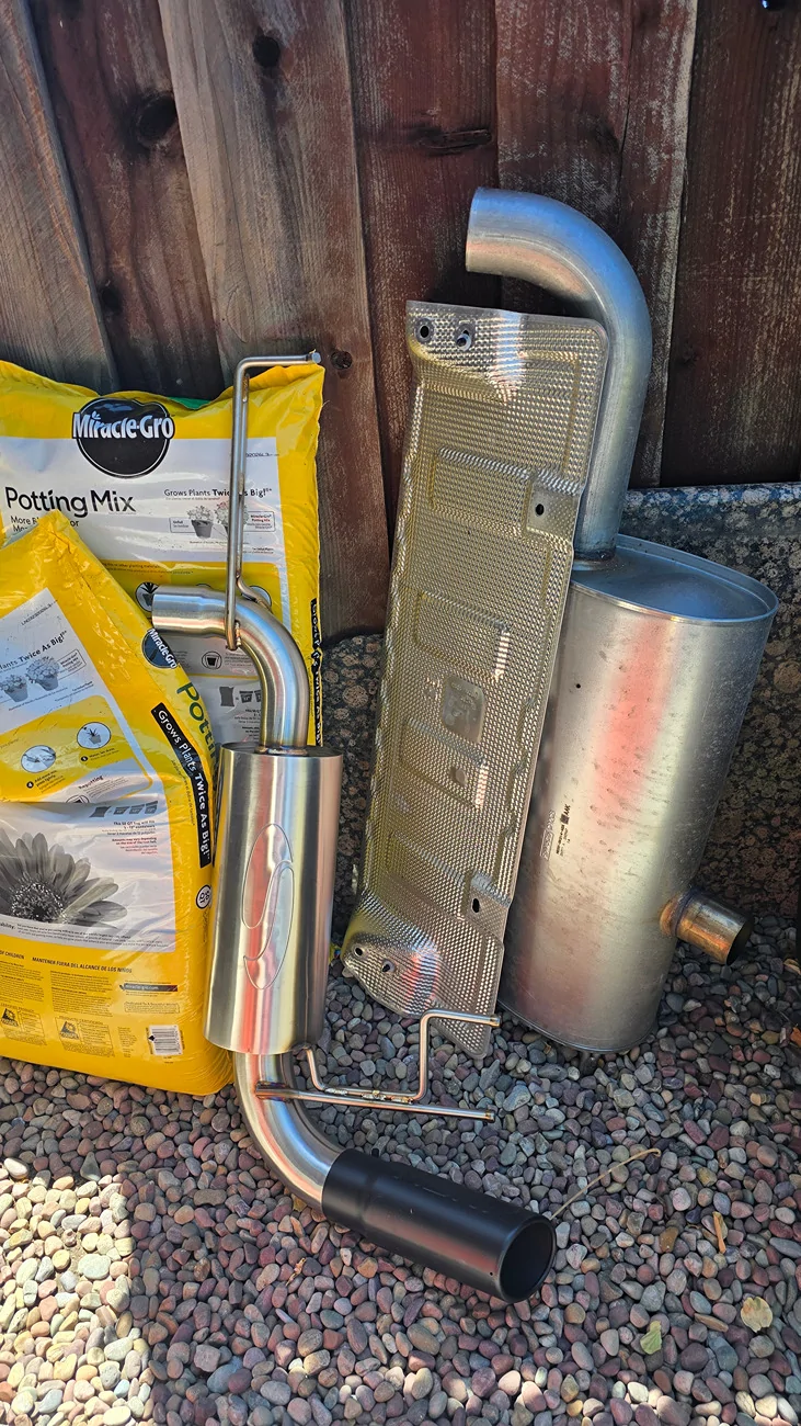

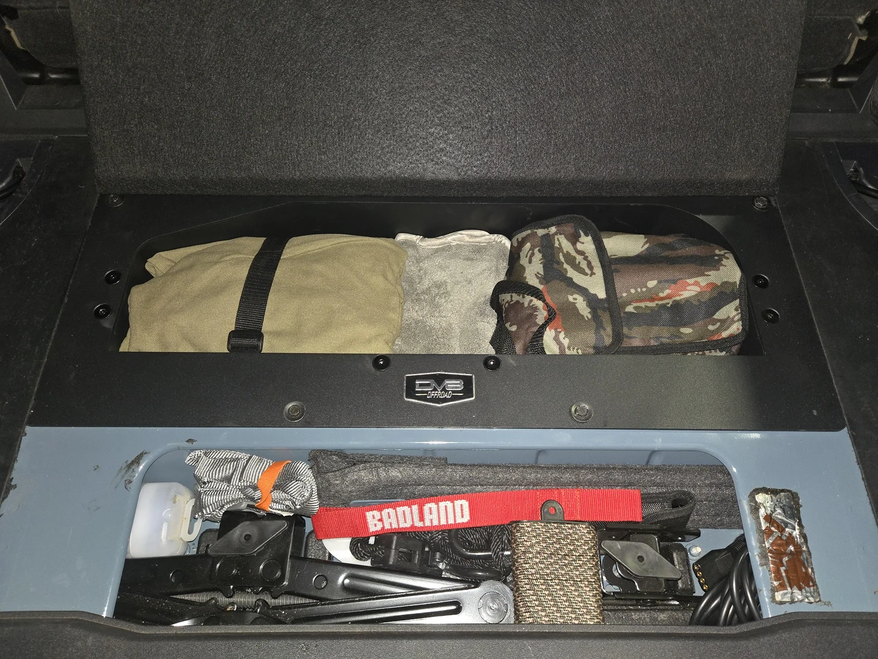

I finally installed mine last week. I also swapped out the stock muffler with a smaller Steeda muffler so I had lots of room between the muffler and the bottom of the storage compartment. I am not worried about heat transfer. I was going to add sound deadening to the Bronco cargo area, but decided to wait since it looks like once it is installed, there is no getting rid of it (way too sticky). I am happy with it. It is definitely bigger than the stock plastic compartment.
Anyway, here are some suggestions I wish DV8 would consider for future products:
a) add a gasket between the storage bin and the support frame and also add a gasket between the support frame and the Bronco metal body to keep out water. I may end up using silicon caulking to achieve the same result but but it will not look pretty.
b) add an optional locking metal lid that attaches to the support frame
c) add an optional light inside so you can see contents without needing a flashlight or other light source
d) add sound/temp insulation pads for storage bin ends, currently they are left without any covering

Please tell me more about the muffler. I'm concerned about that space issue myself. Do you think if you were to do it again that you could make a gasket even though, they should provide it in my opinion. Thanks
I bought it because I hate the fake ESE (Engine Sound Enhancement) which I plan on disabling but I need to get to download Forscan and see if it will work on my old laptop. Anyway, it's tiny compared to the stock muffler which is huge. Here are some photos showing the Steeda vs the OEM muffler (I know they suck):

My Borla muffler is almost the same size as the stock one and it is essentially touching the bottom of the IAG box. As I mentioned in an earlier post I wrapped the bottom of the IAG box in gold flake heat tape, including where it is close/touches. Have had that setup since February and I've inspected a bunch of times - does not appear to be any issues.

That's great! Exactly the information I was looking for. A OBDLink was delivered to my house today so I plan on looking into getting rid of the fake engine sounds when. I get back from travelling. How does the Steeda sound? To be honest, I don't care if I could even hear the engine, so quiter the better for me. Thanks again.
Steeda is louder, with a lower frequency "growl" at idle and is also louder during acceleration, but pretty quiet at steady-state speeds. One quick way to reduce the ESE is to drive in ECO mode. It doesn't eliminate it, but it does tone it down. I can hear a difference. Also since I have a manual, the ECO vs Normal vs Sport is not really reflected in actual performance (vs having shift points change in an Auto).

For those of you that have one, please tell me about it. Ease of installation, etc. I have a ‘23 Big Bend 2 door with stock exhaust.
Cam
Mine went in super easy. I have the Steeda axle back exhaust so the factory heat shield was very easy to get off. The factory muffler was easy to get off as I remember as well, in case you still have that in place. I had no problem holding the box and top trim panel in place by myself to put the bolts in. The only thing I added was a very thin weather strip around the perimeter as the factory box had. I did not want any water spray to find its way up around the trim panel into the Bronco. Probably not really needed but the factory box was sealed so I added it just in case. It's a very well made box and I got quite a bit of stuff in there. I put a few small things in the jack area also but they could easily go in the DV8 box. It is very loosely packed,
With the Borla muffler I had to drop it down (not completely take it off) to have enough clearance but that was not hard and the whole project, including putting some dynamat down in the trunk area around the box took about an hour going at a very slow and deliberate pace. Not hard at all - I had my 7 year old son helping but he got distracted by the time the actual box was going in so I did that part myself.

My DV8 box is basically sitting on the muffler. Box does not get hot. As I posted earlier I put a layer of gold heat tape on the bottom of the box (over DV8's shield). I have a hydraulic jack in there so I was also concerned about the heat issue. I've checked it after long drives and no issue. I've also taken a look at where the box is close/sometimes touching and it seems to be fine.
I had considered getting new muffler hangers to push the muffler down a bit but I don't think it's necessary. Box has been installed since February.
