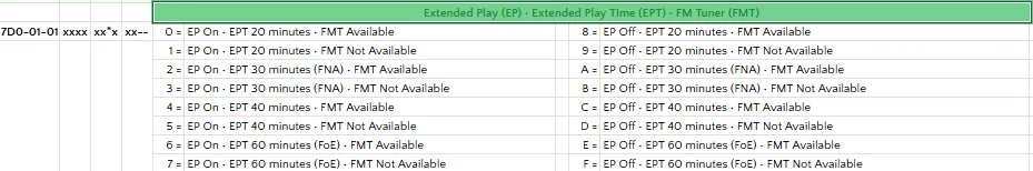

Maybe here in the APIM? FNA is Ford North America and FoE is Ford of Europe. Changing this bit to FoE may get you an hour instead of whatever is in there now. My F150 shows a 0 there which is weird; I expected to see a 2. I rarely every sit in the truck long enough to get the message where it is going to sht down, so never paid attention to how long it takes to happen.

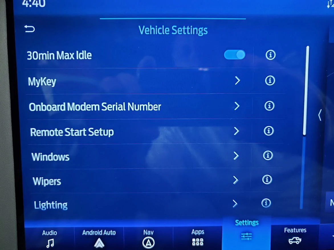

You know that you can turn the dial on the light switch so that the Automatic lights do not come on?
Also, just turn off the 30 min max idle under Vehicle Settings and sit in the AC with it idling.
Yes but the Bronco has quirk where if you cycle the ignition, it always defaults to Auto headlights, regardless of the position you turned the to dial before you turn the vehicle off.
But in my recommendation, you aren't turning the vehicle off. Just turn the dial on the light switch and turn off the 30 min max idle setting. This way, you have AC. Do you all just sit in an enclosed vehicle for hours without AC?
