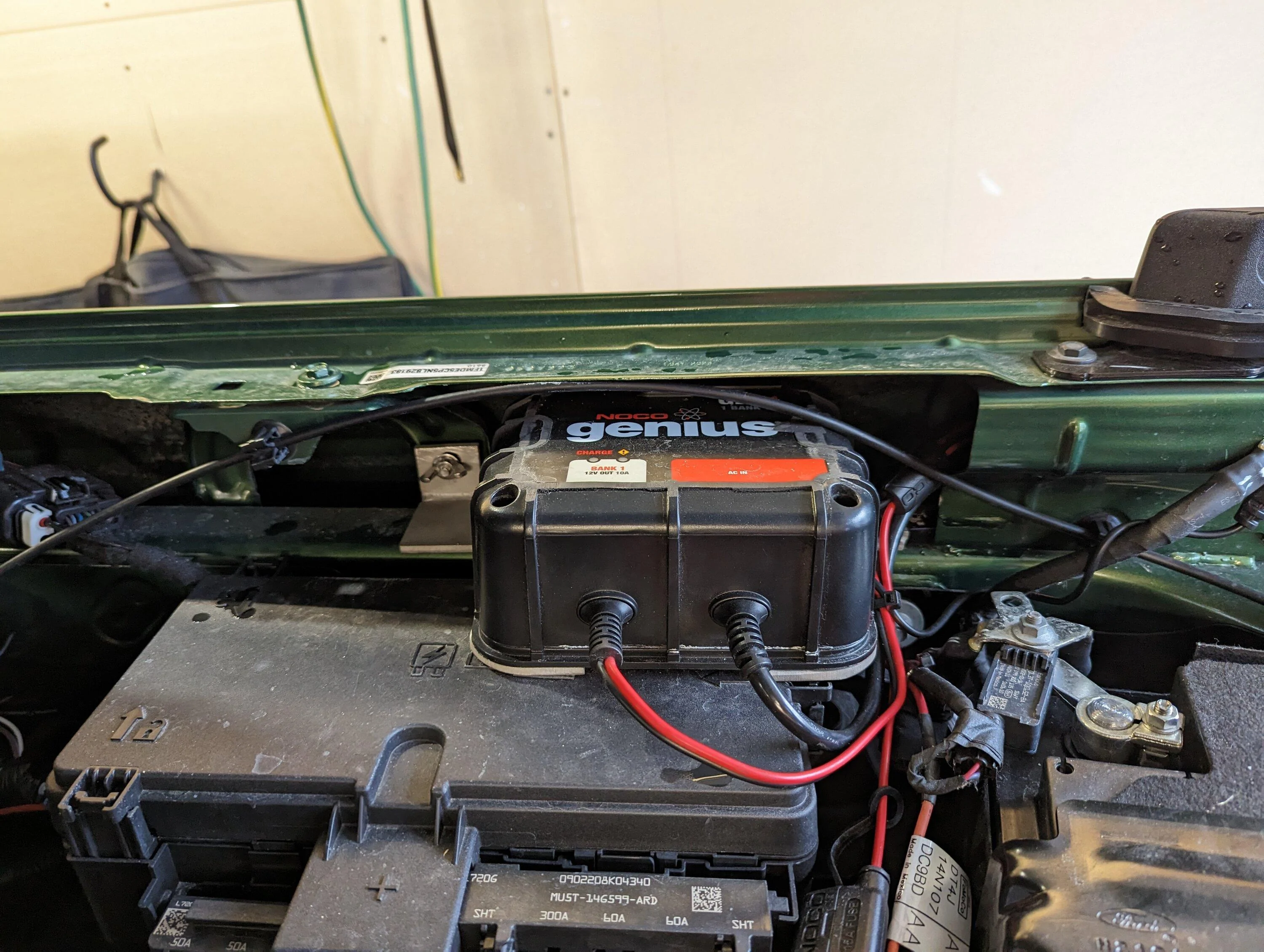

After much consideration, I installed a Noco GenPro 10x1 battery charger/tender semi-permanently under the hood like so:
Ford Bronco Battery Maintainer/Tender and Battery Management System. 20231004_171301

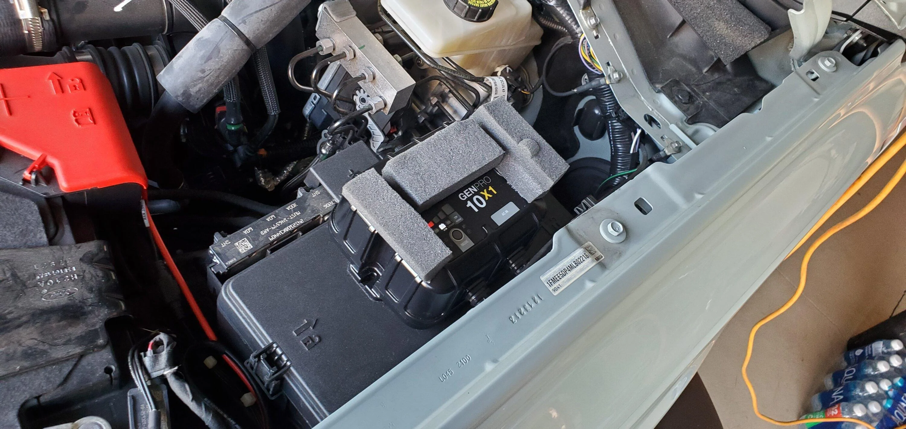

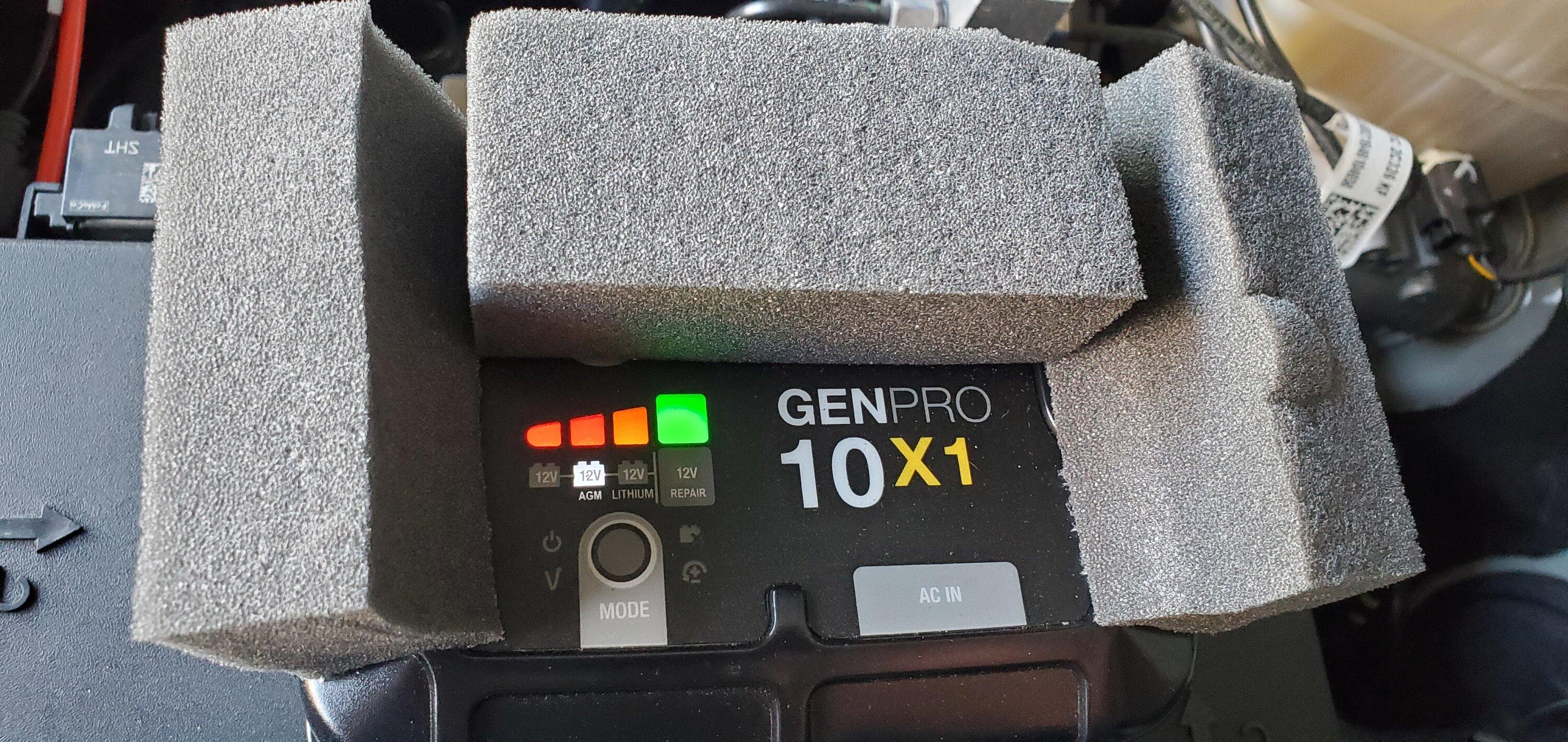

I ordered everything for the project from Amazon and McMaster-Carr. I utilized 'industrial strength' velcro from Amazon as my mounting medium to the top of the fuse box lid, making the unit removeable. The soft side is mounted to the fuse box, hook side to the bottom of the unit. To make the bottom of the unit smoother for mounting, I used a fresh razor blade slid under the rubber 'feet' to pry them off. I ordered some foam strip from McMaster-Carr w/adhesive on one side and cut three strips to install on the top of the unit as in the picture. This foam compresses when the hood is lowered, effectively 'trapping' the unit so it won't move in off-road/aggressive driving conditions.

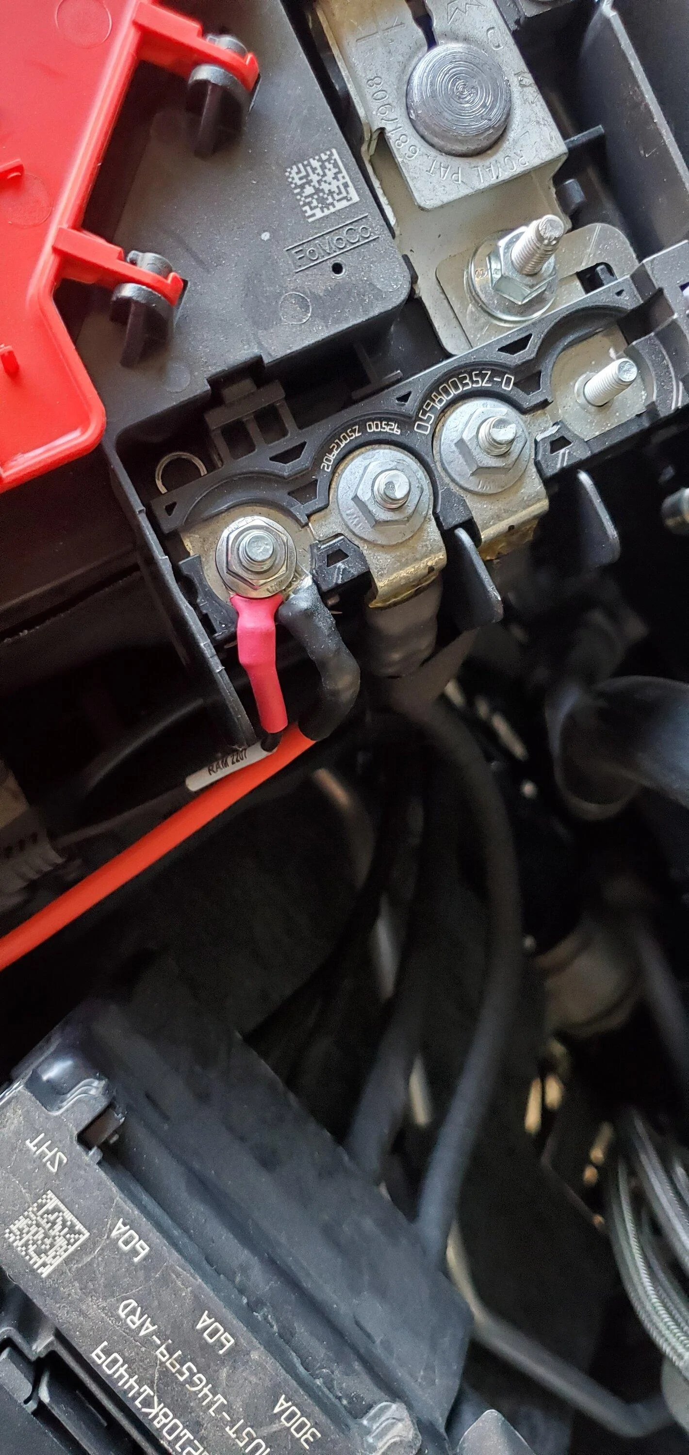

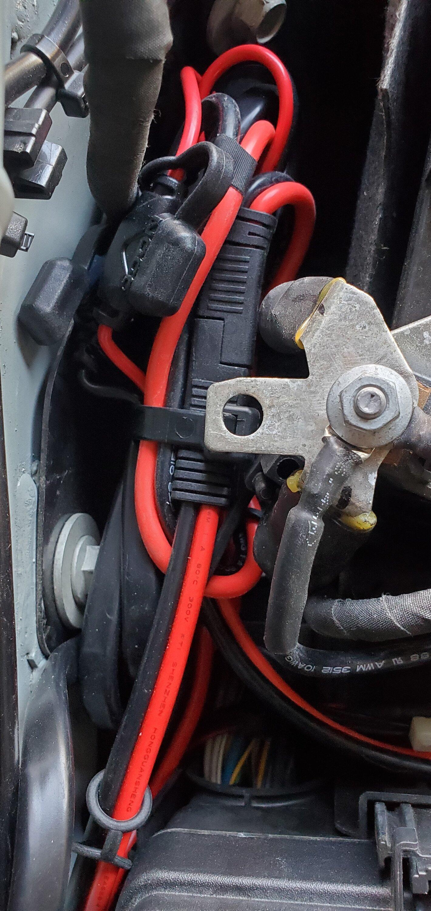

I cut the hook terminals off the end of the charger, leaving the in-line fuses in place. I then soldered an in-line connector from Amazon in place to allow me to disconnect from the Bronco's battery and use some alligator-clip style clamps to charge other batteries if need be.
Ford Bronco Battery Maintainer/Tender and Battery Management System. 20231004_171339
You can clearly see the in-line connector and excess wire neatly wrapped and zip-tied in the picture above. Additionally, the black heat-shrink connector mounted to the outside edge of the battery minder can be seen on the right.
Ford Bronco Battery Maintainer/Tender and Battery Management System. 20231004_171329
The thick red wire with the black heat shrink is the positive lead for the charger mounted on the positive side battery bus. The thin black wire with red heat shrink is the power for the RockSlide Engineering steps.
Ford Bronco Battery Maintainer/Tender and Battery Management System. 20231004_171522
Above is a photo from over the driver's side headlight looking back at the install.

The beauty of this unit is you simply select the mode button for 12V AGM battery type and the Noco unit will remember what you selected. So when you unplug and drive away, when you come back and plug it in it analyzes the battery then charges it as necessary. The Noco unit is also water-resistant, being made for the marine/water environment, so I don't worry about it dying because of water getting under the hood.

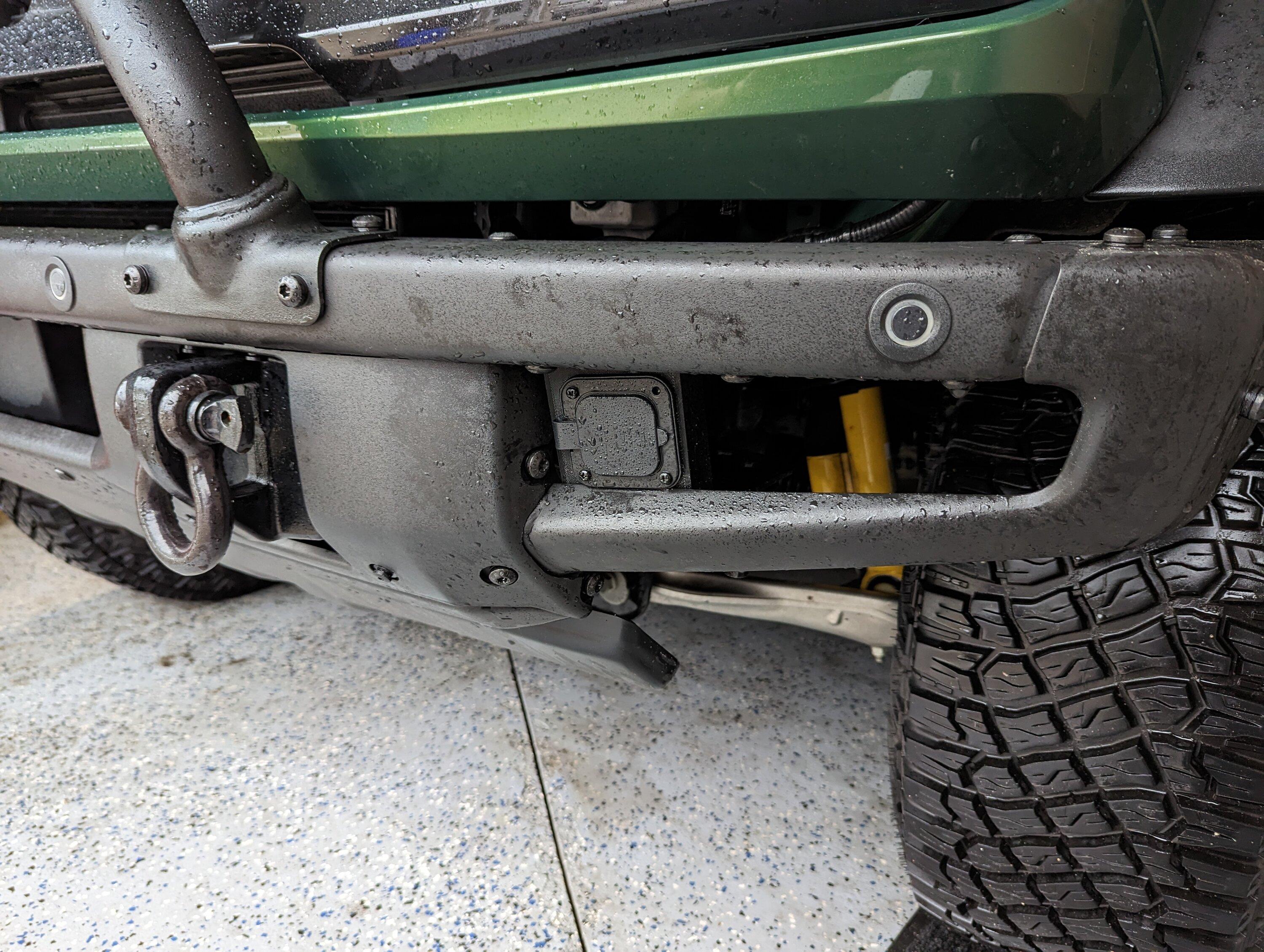

Welded up a stainless steel bracket at work to act as a mount. There's a bit of square tubing along the frame, that plus a bolt+wing nut in an unused fender hole for securing the bracket.
Gets a little too close to the hood but still no contact. Then 3d printed a bracket to use an RV receptacle in the bumper.
Draped the extension cord so you have to unplug it to reach the door. Of course I broke one of the cheap screws that came with the RV recep.
