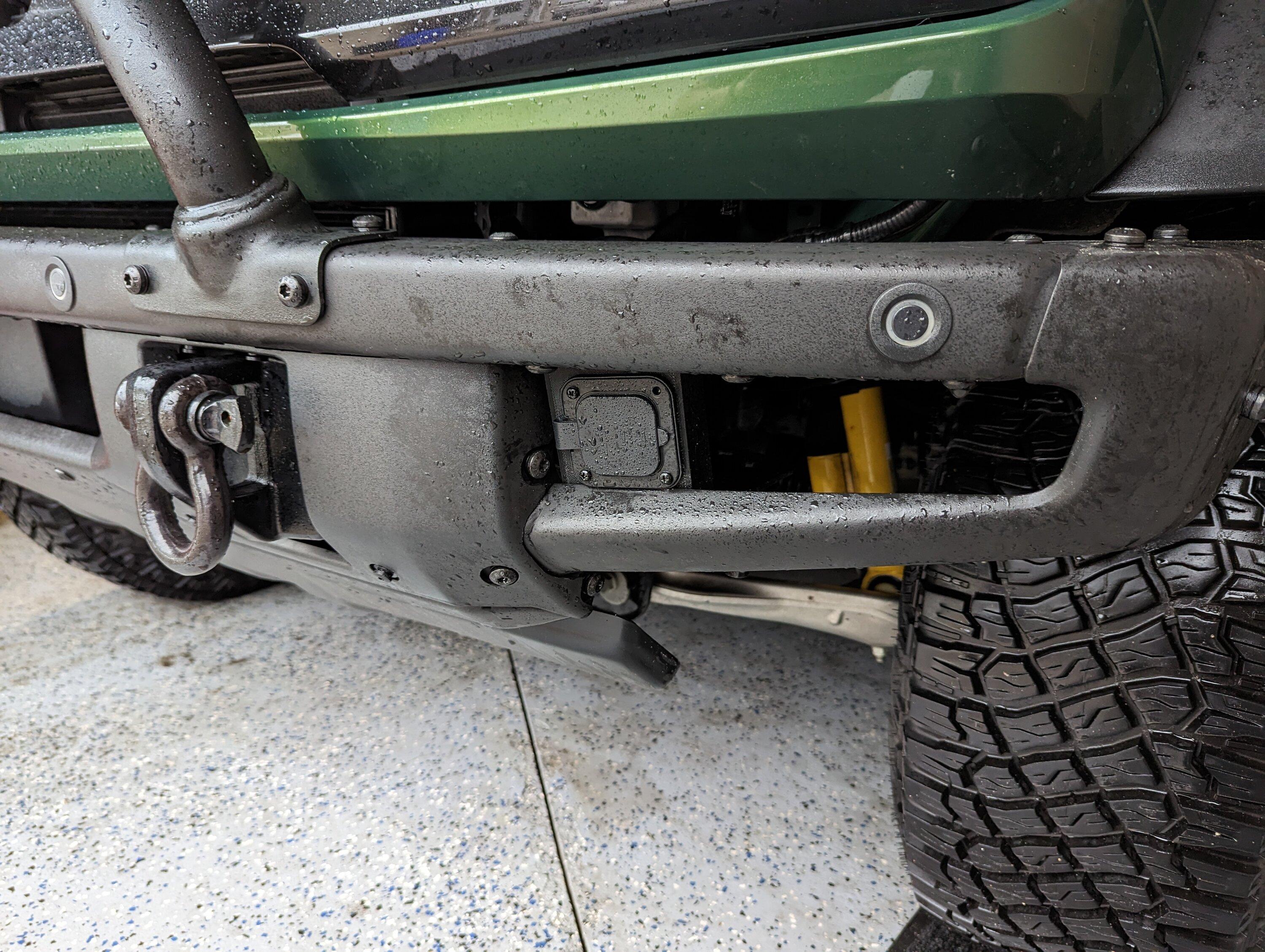

Went with a little 3d printing and generic RV inlet for mine. Not perfect but does the job well enough. Noko 10A fit above the fusebox but *barely*, and a little sanding involved

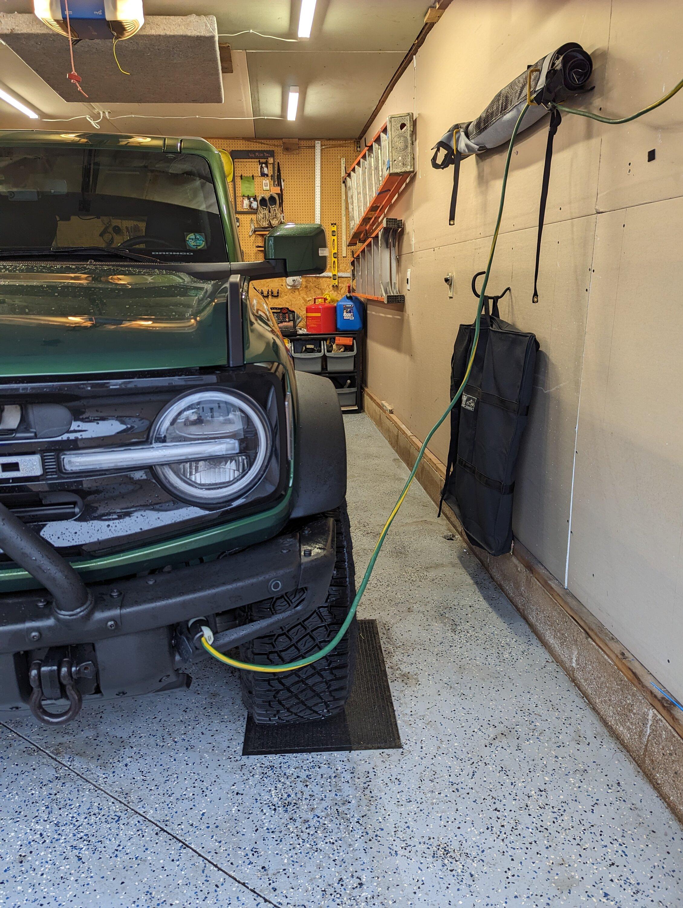

Correct. It’s a trickle charger also. Just plug a cord in and it works. No box to carry around. It’s always with you. Second plug end has a separate purpose coming in the future.
