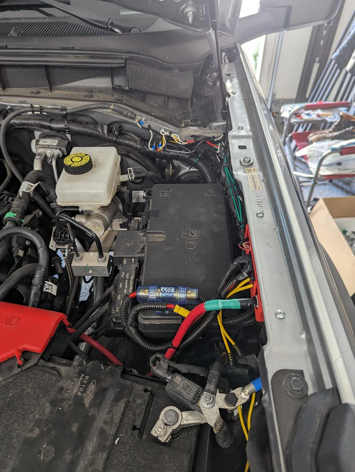

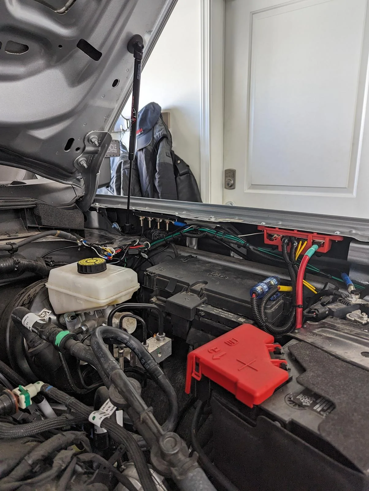

I added positive and negative bus bars under the fender lip of the driver's side fender. I have a lot of additional connections and this just cleaned it up. They can be found on Amazon.

Ford Bronco Multiple connections to pos terminal on battery PXL_20231016_192448374

What gauge wire from battery to bus bars?
Also do you know what the max length of these wires should be?
I flat tow my Bronco and the area you mounted your bus bars is not available to me as it has an air tank that is used to engage the braking for being towed. I'm going to have to investigate mounting options/locations if I add bus bar (s)

I used standard(4 gauge) battery cables 24" long. Unless you're pulling abnormally high amps you can go several feet with that size. You can search Google for cable amperage sizing, it's a fairly simple calculation.
