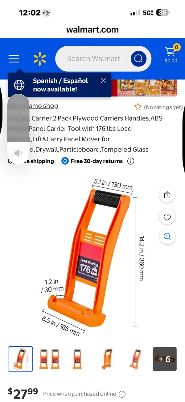

Dry wall carrier. Home depot help greatly with jeep doors. I assume ir would work with bronco.

Stand on inside side of door rach over and hook those to bottom. One had liff door braced between you and hanger. Had a great amout of control to align the door and one free had to guide. Have not tried with bronco yet. I did put padding on contact points.

This looks super cool, thank you!!!

Looks like a good idea. I'd add some padding so it won't scratch the paint.
