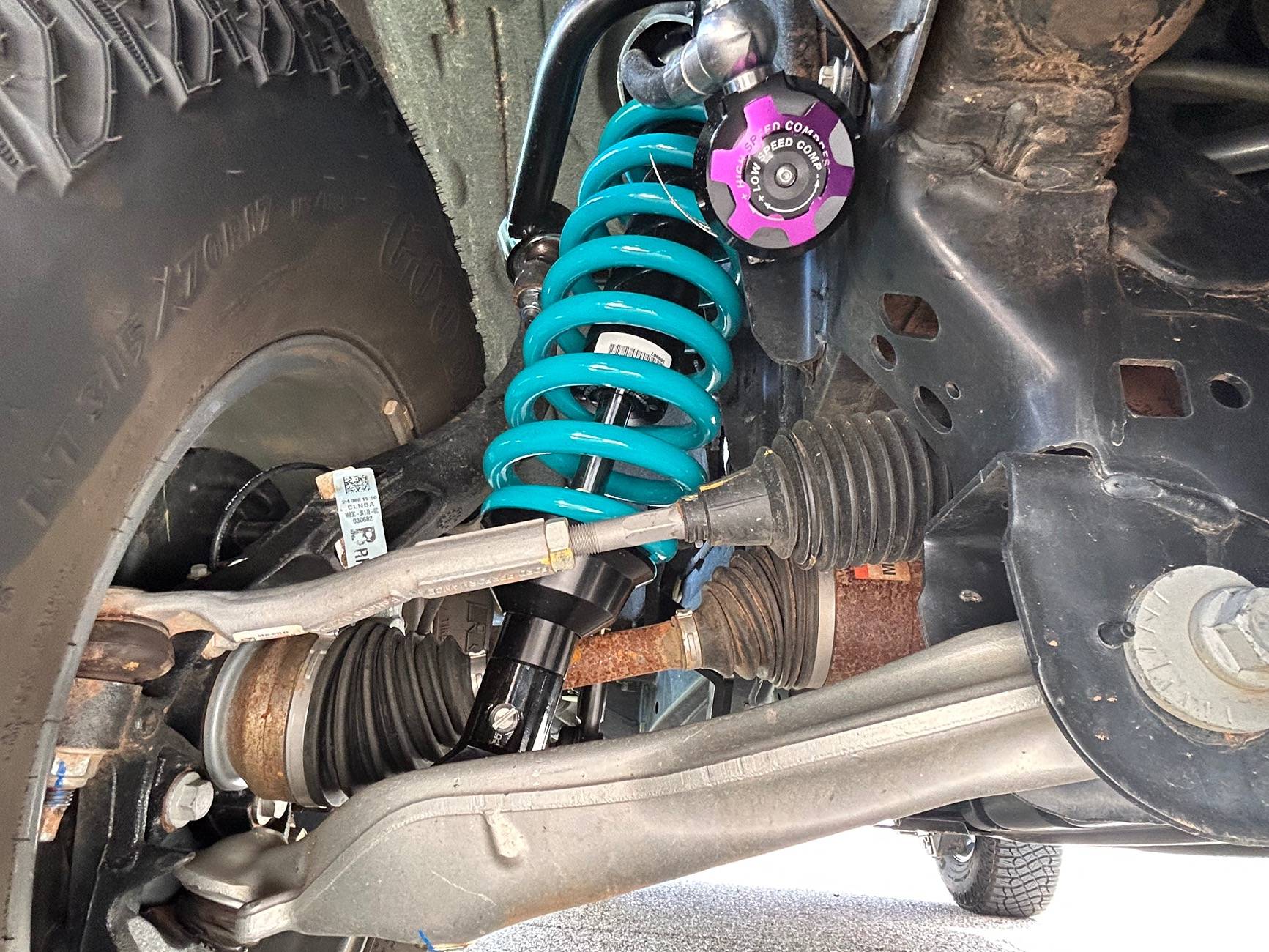

I have this on my 4dr Badlands Sasquatch. I have their full kit with the exception of UCAs: theirs were out of stock at the time so I am using the icon tubulars. You use some spacers on the skid plates to accommodate the sway bar relo and diff drop.
the ride quality is great. On springs, I started w black front and back. With relevant adjustments made, it was perfectly level - and it took winding the rear collars all the way down. This was a problem because I wanted a bit of rake to assure when loaded out w camping gear I wouldn’t be squatted in the rear.
I was able to swap the black rear springs for the teal ones which they noted were slightly stiffer. That worked pretty well for me, but if I needed to do any more, I’d need to swap to two door front springs.
on 35s, I was slightly higher than Sasquatch. With 37s, at full compression/upward travel I was hitting the fender, and with dv8 inner fender liners, I was rubbing at full steering lock on the outermost corner on the front end.

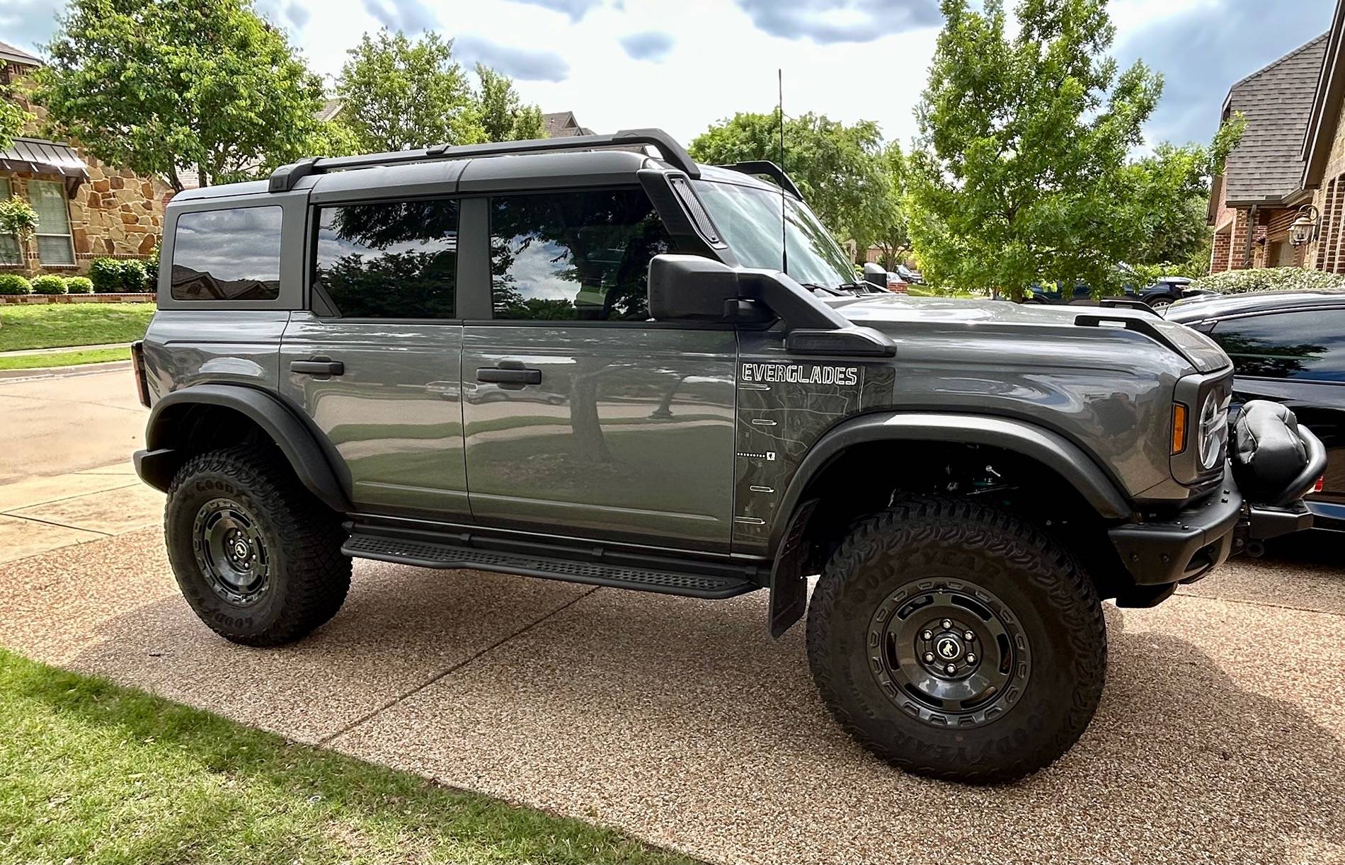

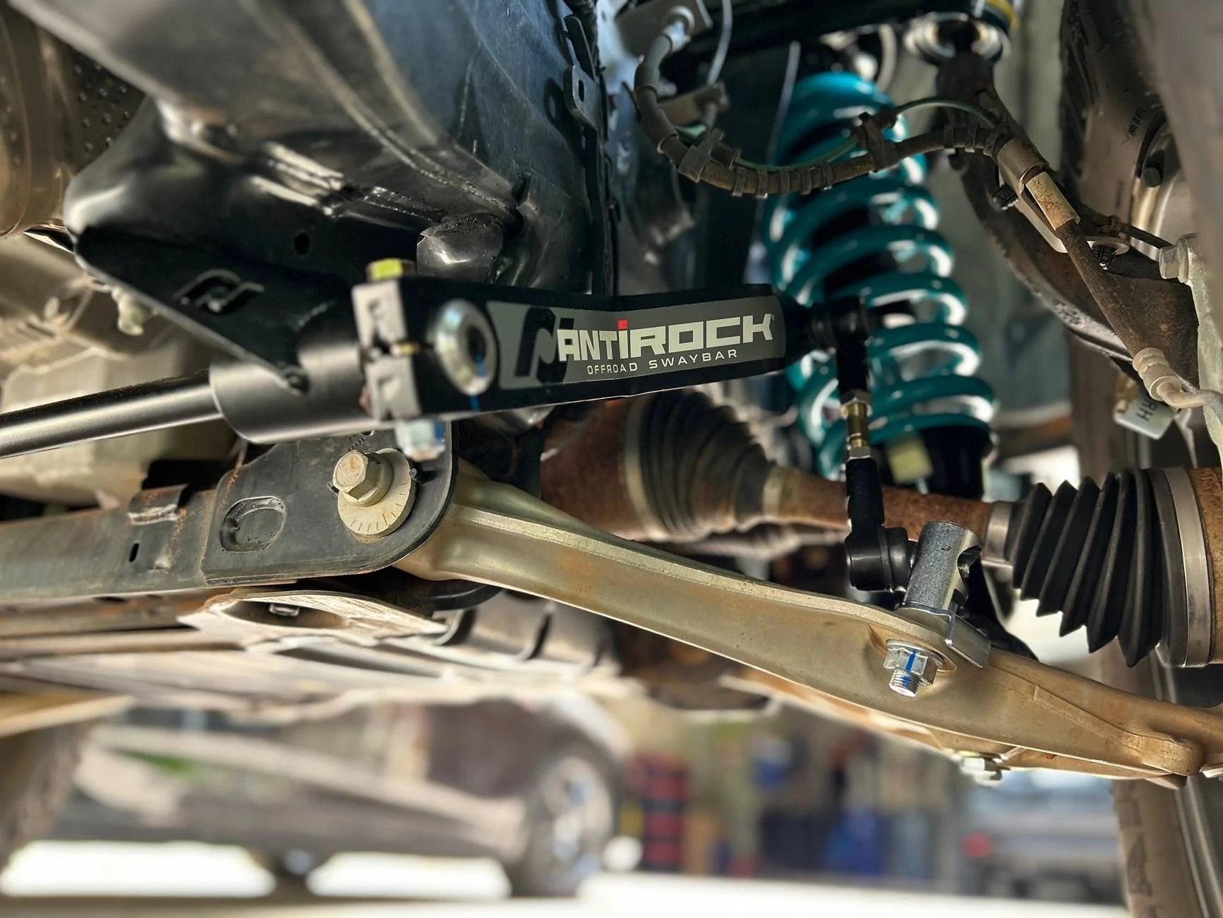

Just placed the order for the dobinsons mrr suspension. Will also add rockjock antirock to the front with track bar relocation bracket in the rear plus icon dj pro uca’s. Will report back on results when all complete. Hopefully will achieve small lift, more flex, better ride. Appreciate everyone’s information.

I’m also running the Rock Jock AntiRock up front. I’d be curious to know which hole your shop uses. Mine went with the stiffest and reluctantly moved it to the middle. I think full soft would be fine given the stiffer springs with my IMS kit. Either way, still softer than stock and has helped with the front end articulation.

installed in the middle hole. Will see how that works. Agree could probably run in third hole. I’m hoping we get some dry weather to try out on trail.
