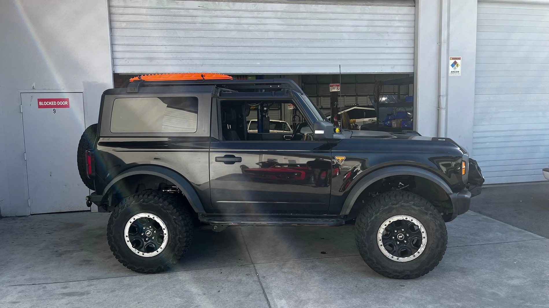

I just had some Dobinson's MRR installed on my 2 Door Sas Bronco and now it looks like a Pre-Runner. I left it at the shop since the front end is so high and thinking the springs could be wrong. We are hoping that it settles and levels, has anyone had any experience with the installation of the MRRs?

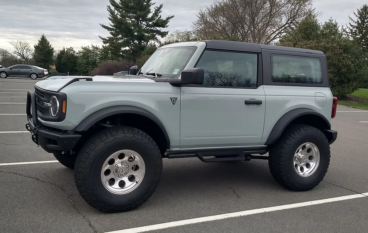

When I put the adjustable ProComps on my 2 door and first got it on the ground, it was sitting high (looked like 3.5-4" of lift). After a short drive to let the suspension cycle over a speed bump it dropped a bit. Then after a week of driving and a couple of slight adjustments it ended up around 2" over Sas. So you probably need to drive it a bit for it to break in and settle.
Here's my truck the day after the install so the front was still a little high. It ended up settling nicely. Straight off the jackstands it looked way too high.

Unfortunately, I did not take a picture but I do have the measurements before and after. Initially I was running the Eibach Pro Truck Coilovers Front Passenger 39.75, Front Driver 39.5, Rear Driver 40.25 and Rear Passenger 40.50. MRR installation Front Passenger 42.25, Front Driver 42.00, Rear Driver 40.25 and Rear Passenger 40.50. I will find out on Monday if it has settled over the weekend.

Essentially my Bronco looks like this but we will see what it looks like on Monday after sitting over the weekend.

Here's the finished product, after a call to Dobinsons we found that the coilovers were not adjusted properly. The before installation measurements FD (39.5), RD (39.75), FP (40.15), RP (40.5) and here are the current measurements FD (41.5), RD (40.75), FP (42), RP (41.5). Now I am curious to see how they will settle.
