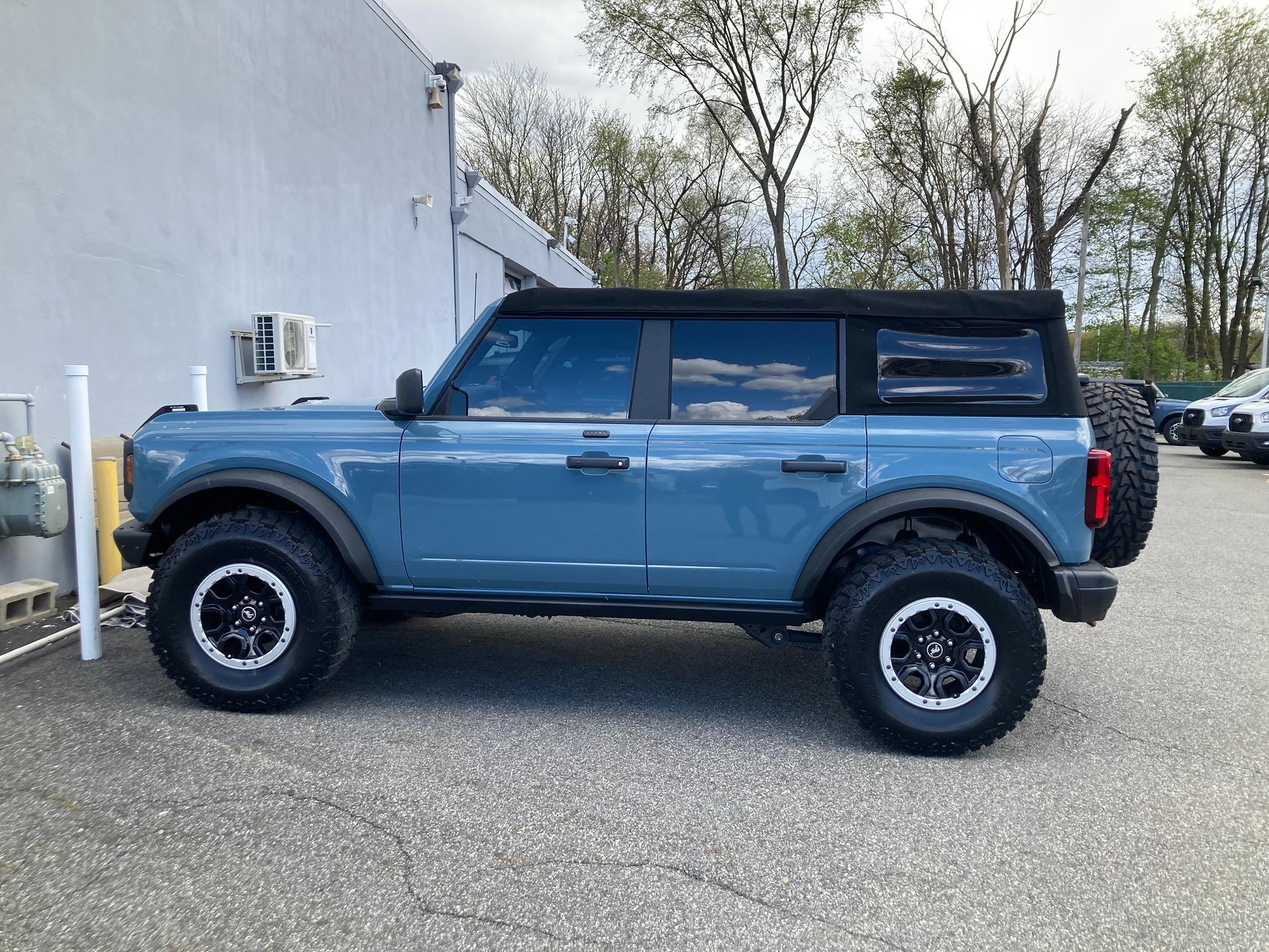

i trail hop daily 36x12.5x17 exhaust air intake bov no lift no rub and i wheel hard mud and pre running no crawling rock dont like the banging sounds lol
Ford Bronco Suspension and Tie Rods Inquiry IMG_2685
Being in Northern California the terrain is so diverse you can pick and choose how you really want to use the Bronco. Since I am so close the Rubicon there are plenty of places to rock crawl and a lot washouts to do pre-running. I want to replace the rear bumper with a Turn Offroad rear bumper before I hit the Rubicon.
