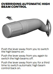

I looked in the manual, you can override it, but it still a poor system IMO. It should auto-dim when high-beams are on, not turn high beams on when I have lows on.
