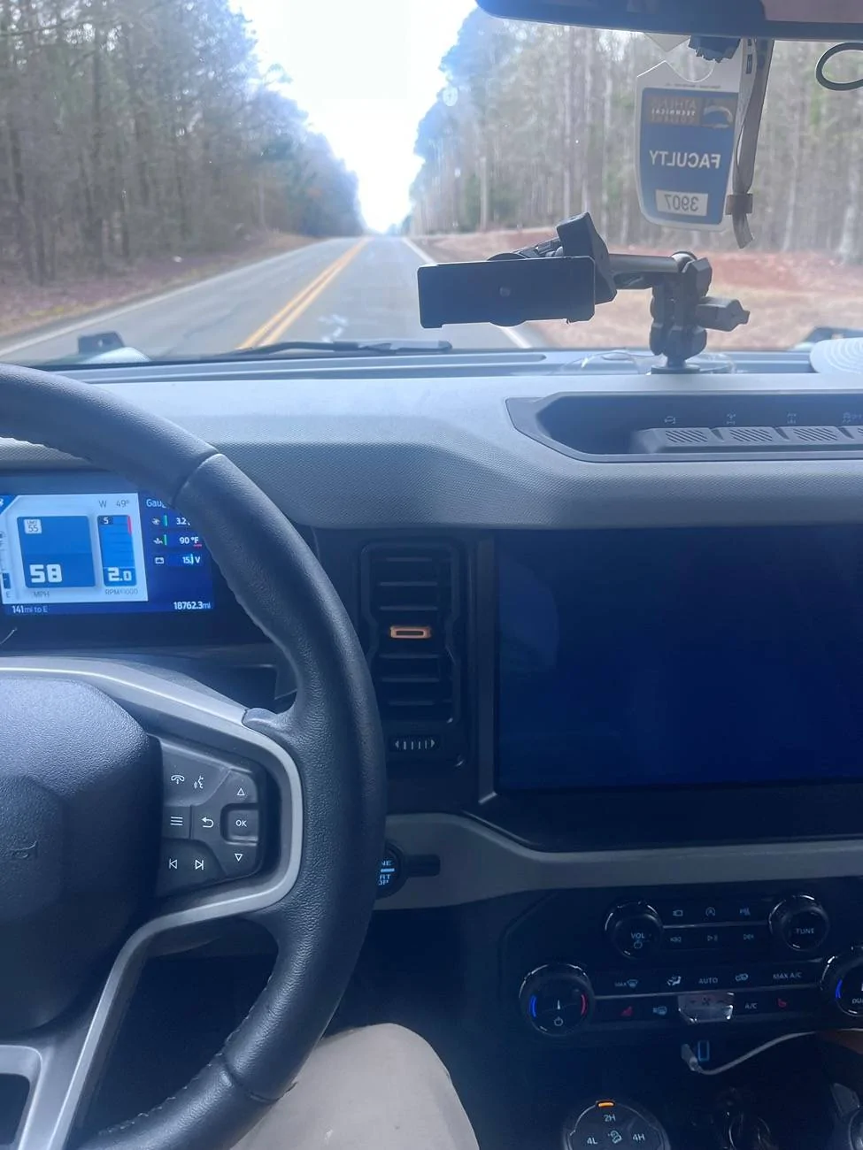

Anyone else have their displays go out randomly? Fan speed control still operates. Radio won’t work when blank.
Does this two maybe three times a week.
After cycling the truck on/off the display comes back most times.
