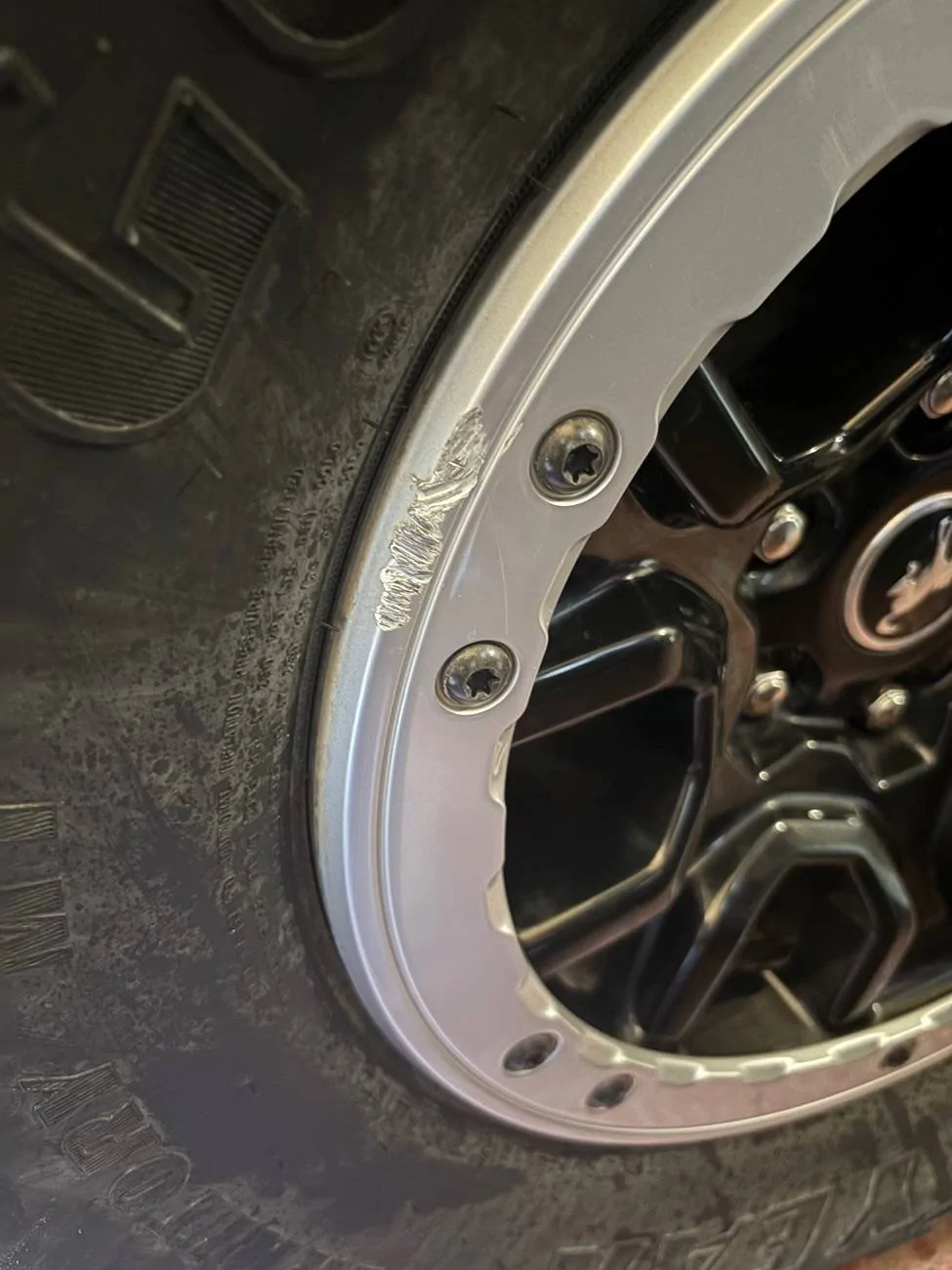

Sounds like you need to get more rock rash then they may mount tires for you.
Seriously the rings don’t need to come off to mount tires?
Ford Bronco Discount Tire Turned Me Down IMG_2201

I can understand why they would be concerned about scratching the ring. Watch the dismount and mounting process. These machines are made for production, not delicate trim. I'm concerned even with my steel wheels they will get scratched up. Best to remove the rings yourself.

It depends on the machine and the type of dismount head. However, in general, no tire machine is designed to run on the surface-face of the wheel.
problem with the trim rings is they add some extra meat on top of the wheel. if you add the fact that the tire itself is not a low-pro tire with a flat side wall, you have a valley that is created that dismount head or bead bar needs to get into.
I don't blame the tire shops, I'm sure theyve had countless claims from customers for damaging expensive wheels.
