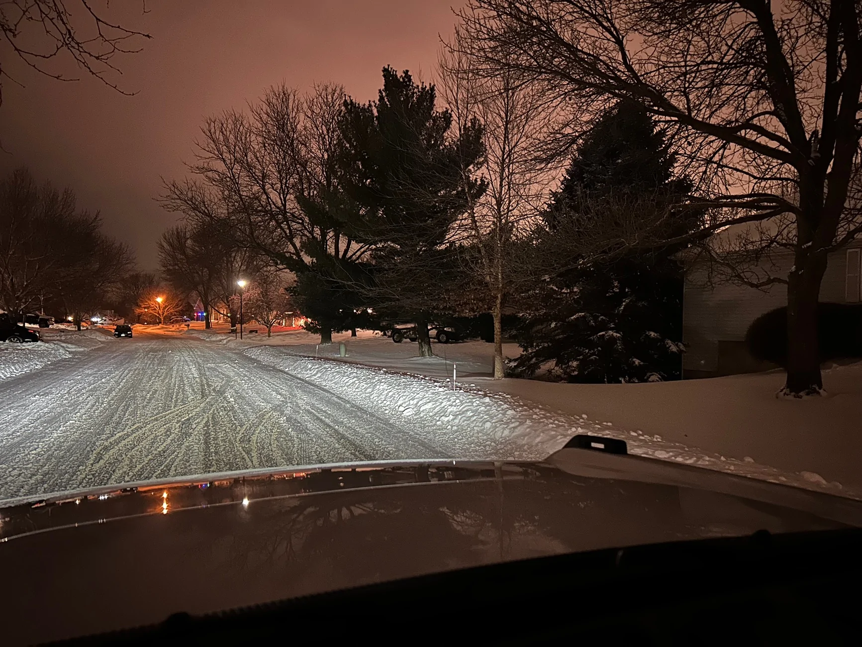

Can you post a pic of just the fogs on, no headlights, from the drivers view, and another with the headlights on too, just for reference how much of a difference they make?
Sure!
Just the ā€˜24 Badlands LED headlights low beam:
Ford Bronco Diode dynamics fogs IMG_5263

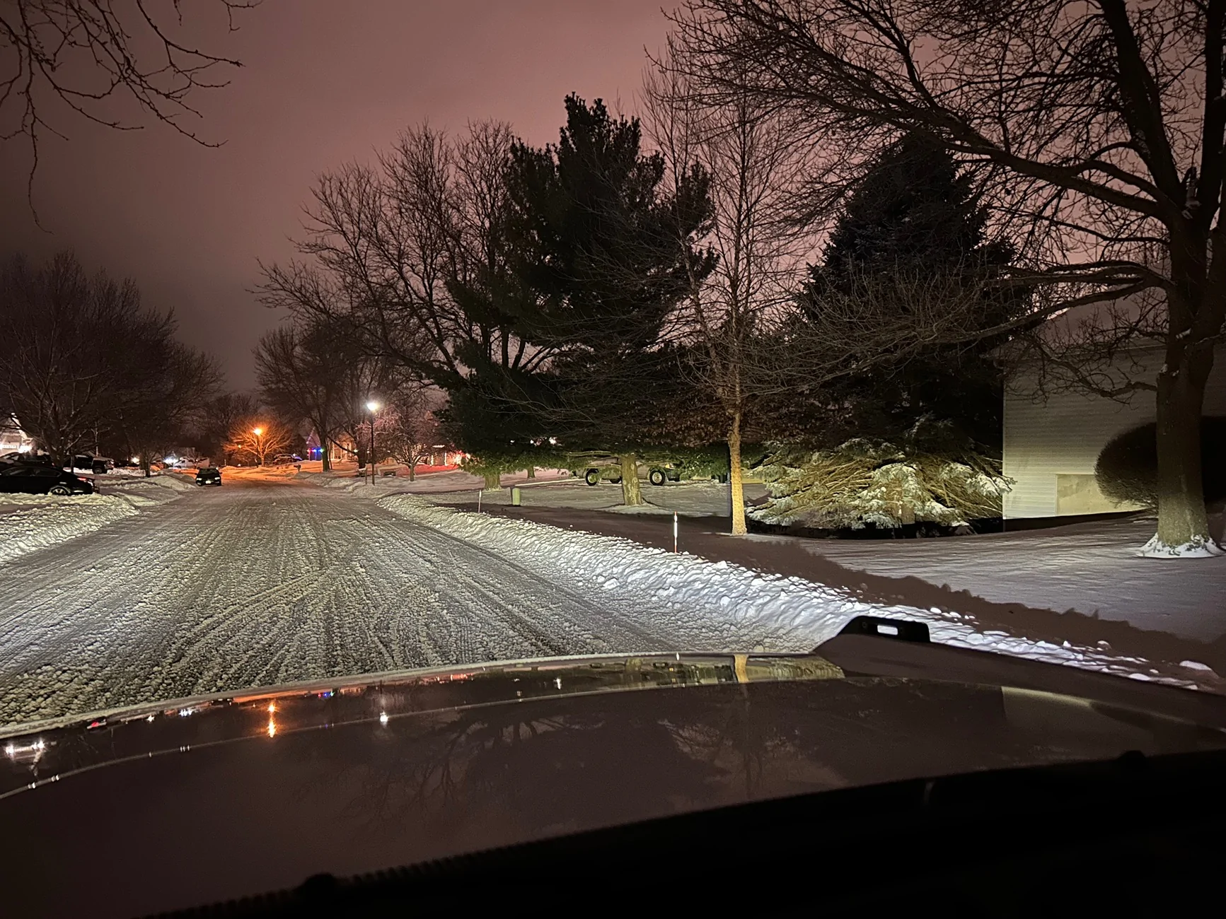

Just the white and yellow DD SSC2 Sport SAE fog lights on, without headlights:
Ford Bronco Diode dynamics fogs IMG_5264
You can see how much wider the light-spread is while still illuminating the road forward.

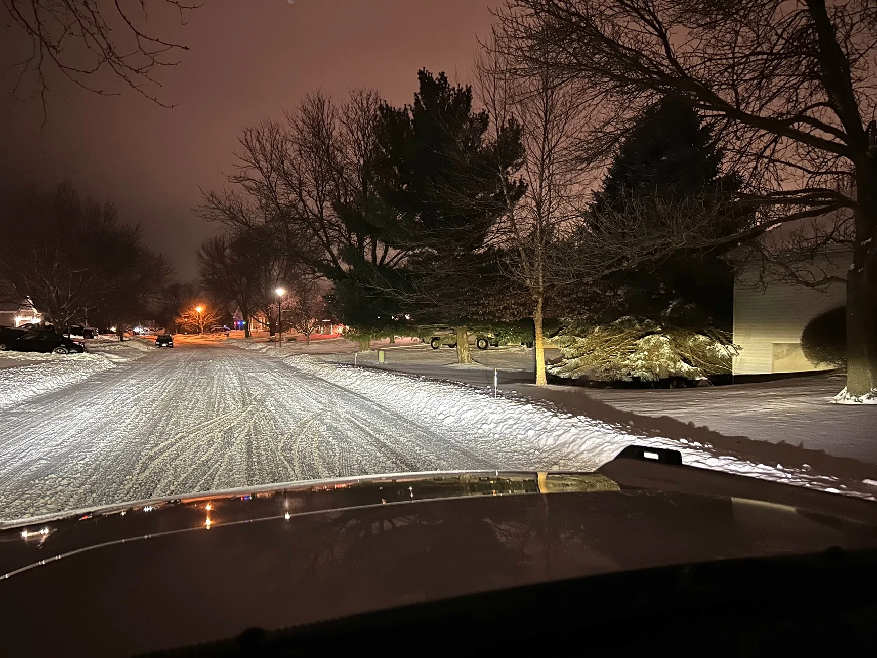

Both white and yellow DD SSC2 Sport SAE fog lights and Badlands LED headlights low beam on:
Ford Bronco Diode dynamics fogs IMG_5265
The white SSC2 Sport SAE fog lights put out more illumination then the yellows. Either color or both in combination are pretty good at lighting up the road ahead.
What I was looking for, in addition to some additional light for fog and snowing conditions, was more light for cornering and for illuminating the roadside for deer. I very much got all that and am very happy with the 4X4Truck.LEDs Diode Dynamics Dual Fog Light Kit.

Sure!
The white SSC2 Sport SAE fog lights put out more illumination then the yellows, and both in combination are pretty good at lighting up the road ahead.
That's awesome! Thanks for the pic, totally shows how much coverage they put out!
Hmm, adding to my wish list now, dangit!
