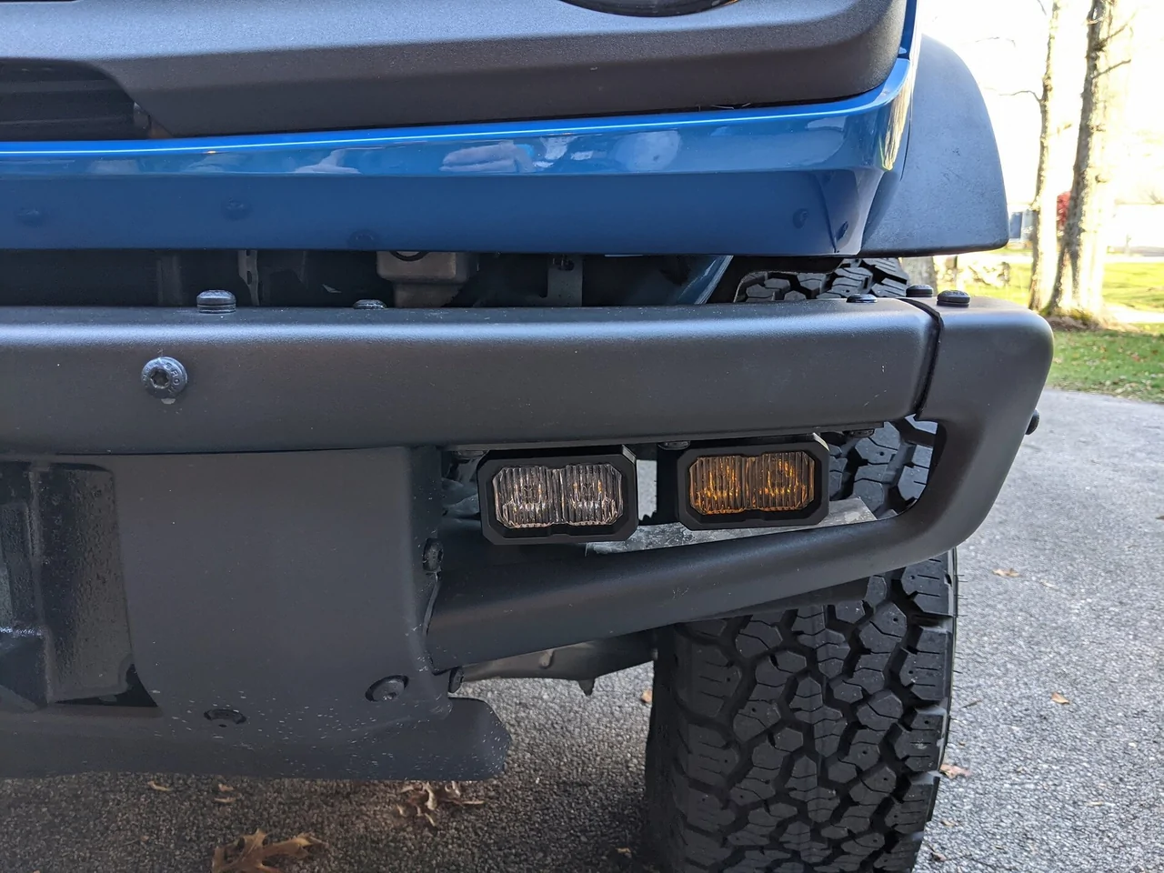

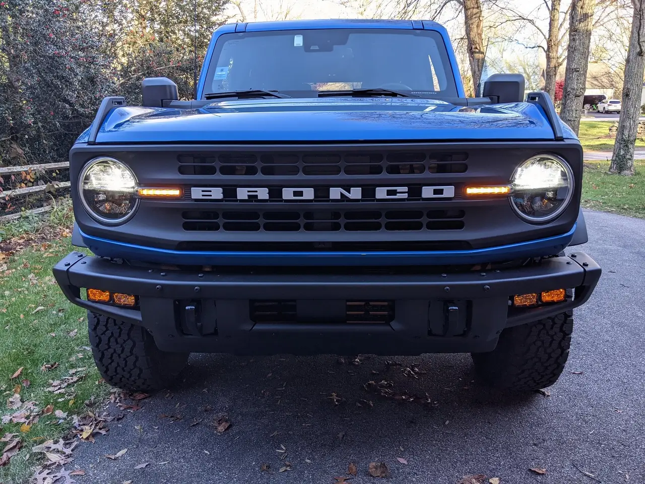

just received
Look about right?
Also the 4x4 truck leds harness looks like it’s designed for 3 lights on each side
Assuming just leave one disconnected?
thx
Ford Bronco Diode dynamics fogs IMG_0194
Ford Bronco Diode dynamics fogs IMG_0195

Look about right?
Post a pic taken a bit further back.
Going by the provided pic, my gut says to move the lights inboard so they are biased to the larger part of the opening. (you have disturbed my delicate internal balance - lol )
The pics at 4x4truckleds sits better with me.
Ford Bronco Diode dynamics fogs 1767069169363-u6
Ford Bronco Diode dynamics fogs 1767069208403-3y
