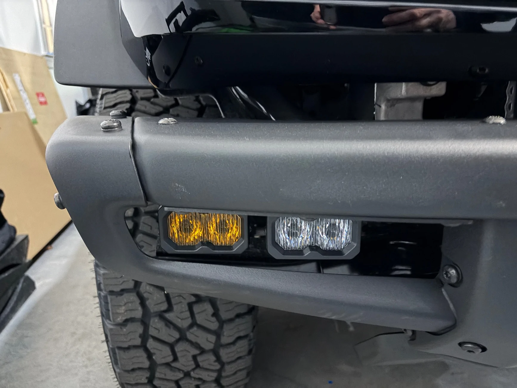

Look about right?
Also the 4x4 truck leds harness looks like it’s designed for 3 lights on each side
Assuming just leave one disconnected?
thx
I would center them both but that's just my OCD.
Yes we provide a triple harness so that if/when you want to add a 3rd light later your wiring is already there. Just tape it up out of the way.

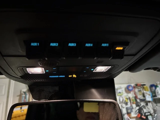

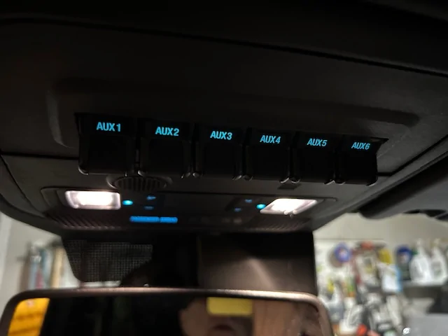

I'll check, I thought it was posted here that were illuminated blue in the off position.
right but do they turn orange when you flip them even without anything connected?

Correct, just checked mine. Blue when I open the door, amber/orange if the power is on, and the switch pushed to the on position. Turns amber/orange even if nothing is hooked to that wire.
Ford Bronco Diode dynamics fogs noPower
Ford Bronco Diode dynamics fogs PowerOn

The blue backlight turns on when the truck is in ACC mode. They are always lit up when the switch is "active" and ready to go.
When you turn the actual switch on, it turns amber/orange indicating it's actually ON and providing power to the upfitter.

just received
Look about right?
thx

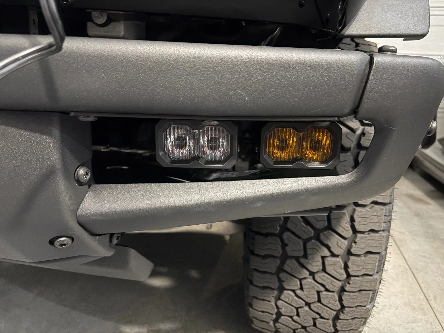

I recently installed the same Black Friday sale Diode Dynamics dual fog light kit from 4x4TruckLEDs.com on my 2024 Badlands with stock upfitter switches. I centered mine in the mod bumper openings.
Very quality lights, brackets and harness, easy installation. I highly recommend.

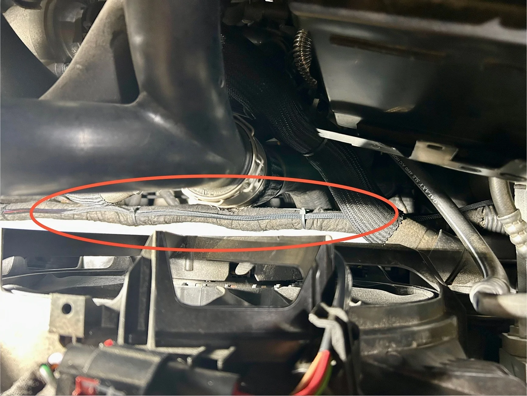

Rather than lay the harness on top of the skid plate, I wire-tied it to the existing cross-frame wire bundle behind the radiator in the engine bay:

I think it’s terrific that 4x4TruckLeds furnishes their wiring harness for the double fog lights kit that’s already pre-wired to rock ā€˜n roll a future plug ā€˜n play third pair of lights. They should point out in their sales literature the nice fact that their harness is upgrade-ready. Will definitely be adding a third pair of lights from 4x4TruckLEDs down the road.
In the meantime dialectic grease and electrical tape will seal off the spare connectors, or these o-ringed sealed Deutsch dust caps can be obtained cheaply from Amazon.
At first I mistakenly thought that the DD SSC2 Sport SAE fog light output was a bit underwhelming, but once I got them properly aligned there’s a lot of bang for the buck illumination! They penetrate fog, falling rain/snow, have a wide enough spread for cornering and lighting up the ditches, and have a sharply discernible cut off so I know I’m not blinding oncoming vehicles. And the amber back-lit running lights function is very cool.
