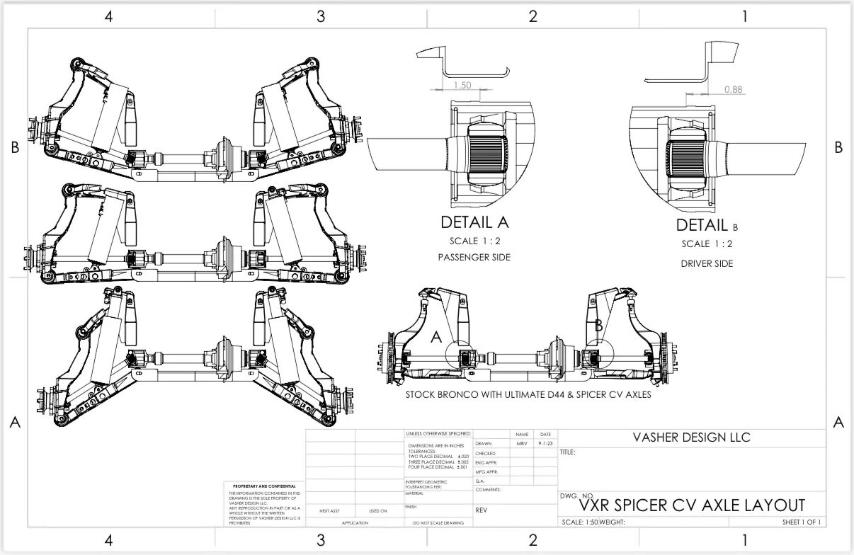

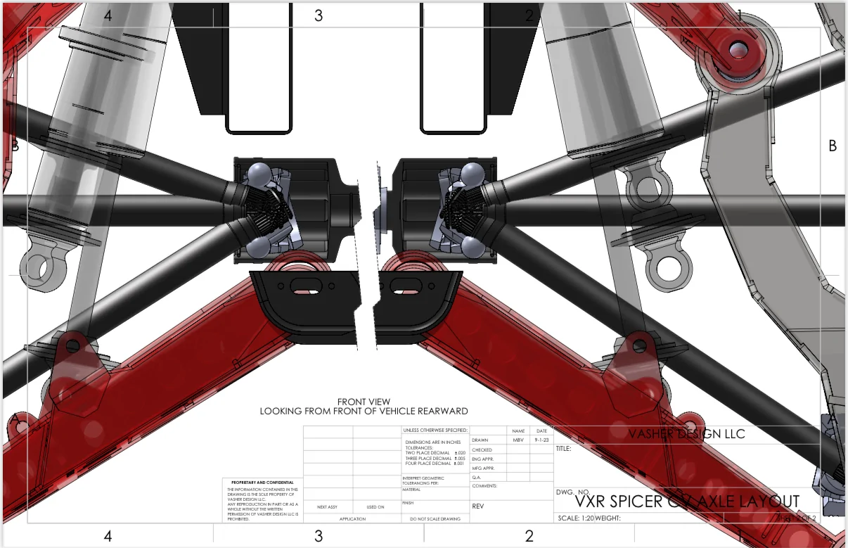

Vasher does not screw around.
He is very thorough. He’d never worked with the 32 spline axles or UFDU so I had to send him the axles and he tore them apart for angle and plunge measurements. He then had me take diligent notes on the FDU placement on the mullet bronco to get as accurate as possible on the center bars being the correct length. It was a process.
