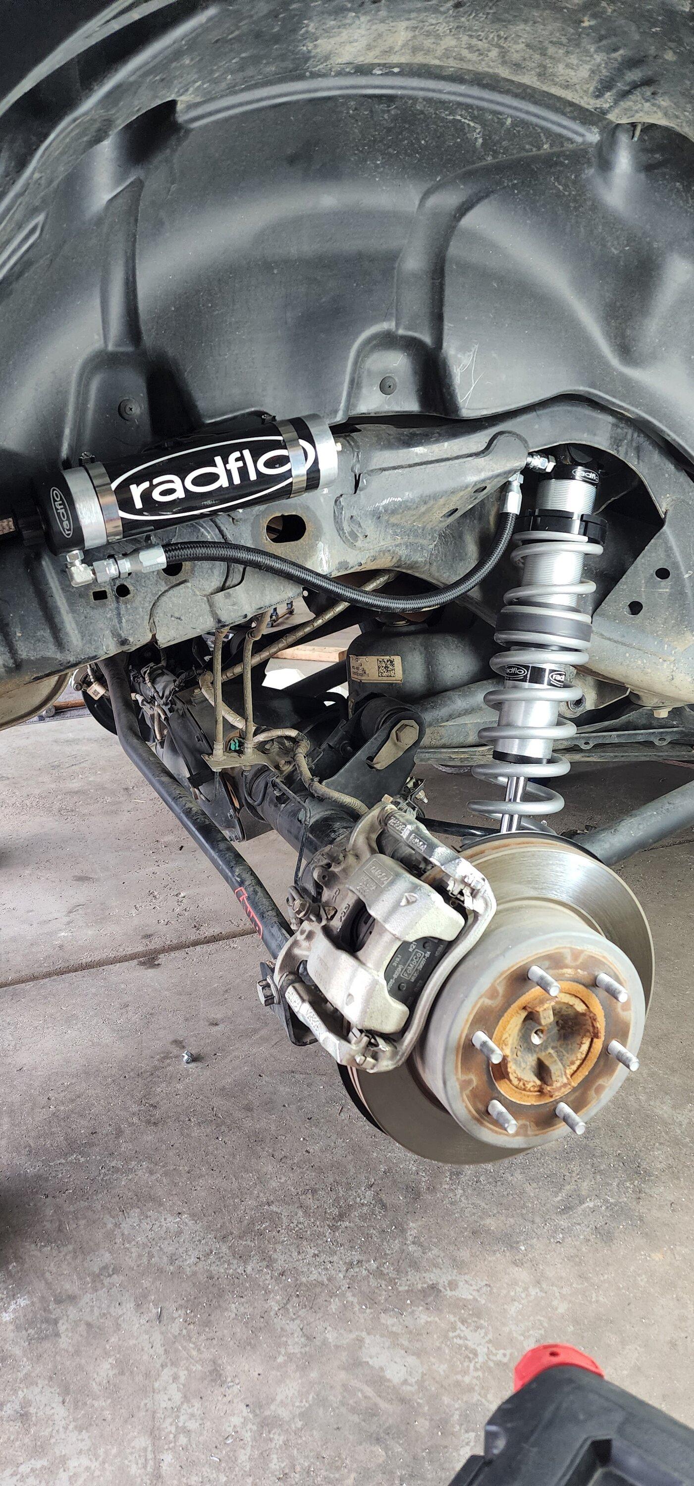

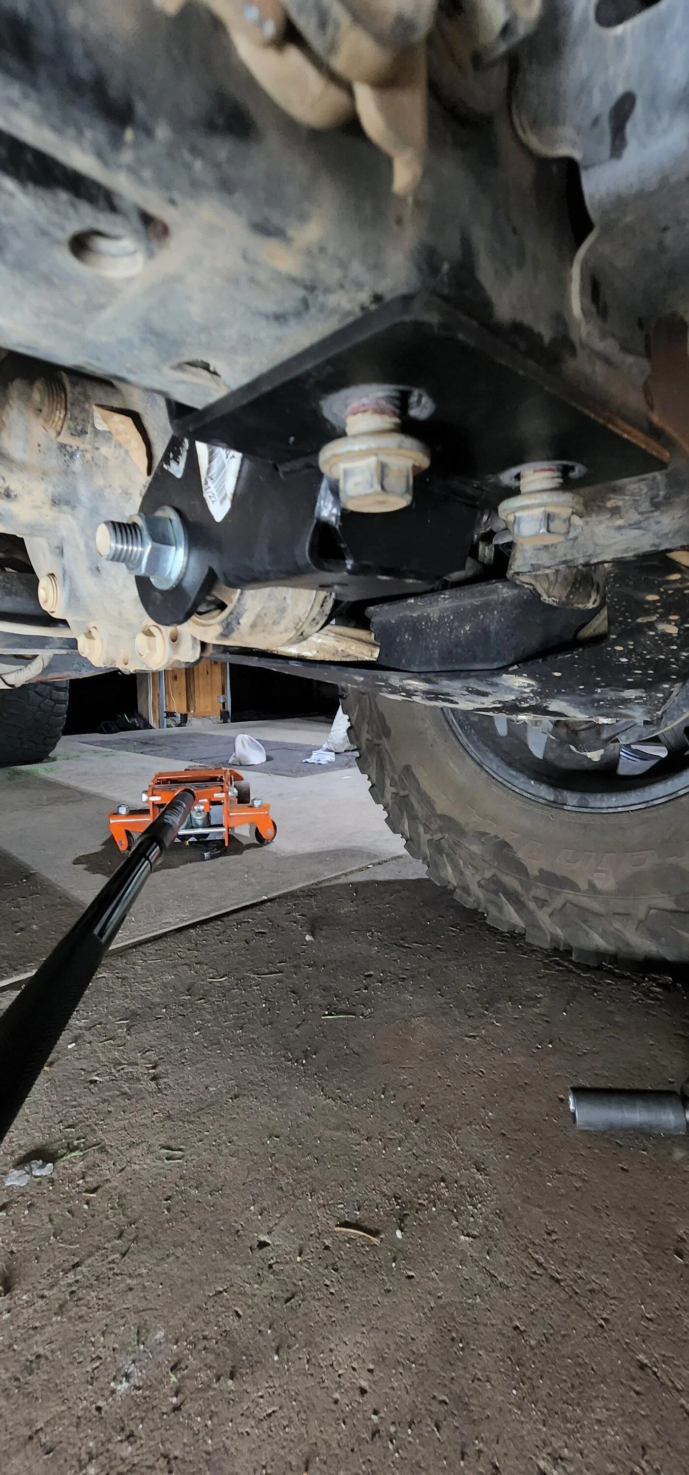

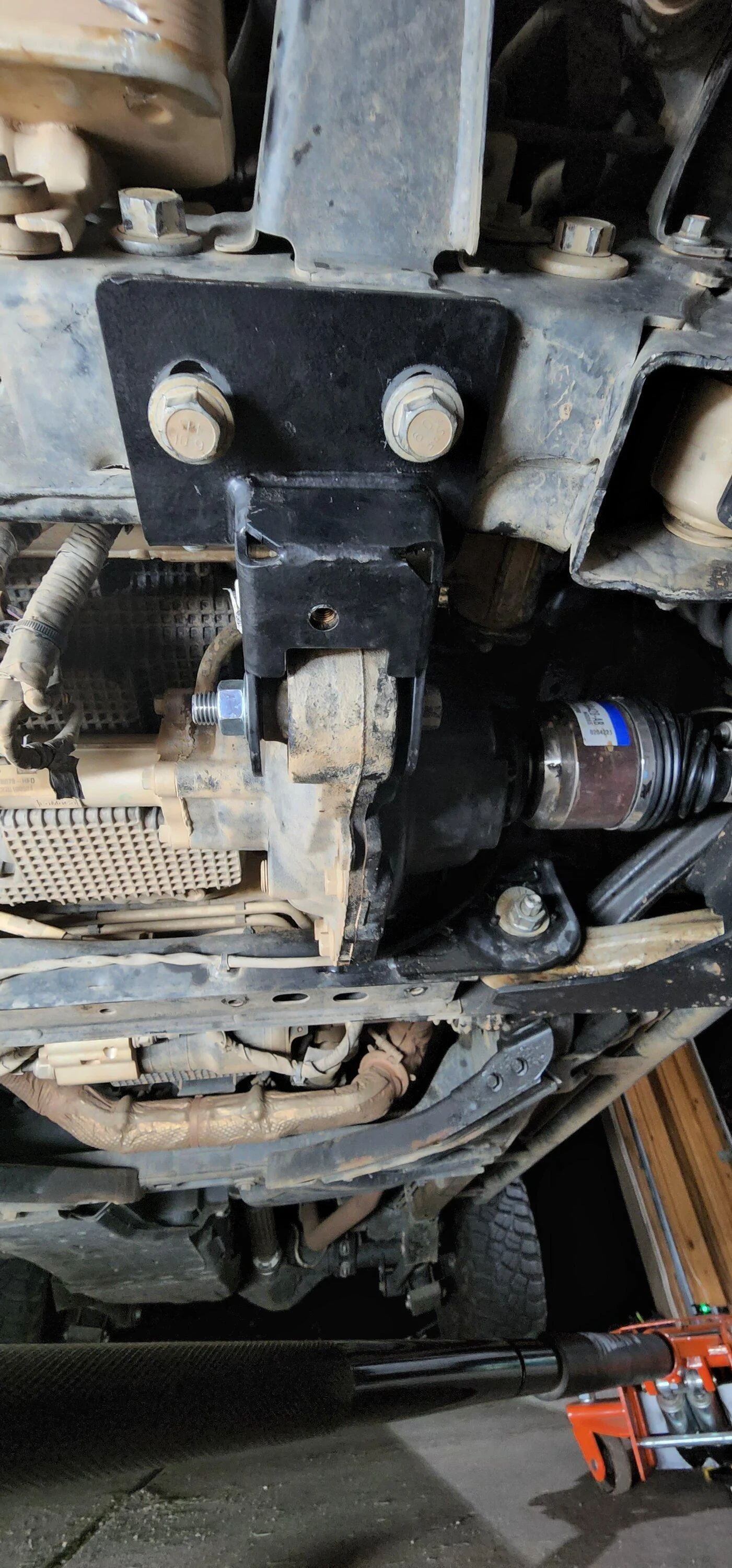

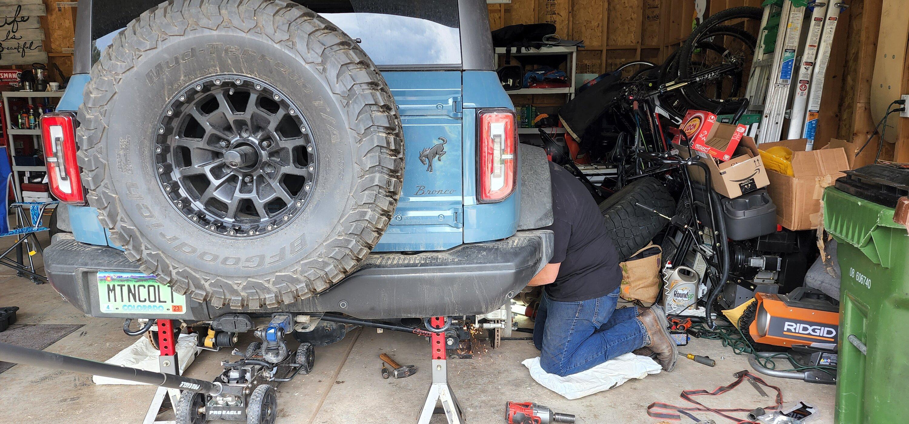

Just a little update: I got the Radflo's installed and they are A M A Z I N G! They are adjustable with a dial on the reservoir that controls how hard or soft the compression and rebound can be. I also installed a front differential drop bracket to lower the angle of the CV axle's to be more linear. The pics are before I tightened the bracket bolts. Oh, and I also took off my rear swaybar for better articulation.

Where did you get the front diff drop bracket?
It is from Rough Country. You kinda have to beg them to sell you one since they don't really sell them separate from their kits
