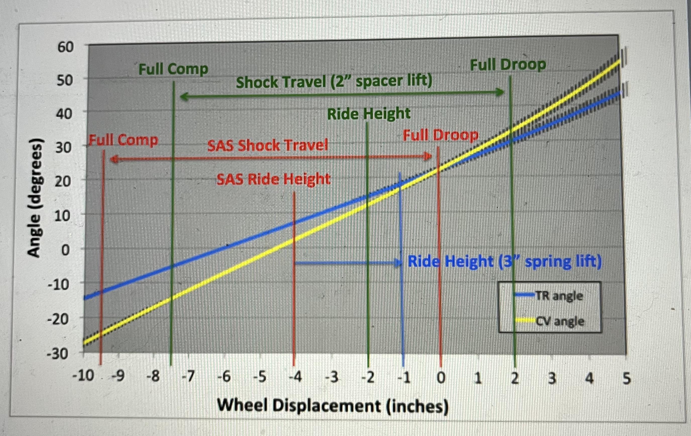

Attached is a chart showing calculated CV axle angles for my near SAS geometry. I estimate my angles vary from +20 to -20 degrees for full droop to full stuff. And are about 5 degrees at ride height.
