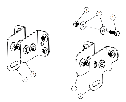

Both brackets have the bolt running all the way through the frame, so neither would see a single shear load. The extra frame bolt on the top bracket doesn't make it a double shear, they're both technically double shear. For example, a trailer hitch pin is in double shear, while a hitch ball is in single shear...the discrepancy in diameter of the two for the same load rating does a great job of explaining why double shear is a stronger design.
I was looking at the LOD Install instructions, and they aren't double shear at all, they are using 4 bolts and nuts into the frame rails per side...
https://lodoffroad.com/assets/pdfs/BFT2100 Bronco 2021 Front Bumper Frame Tie Brackets.pdf
Ford Bronco Damage while using winch on improperly installed Rough Country High Mount 1681264745079
Also, the area of the frame they are bolting into is part of the frames crush zone. Has anyone looked at the thickness of the frame horns themselves up there? (I haven't yet)
I'm undecided if I would want to do these double shear anyway, but If I did, I would drill a 1" hole through the frame rail,, and weld in a piece of something fairly sturdy (Pipe) in the hole, because if you do put a double shear bolt through a crushable part of the frame like this, you'll badly deform the frame rails when you tighten it.
It also doesn't look like it will be easy to add any kind of single substantial gusset to each bracket with the number of bolts that are going into each plate, so multiple smaller gussets might be the way to win the day.

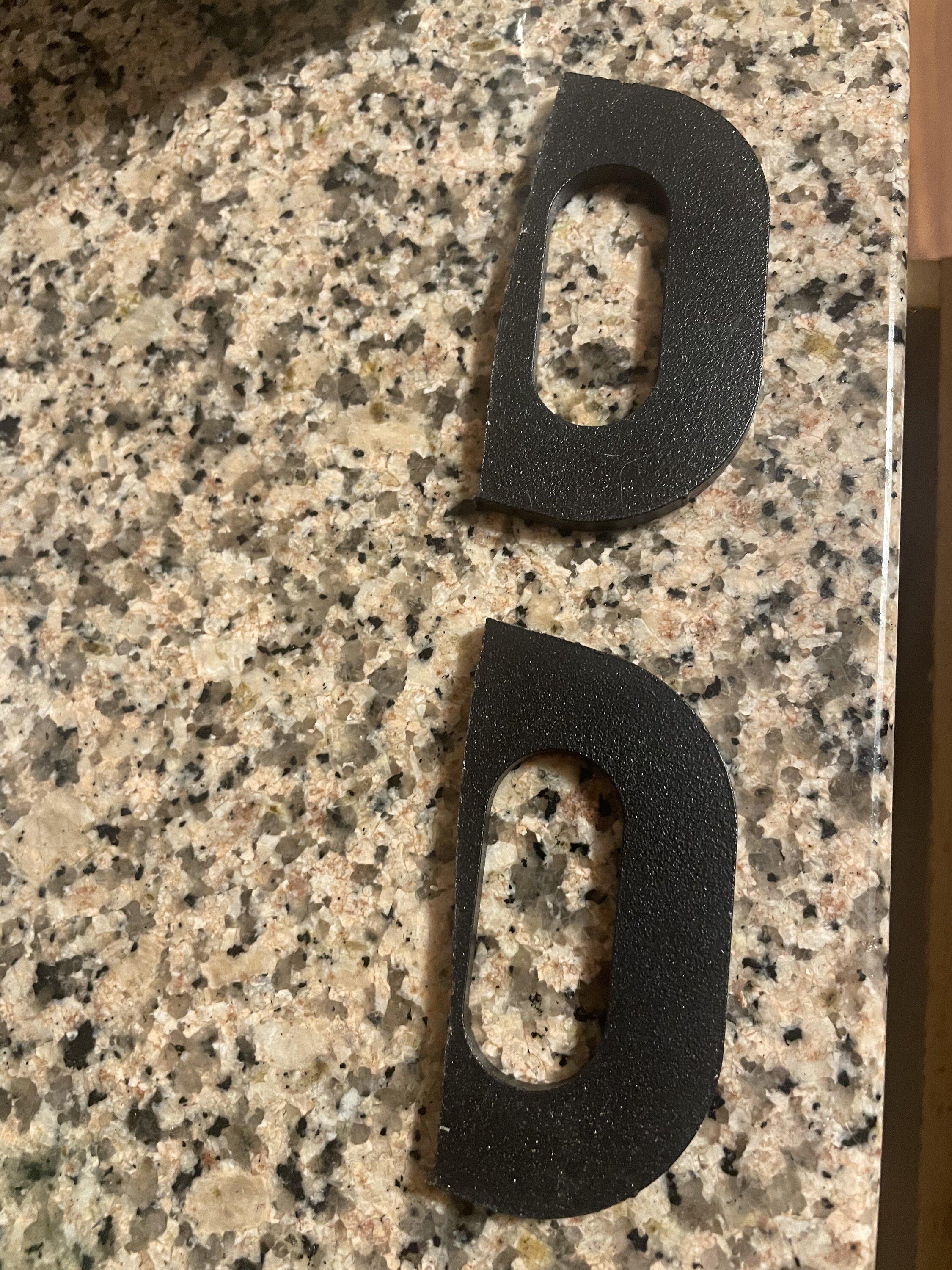

You’ll have to cut the LOD reinforcements. They don’t fit with the MOD bumper in the stock form. I installed them when I did my RC mount. The bolts they send lookk like the cheapest you can get. I re used the ford bolts. At least they have a rating stamped on them. The lower loop hits the bumper when trying to install. Unless they changed the design. I still feel they were a good addition. I can’t for the life of me believe JCR doesn’t have a reinforcement yet.

Ford Bronco Damage while using winch on improperly installed Rough Country High Mount 0F4824EA-9CD6-41E5-9C76-575D13D76BE1
Not sure you have to cut this much off but was frustrated from trying to get the bumper back on with my son. So I zipped them off flush with the frame while bolted on.
How thick are they? They look like only 1/8 or 3/16.
In any case, I'm not going to be tackling this right away, But I probably will next winter, in the meantime, I look forward to seeing what everyone else comes up with.
😲 I did not read the directions I took for granted they had you drill, sleeve and bolt through. So yeah, I think for the argument, it would be single shear, 4 times.
