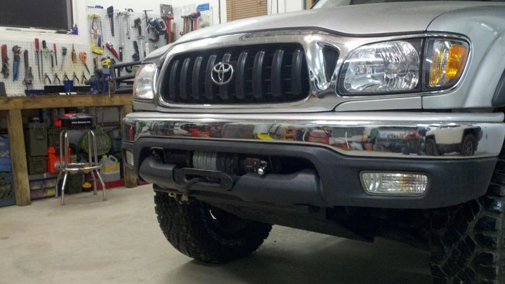

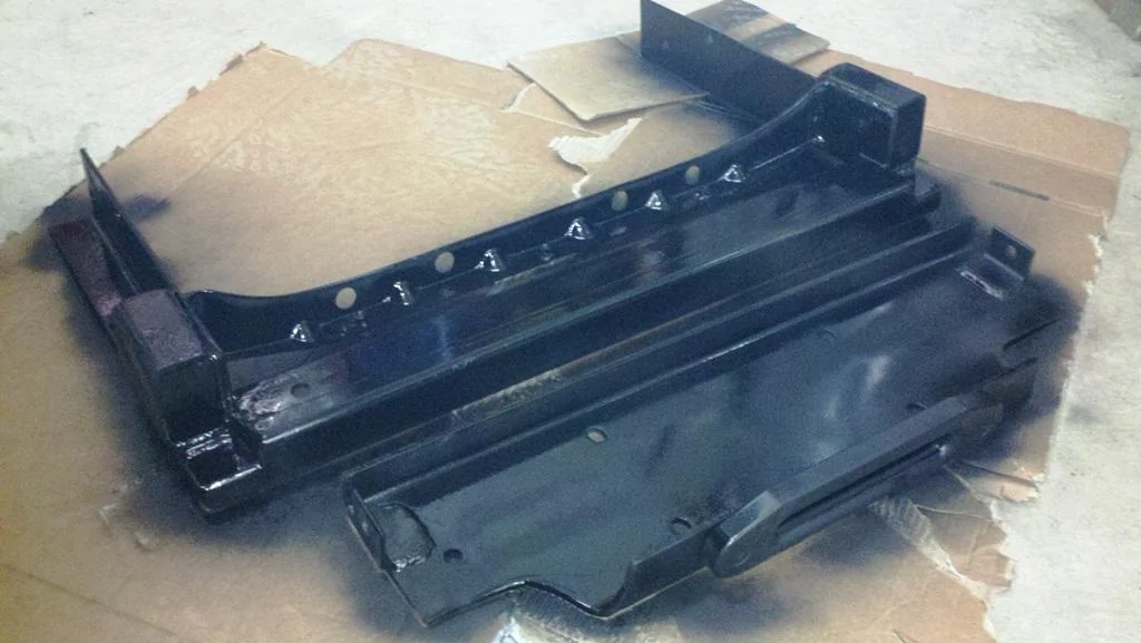

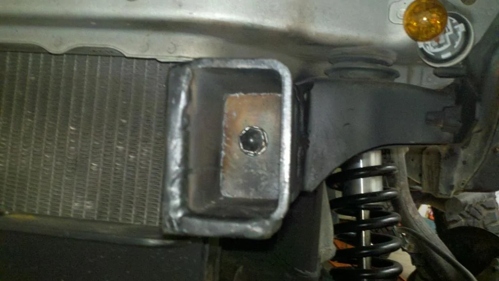

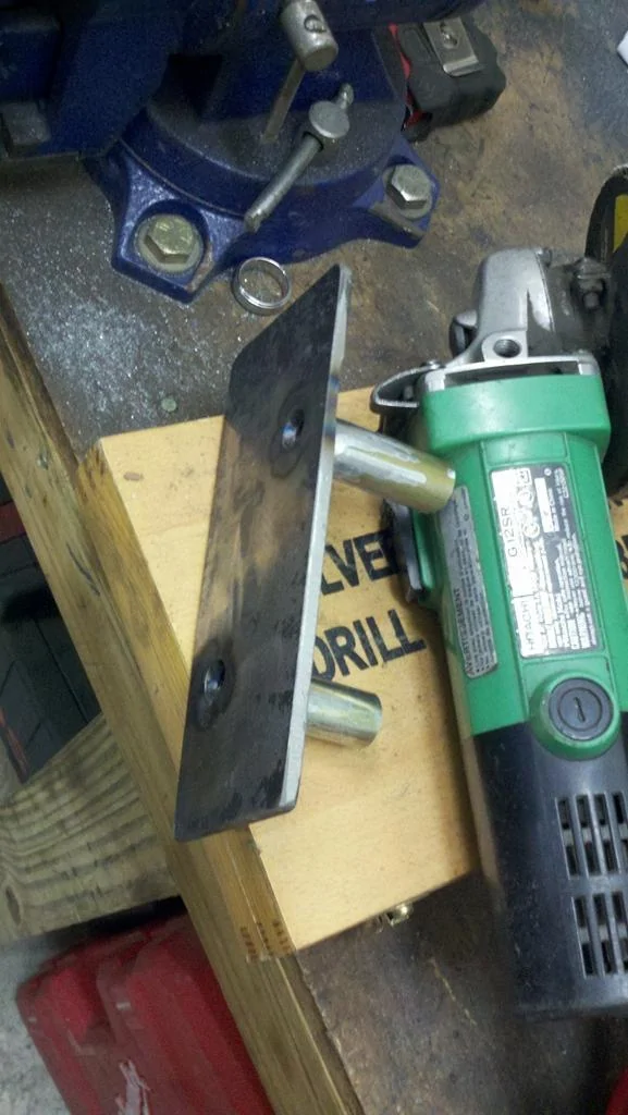

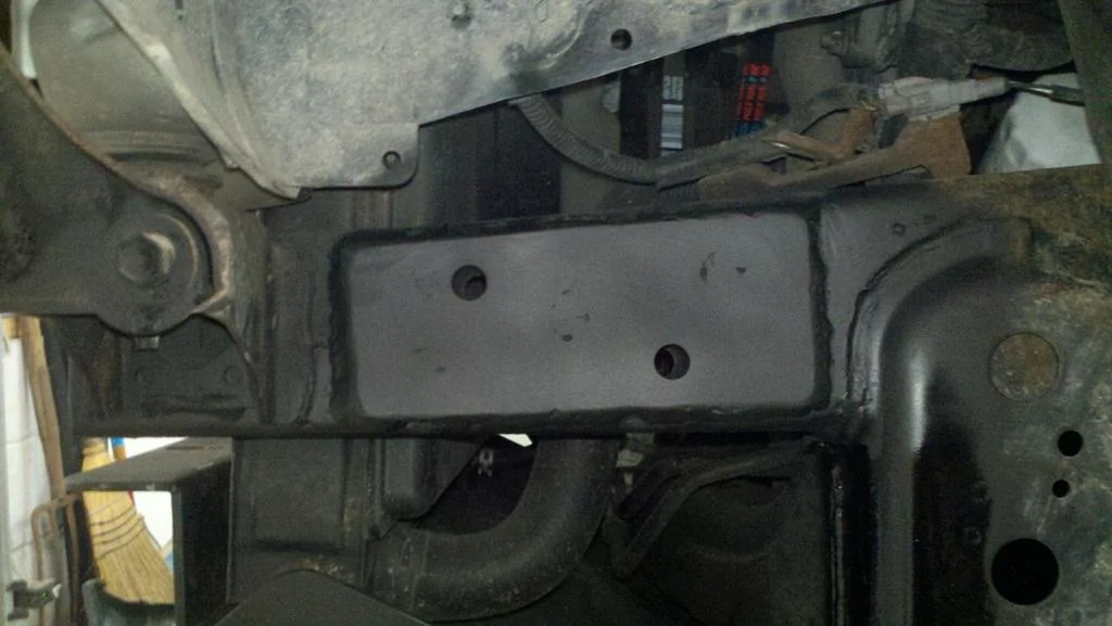

Well back in the day we never bought aftermarket bumpers either. We would take off the stock bumper, extend the frame horns outward. Mount the winch plate on, then made the bumper around the winch. Sometimes it came out looking cool, sometimes not, after a few beers everything looked awesome. Either way it took a beating and kept wanting more. LOL!!
That's exactly how I built the hidden winch mount for my Tacoma, it's not going anywhere and is still technically "bolt-on", but I sleeved and plated the frame.
Those bolt-on winch mounts for the Broncos are so cantilevered out and above the bumper attachment points I can't see how any upward pull would not bend something, especially with a 5K rig that's stuck good. I've had to make dead pulls with the winch point 12' up in a tree pulling at a 45' angle before........
I've always built my winch mounts so the spool was as close to centerline of the frame rails as possible, I realize that's a tall task on the G6's......so we ride with friends with winches and carry a Bubba Rope :).
