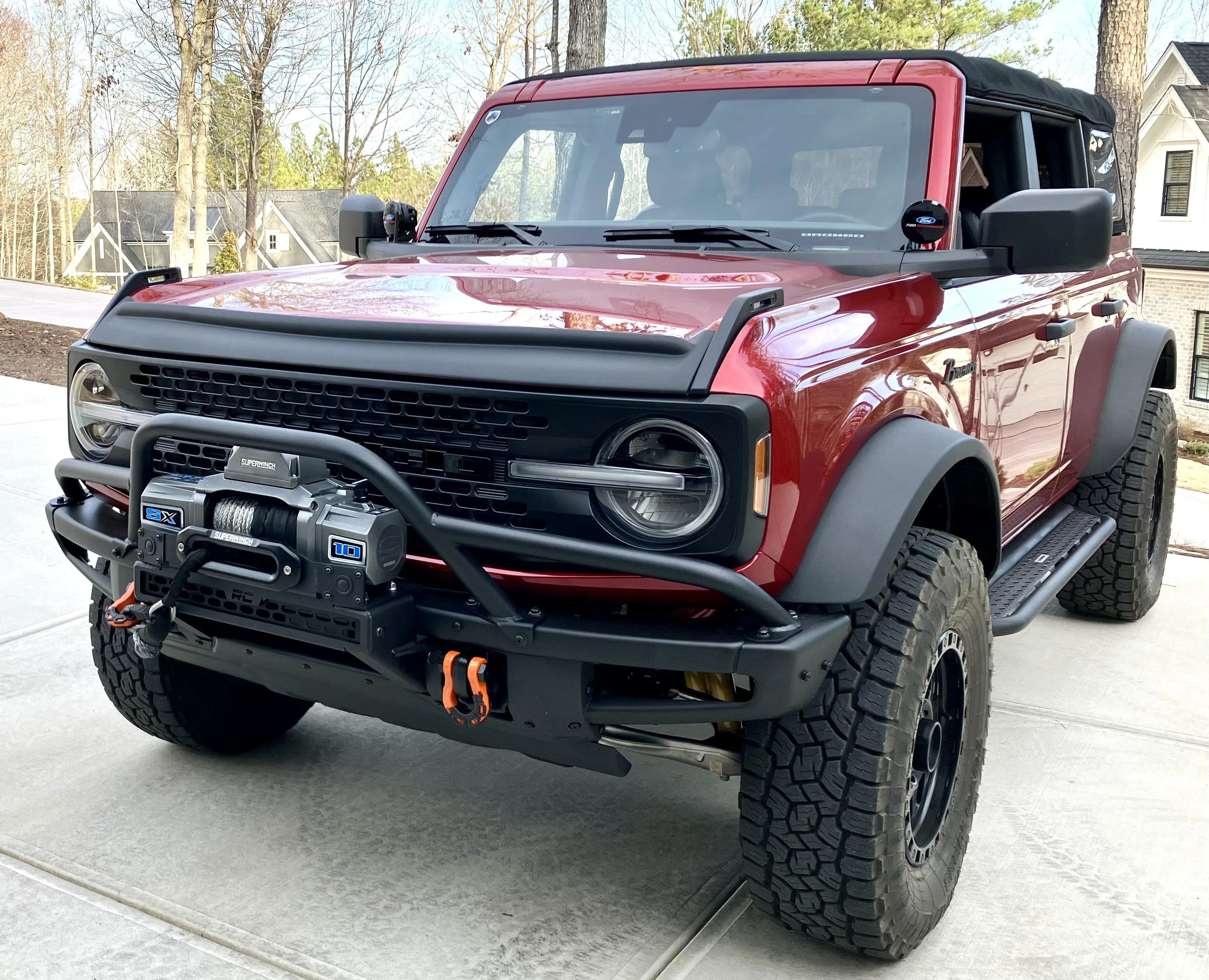

Thanks TD and others for this info. Looking forward to updates. I recently installed a winch with the RC high mount but haven’t put it to much use yet.
Ford Bronco Damage while using winch on improperly installed Rough Country High Mount A68964C2-2FAB-4CEA-BD89-3EF7787F0CA8
What prerunner bar is that? I want to do the same but I wasn’t sure about fitment. Do you have a side picture?
