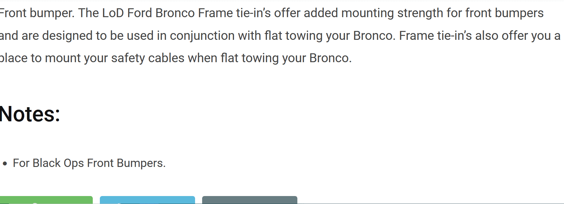

There used to be a blurb on their web site stating something to the effect those reinforcement brackets only fit their bumpers..I don't see it now so maybe I imagined it(shrug)
I found it.. however they dont say only for the LoD bumpers..well u can read it
Ford Bronco Damage while using winch on improperly installed Rough Country High Mount Screenshot 2023-04-10 204506
Hmm. Well anything will fit with a grinder and welder.
