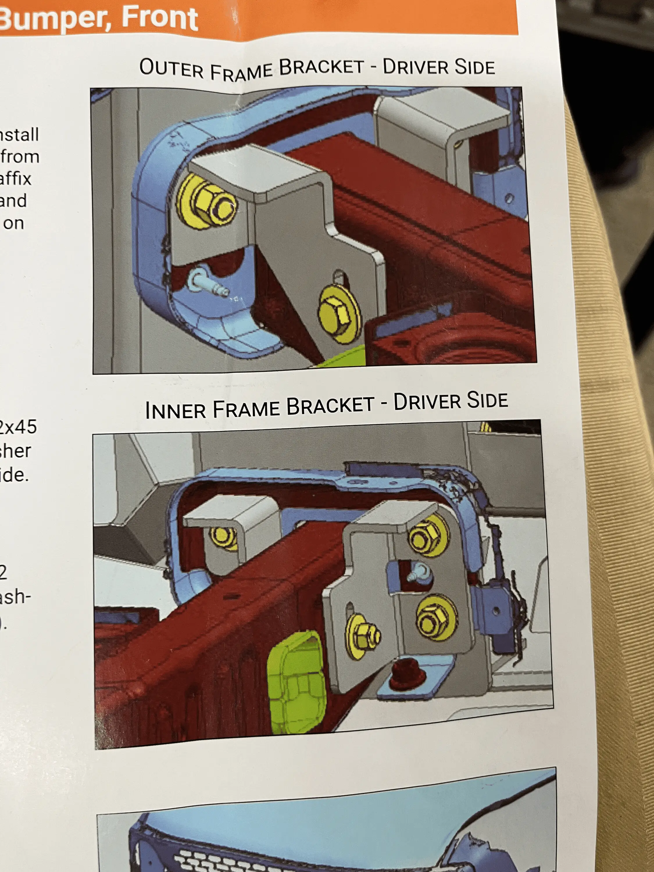

I was looking at the LOD Install instructions, and they aren't double shear at all, they are using 4 bolts and nuts into the frame rails per side...
https://lodoffroad.com/assets/pdfs/BFT2100 Bronco 2021 Front Bumper Frame Tie Brackets.pdf
Yeah, good catch, I was going off the photo posted here.
However, on this bracket, it certainly appears to be a through bolt based on the nut and threads on the other side:
Ford Bronco Damage while using winch on improperly installed Rough Country High Mount 1681258287515-png
So, four bolts in single shear or two bolts in double shear? That's kind of a question without a good answer. I don't think you'd be compressing the frame rails all that much even with two bolts, especially with the bumper bolts wanting to keep the bracket straight. It would take a lot of force to deform the crumple zone in the frame rails, given that's not the weak plane (it should be just as strong as a non-crumple zone in that direction) and the bracket would be spreading so much of that pressure out already.

Well, the RC hidden mount has four basic tie-in points...the lower frame rails where the recovery points are located, and then the front crossmember where the steering rack and a-arms are bolted on. The recovery points are in a single shear arrangement, while the crossmember points are in straight tension which is the strongest configuration for a bolt. Indirectly, it also ties into the RC front bumper via bash plate, but that wouldn't account for a whole lot of additional strength. One could also tie into the winch tray with a skid plate bolted to the crossmember and other points to really strengthen the mount itself where it probably needs it the most. When you use the winch, the bottom of that tray where the winch is bolted to is trying to pull forward, and all of the tie-in points are located above the winch line, so it's putting a bending moment on that tray. If you bolt a skid plate to that tray, and then bolt the skid plate to the bottom of the front crossmember and other places further back, then that skid plate will be able to eliminate that bending moment on the tray.
As it is, I think it's plenty strong enough, and it would take some serious effort to see any detrimental effects to it by winching...you're more likely to shear off the winch mounting bolts holding it to the tray as opposed to damaging the tray itself. It's never a bad idea to over-engineer stuff though.

Honestly, I'd kind of already dismissed that bracket setup with the single through bolt as an option..
I think the 4 Single Shear bolts of the LOD are more than sufficient for this application, and will most likely stay with a setup like that.
I do think a through bolt will deform the frame in this area. I have a TJ hardcore wheeler I'm in the process of building, I actually made the frame myself from 5x2 .125" Wall Steel Tube. I made a Mid Cross Member for the rear 4 link mounts, and put 4 bolts through the frame and a 3/16" plate on each side of the cross member, when I first torqued those bolts through my frame (80ftlbs), I got visible distortion of the frame. I took them back off and sleeved the holes.
I'm fairly sure my home built frame is stronger than the Bronco frame horns, Although the dimples would add some resisitance to deformation. I'm not at all worried about deformation from a safety aspect, as you noted, we gotta compromise, I'd be more worried about compromising the powder coat, and without a sleeve, I think the rails would deform even more over time. I also think it doesn't matter, I'll almost certainly go with a single shear or welding :)
I've got a Fab Fours Stubby Winch Bumper right now, It doesn't add any reinforcement, just uses the factory harware. It does keep the winch a lot closer to the frame rails (closer to the grill, and lower in the front) than the JCR and RC solutions, and I've done a few pretty hard pulls that were "down" towards the ground without any noticeable change to the angles of the bumper, But @Tricky Dick 's experience here definitely has me wanting to strengthen things!
