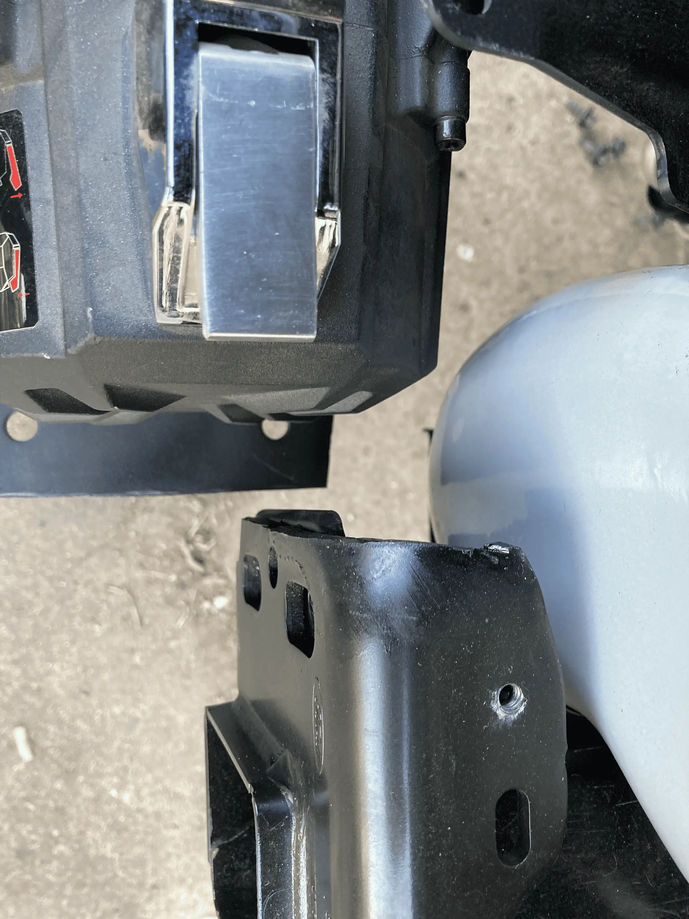

Let's dig into this a bit more. Do you have an angle finder? I would like to know how many degrees difference you have at these 3 points.
Well to me they look like they are all the same angle, but I am at work right now and don't have a way to check until I get home. 😁
Here is a pic I took last night if that helps at all.
Ford Bronco Damage while using winch on improperly installed Rough Country High Mount 1681481398662
By eye all three of mine are a little off from each other I think, so there may have been some movement afterall. Whether that happened as a result of the improper installation is undeterminable.
I can confirm...everything is flat and on the same plane, no different angles.

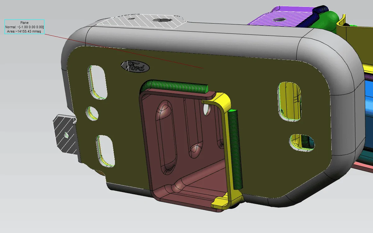

Let's dig into this a bit more. Do you have an angle finder? I would like to know how many degrees difference you have at these 4 points.
It's that weld bracket to frame rail is what gave way for me.
I can measure - but silly question
I see the 4 points but what angle are you wanting to measure?
from the surface plane of the bracket to what?
the surface plane of that bracket should be flat

Just the relative flatness of each point, it should take any ground slope out of it. Say one measures 90 degrees, one 87, one 85, etc.
