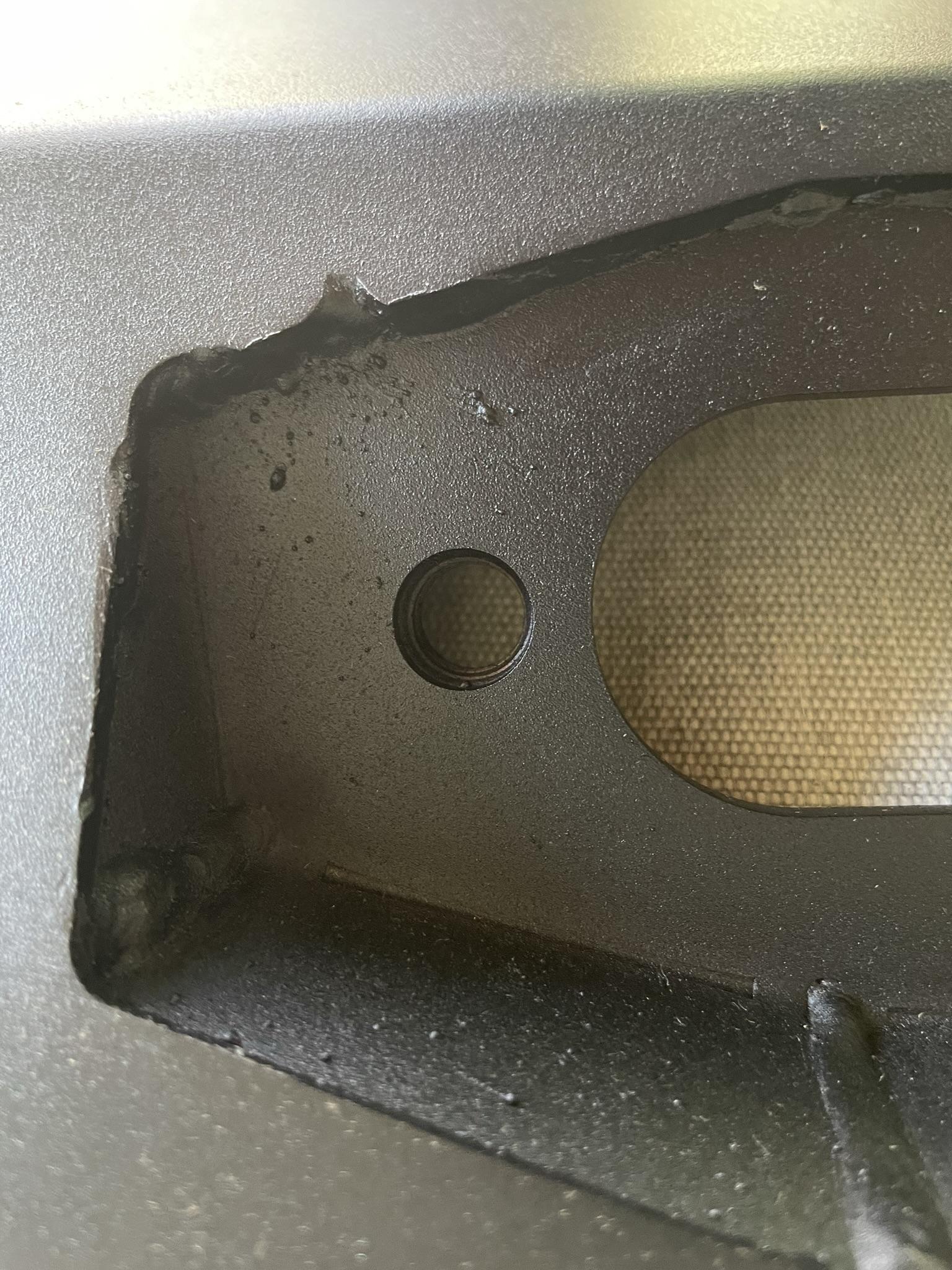

I gotta say, they really took a turn for the worse with the later versions. They just sent me a replacement skid from V6 and it's UGLY. The cutout for the fairlead is all angular, misshapen and super shoddy welds. I am going to suck it up and clean and repaint my V2 before I install that hot mess.
Yep, mine had the same appearance. I cleaned up some of the welds and slag on there before I installed my fairlead. What I really don't like is that there's no room for a conventional fairlead in there, only the RC, and it's certainly not the nicest fairlead I've seen. Very abrupt chamfering and none on the backside (though it's not 100% necessary on the back as long as your line is well centered). What I'd like to have is the Yankum grooved fairlead and I toyed with the idea of just getting longer bolts and using the RC fairlead as a spacer so it would fit...but I think that would really put the yankum fairlead in peril and unprotected on the rocks. I'm not super happy with it, but it's still one of the best options currently for a Bronco in my opinion.

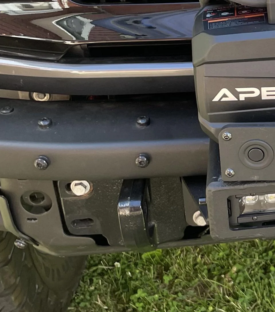

OK....so this is highly embarrassing and I feel like a total idiot but I need to come clean. At least some good discussion became of it and my Bronco is undamaged. I still believe after seeing the DV8 bumper video, this scare, and how Ford does it from the factory, that LOD plates or similar are wise.
I got it dissembled and it turns out this is 100% on me.
I left out some very crucial parts.
Nope, don't like that. The whole bumper and mount is pitched forward. There used to be 1/4" clearance between these wires and the grill.
I'm going to have to shim it back out and add some kind of reinforcement.
I did the same thing a few weeks back during a 30 degree pull but I had the spacers in. I changed bumpers from the capable to the HD mod after that and mine is still slightly pitched down. I haven’t had time to tear into it again to see what I can do to fix it. I will be looking into those LOD Brackets though.
