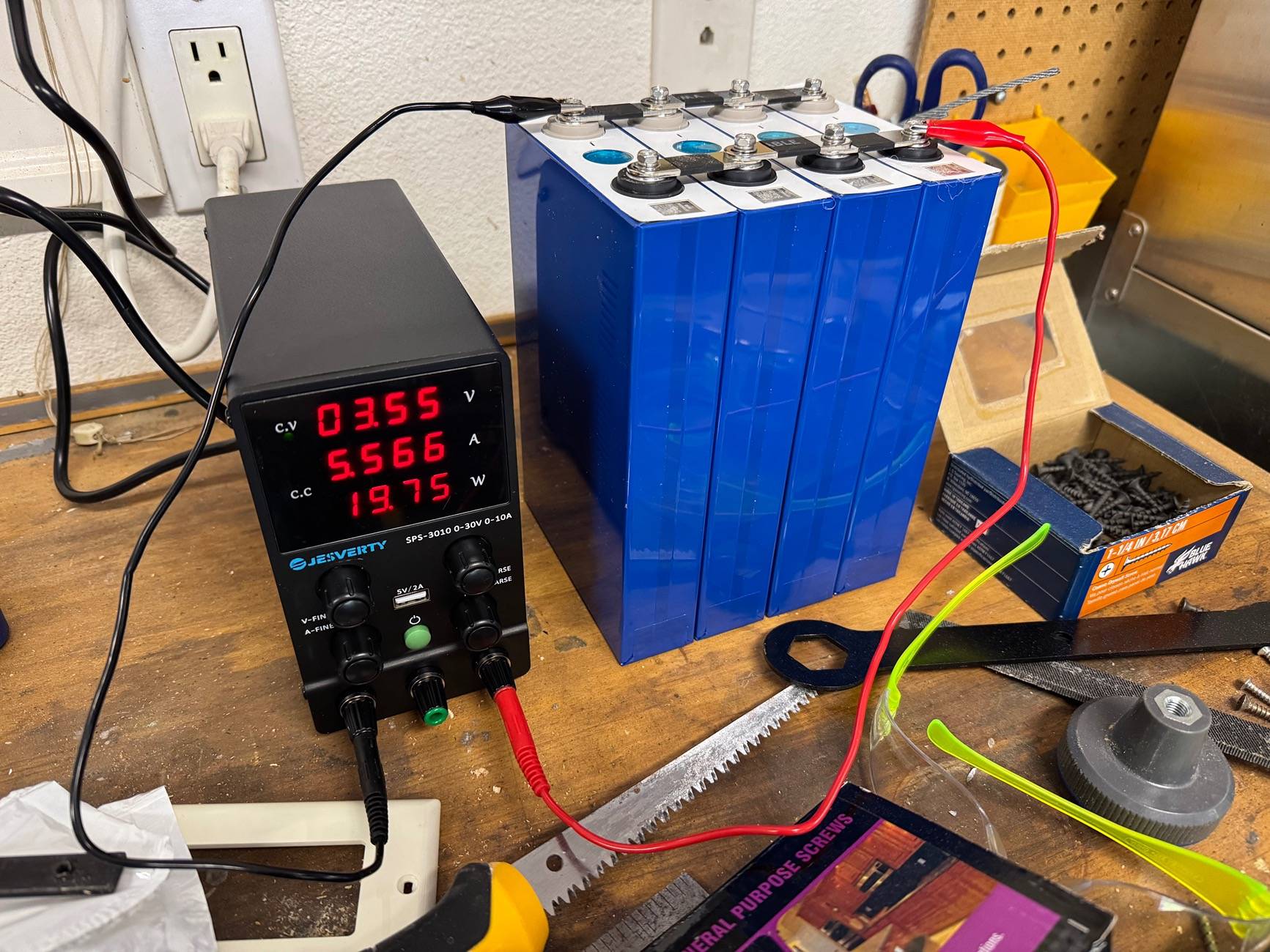

F- it, bringing this project back from the dead. Found a good price on cells and a BMS, totaling just $184. Can’t pass up the opportunity for a 104Ah battery for that price. Finished with my trailer’s lithium upgrade so it’s time for something new.

Cells have arrived! On to top balancing them…
Can't wait to see what you do!
Any chance you could share the link to those batteries so I could see the specs? I'm starting to kick the idea around for making up a power bank of sorts for my fridge so I don't need to lug around the Bluetti all the time.
