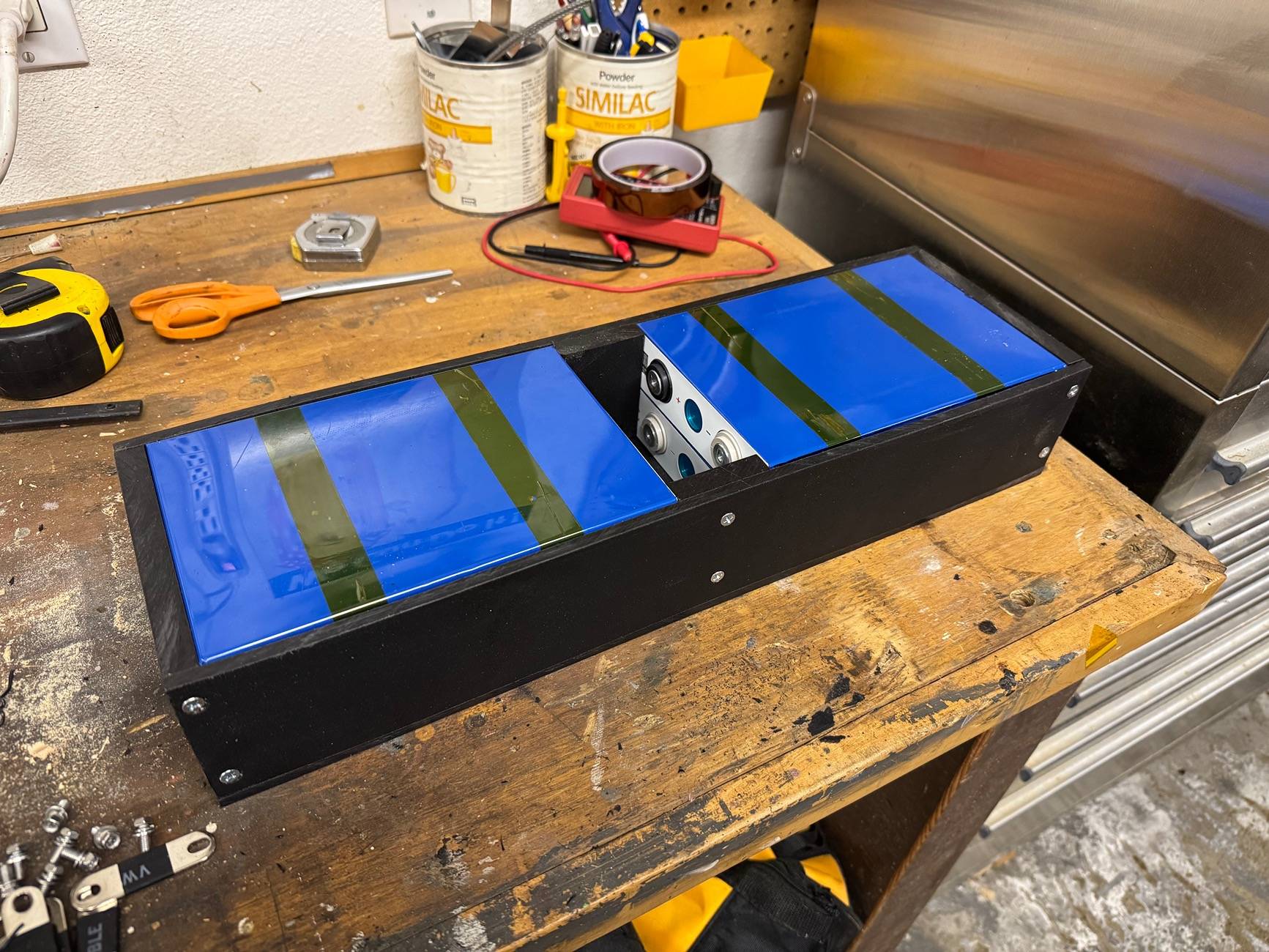

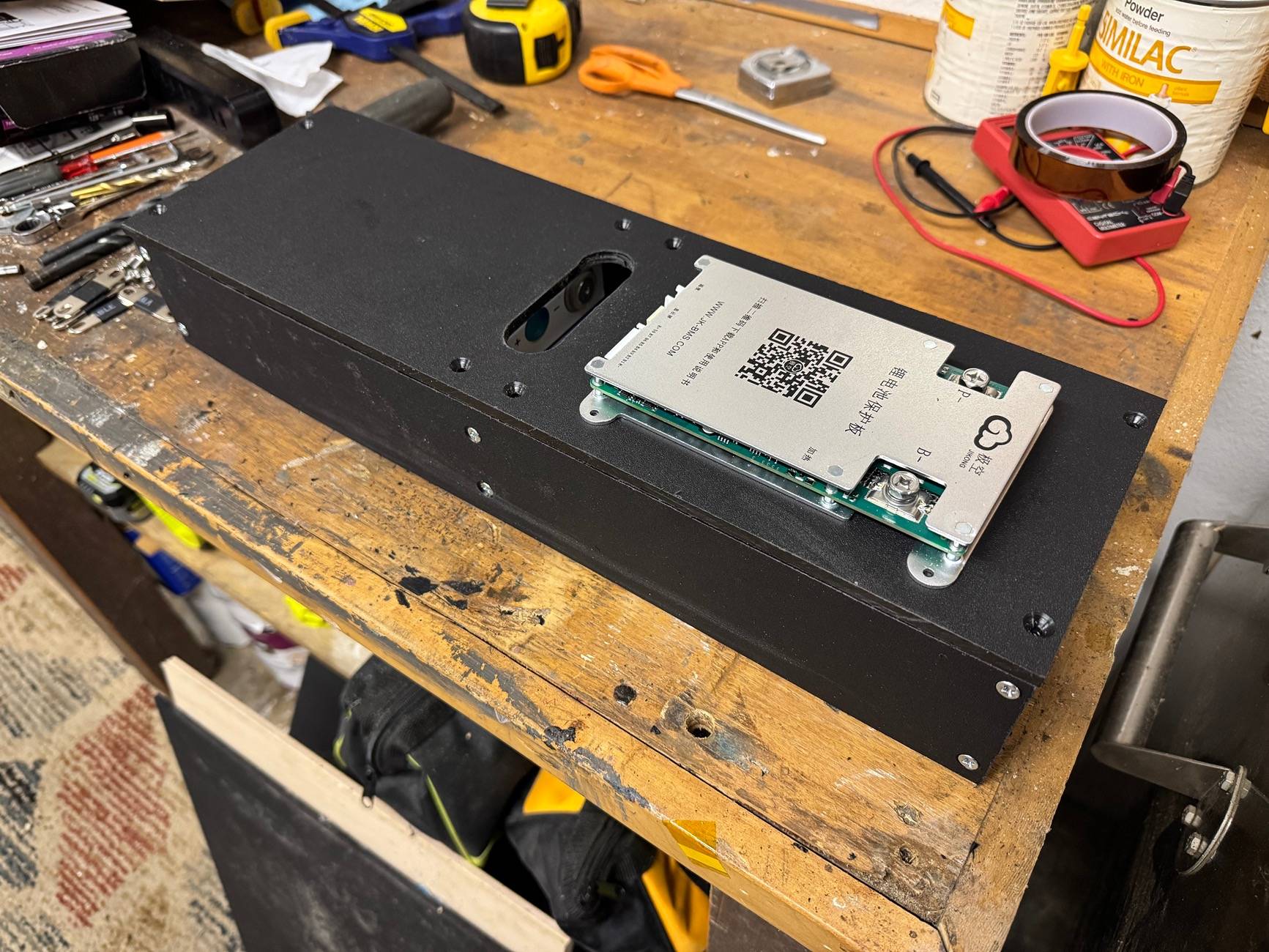

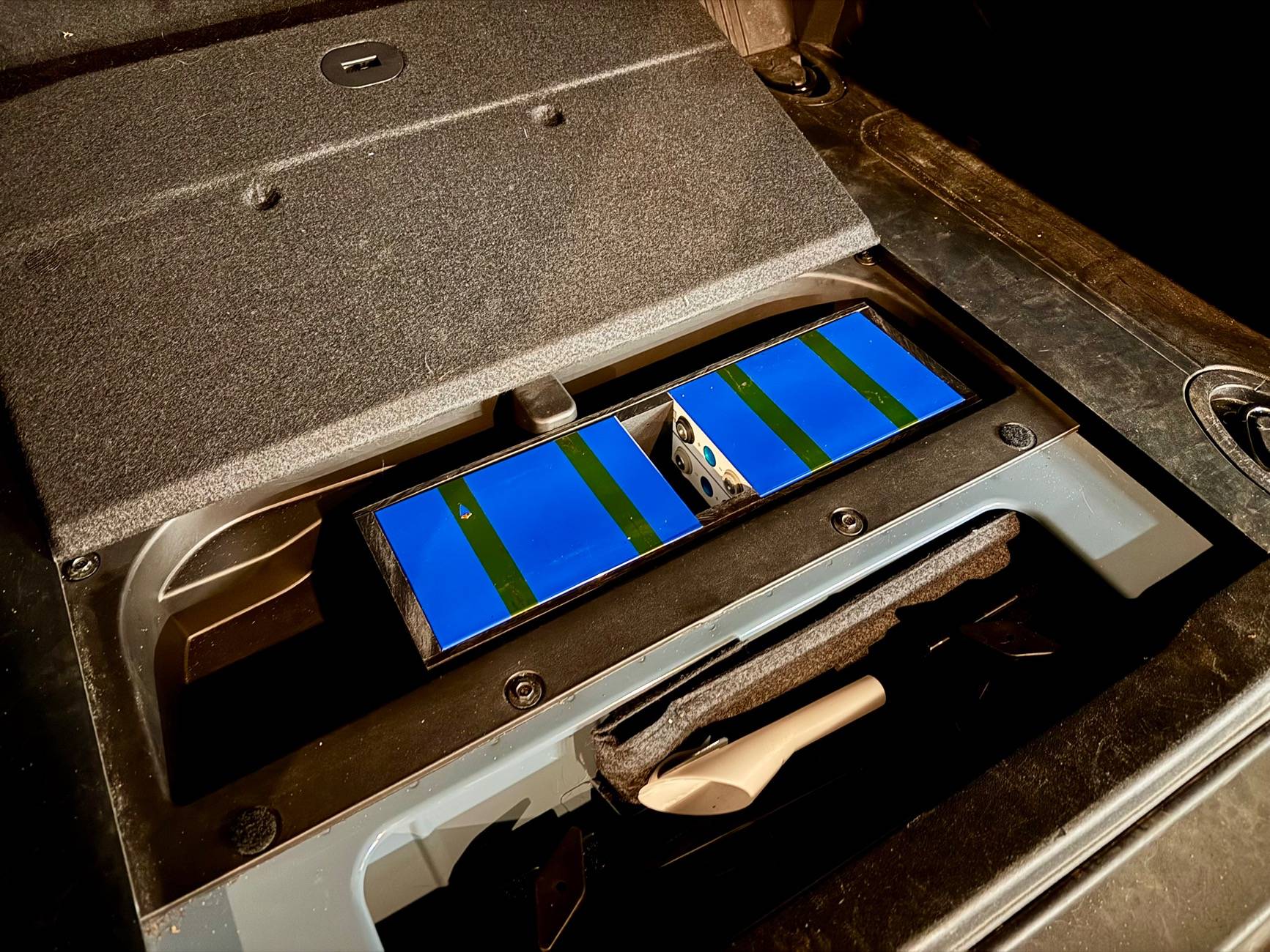

Made some progress on this little project tonight. Cells have been top balanced and the box is mostly built, just need to add some feet to the bottom and a cover on top. The base panel has a pass through for the wires coming off the cells that’ll run down to the BMS mounted on the underside.
Ford Bronco Custom Dual Battery Build IMG_5547
Ford Bronco Custom Dual Battery Build IMG_5549
What a cool project! Can’t wait to see how it turns out. Will that box fit in the stock cargo tray? Also, since the batteries linked are 3.2 V do you wire them in series to get to 12?
Yes, I’ve designed it to fit in the stock tray. Correct, it’ll be a 12V battery with the 4 cells wired in series.

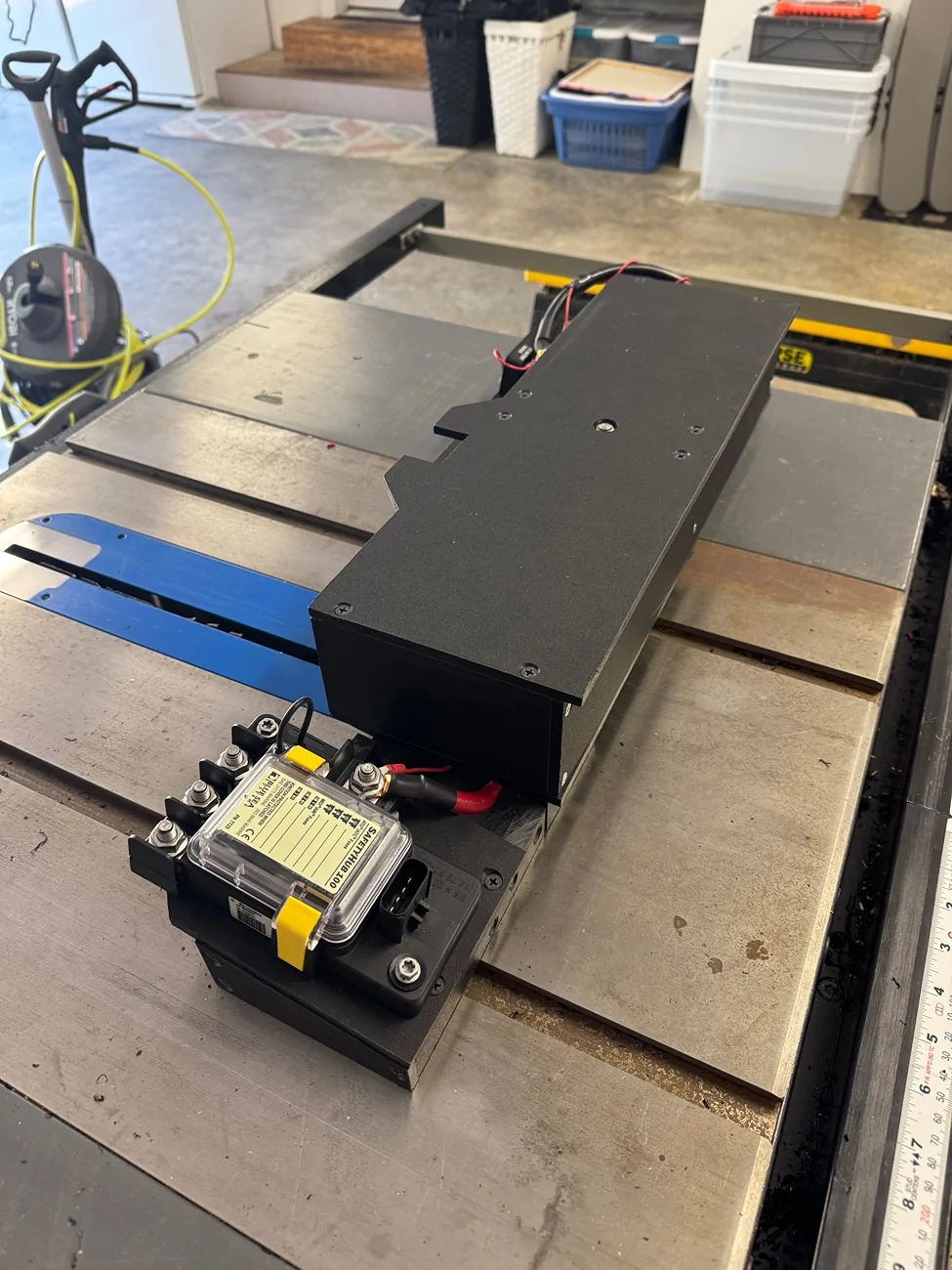

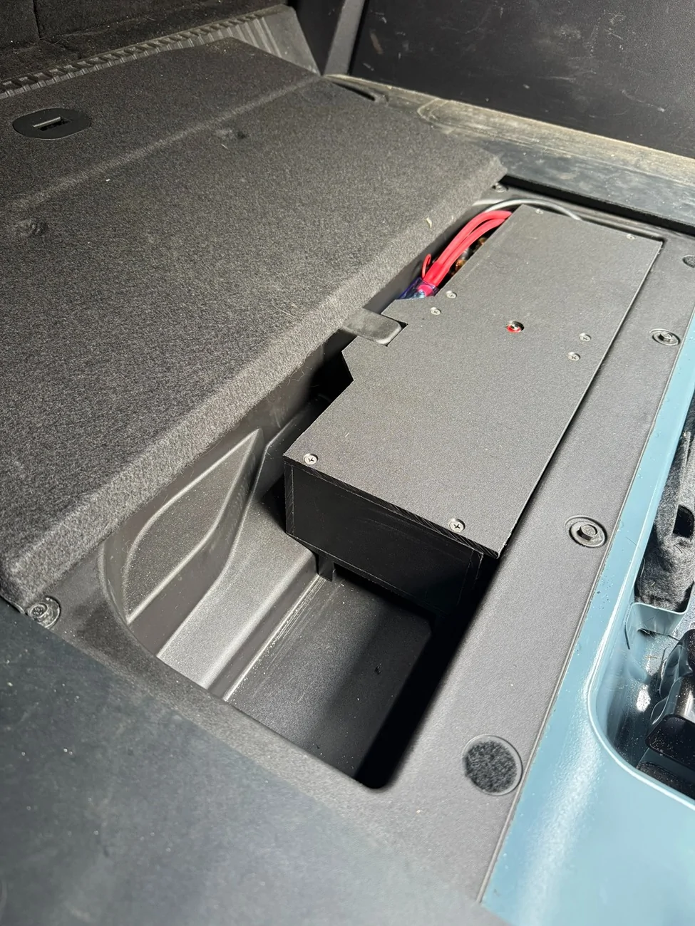

Feet attached. All that’s left is the lid and then I can wire everything together. Test fit was a success with plenty of room to spare.
Ford Bronco Custom Dual Battery Build IMG_5565

Looks fantastic! Any consideration to rewiring the factory 12V plug beside it to tap in to that system?
My plan is to leave that one as is and add 1 or 2 more tapped into this system.

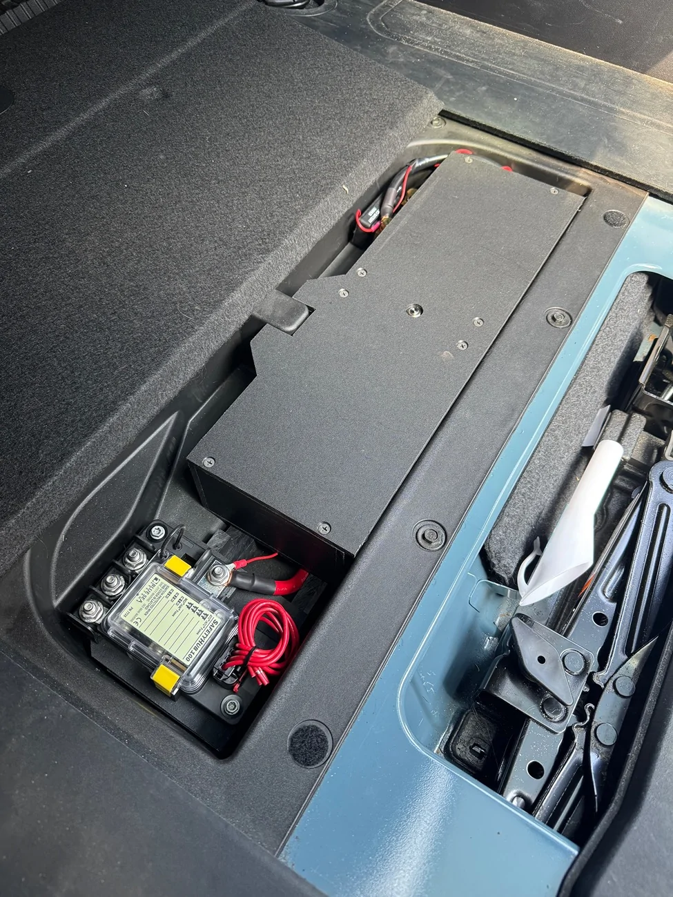

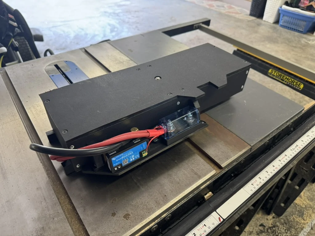

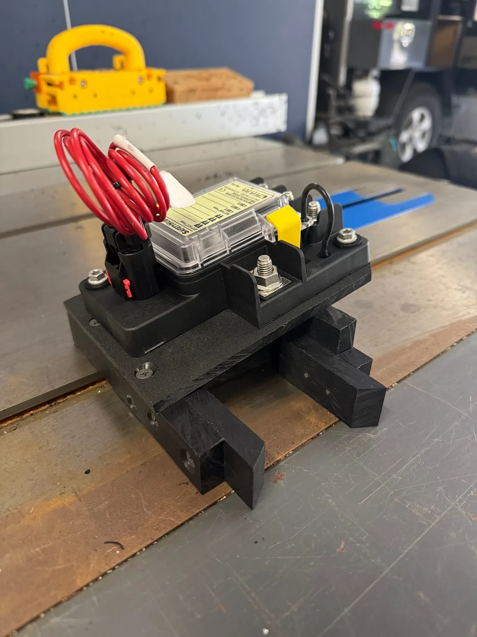

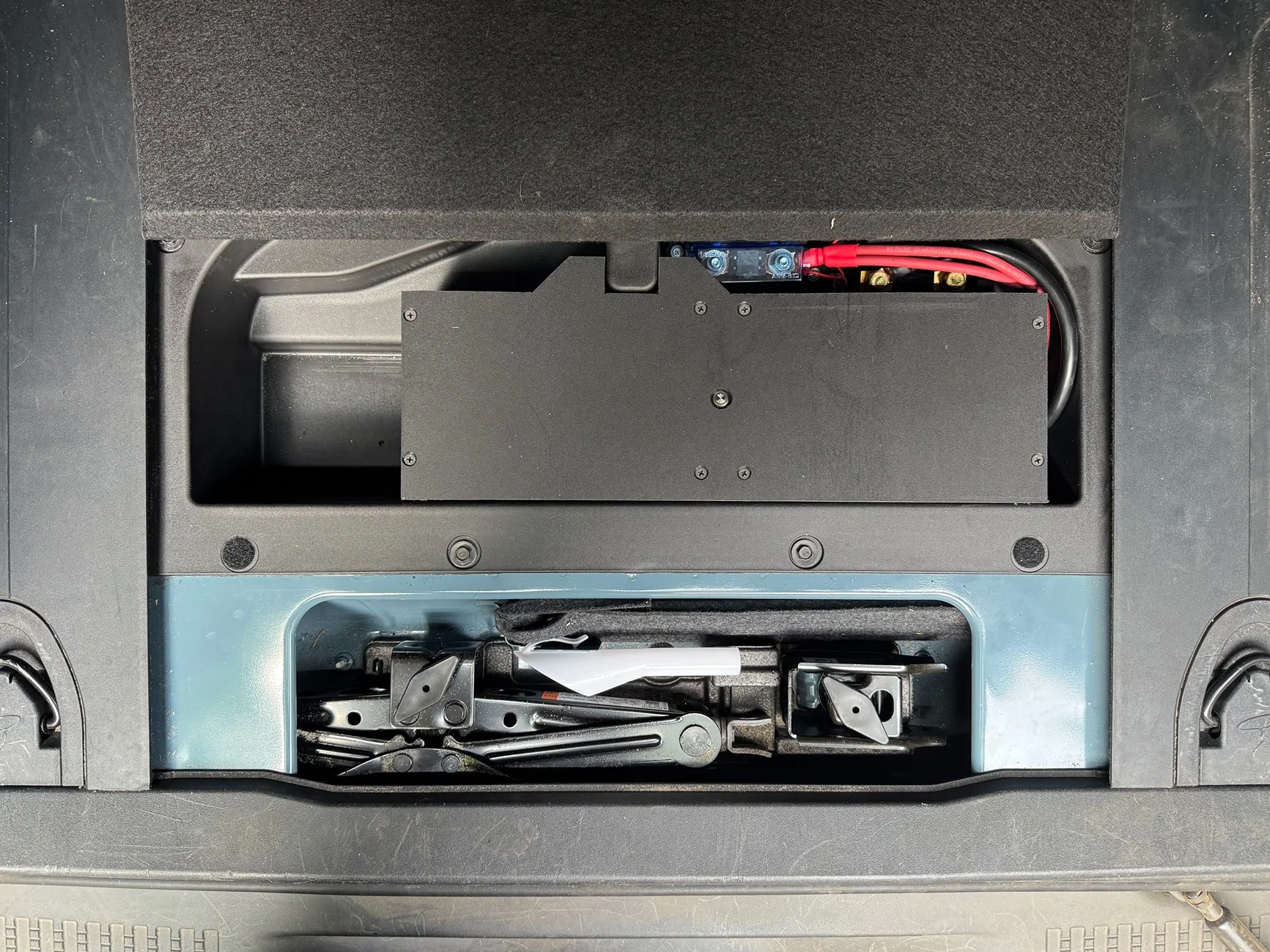

Version 1.1: Rerouted the positive wire over to connect to a sub-module I built with a fuse block mounted. This fills out the rest of the space in that tray nicely and allows the safe connection of several terminals.
Ford Bronco Custom Dual Battery Build IMG_5599
Ford Bronco Custom Dual Battery Build IMG_5606
Ford Bronco Custom Dual Battery Build IMG_5613
