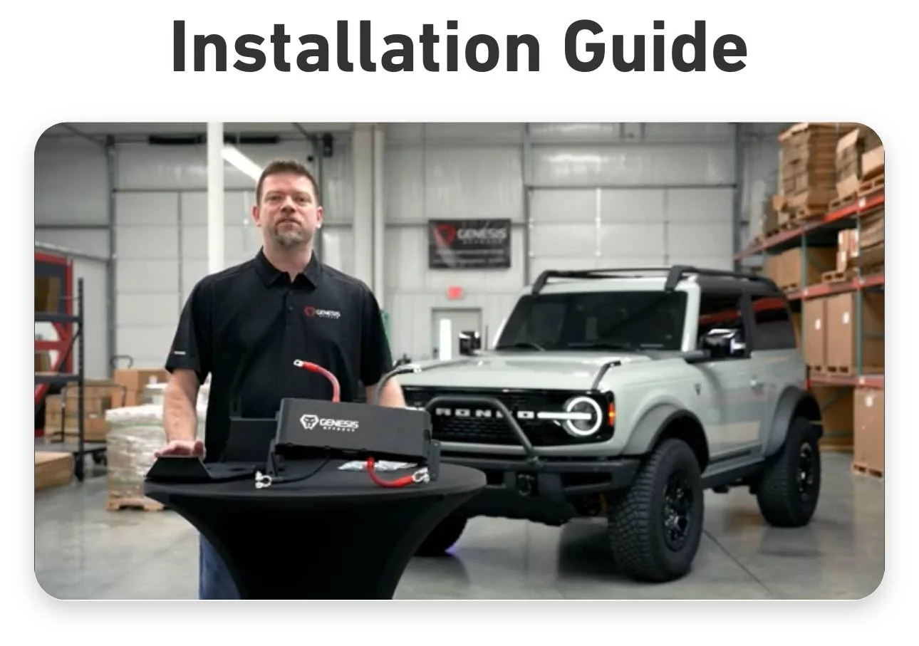

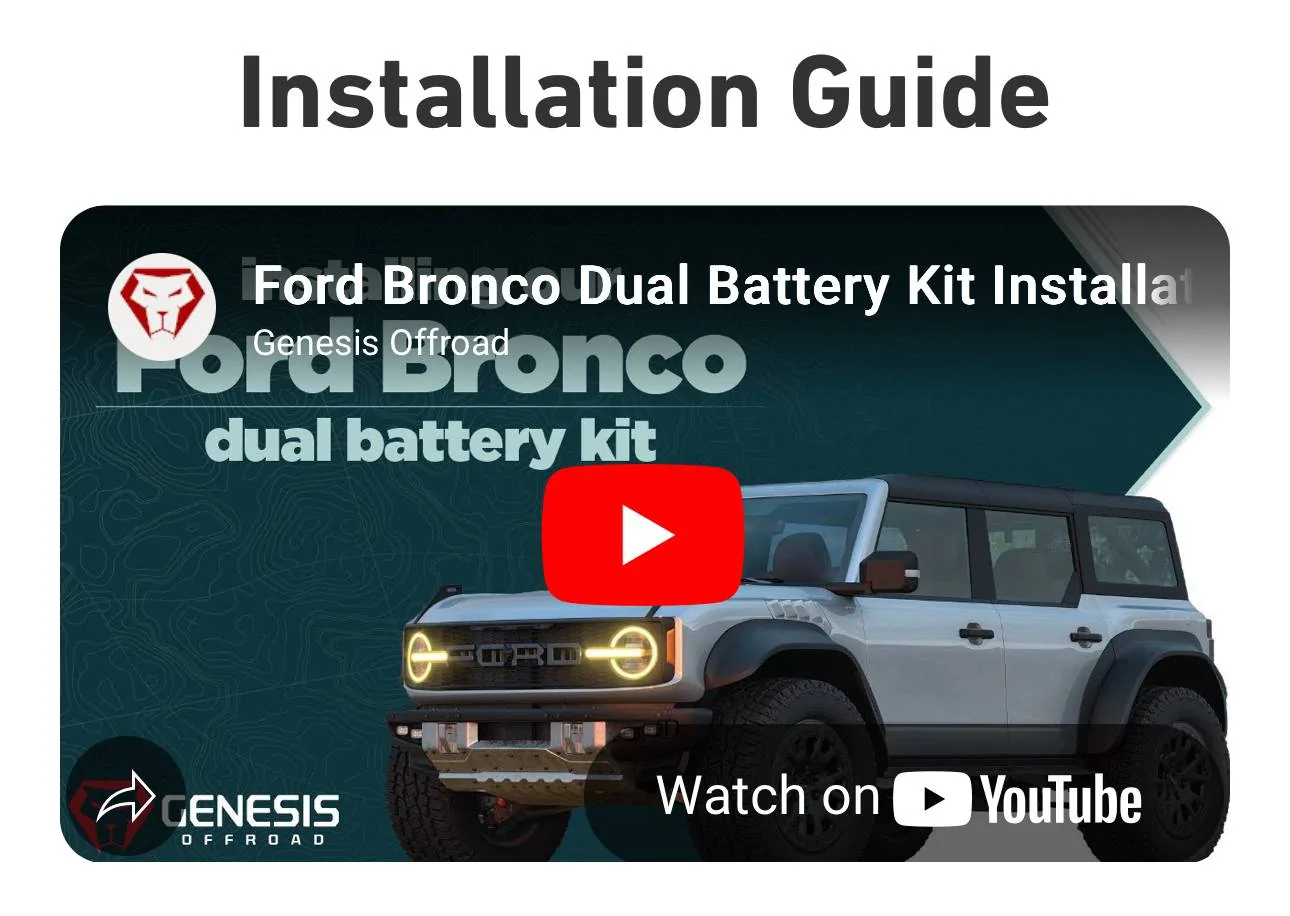

Hey Shane, I appreciate your response. I reached out and spoke with Mike a few times and it felt like he wanted to help, but was as stuck as I was and kept referring to the videos I had already watched. I am only making assumptions here in regards to the Raptor. Your videos had a picture of the Raptor at the beginning but the actual walkthroughs were on a regular Bronco.
From your site.
Ford Bronco Genesis Dual Battery Kit IMG_2402
Demo Bronco
Ford Bronco Genesis Dual Battery Kit IMG_2403
The dimensions inside are not the same and it was obvious when I was installing it. I have owned a non Raptor and the positive terminal wire bundle is different. The new battery tray you provided is not one you can just drop in like the other Broncos. It doesn’t fit. I had to make it fit. I gave this feedback to Mike, what was done with it is on you guys. I asked if this had been tested on the Raptor and never got a clear answer which made me assume it was a no.
Am I happy with with your product? Overall yes, it does what I want it to. You were up front about the size of the batteries and I understood that going into it. I had to pull the entire fuse box up and trim a bunch of plastic for the battery tray to fit. Not to mention the use of a rubber mallet, a stripped bolt and taking the lords name in vain multiple times before it barely fit in there.
The point to my response. I haven’t had any bad interactions with your company, just not overly helpful. In the end I figured it out and I know how to deal with most of the issues now that pop up. I don’t want to pull it out and use anything else, like I said I am happy with it. To be honest I don’t know if I could get it out now. It’s not a cheap setup and I think most people who are willing to spend that expect an exceptional product and experience. If it would have been someone like my wife installing it who has zero electrical know how or any common sense when it comes to this stuff, she would have just set the whole truck on fire and started over. Because to be fair, people like my wonderful wife order this type of stuff as well.
The fact you are on here talking to us is great, I really do appreciate it. I mean no offense to you or Genesis, just speaking about my experience is all.
