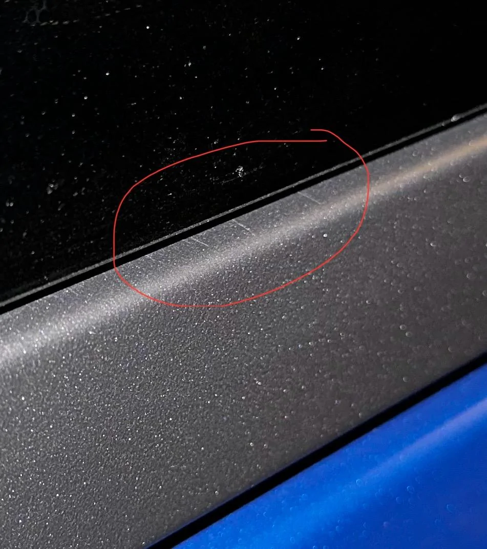

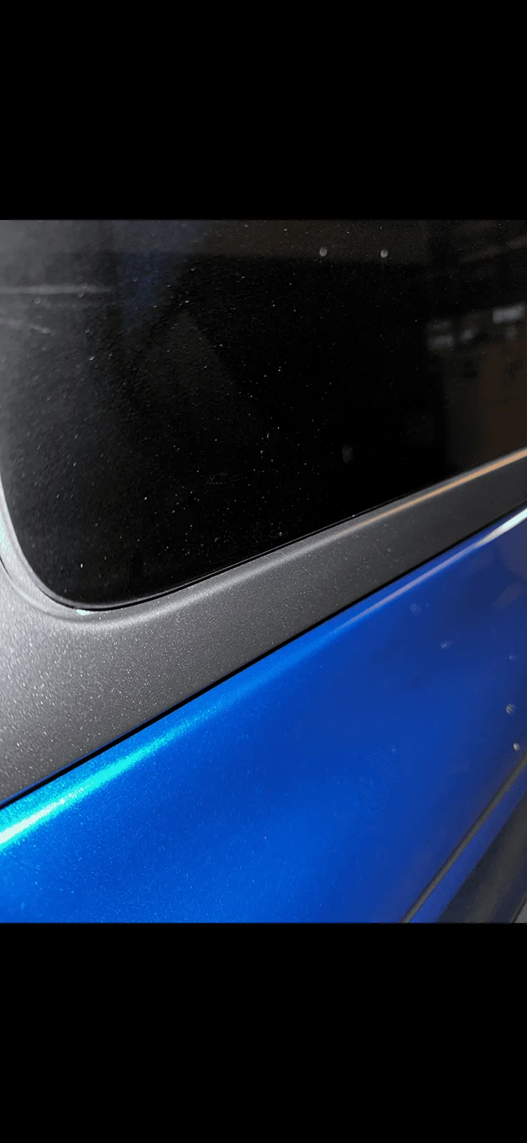

As I’ve mentioned before and in my previous post, here’s an example. This is my own Bronco (4th top). At first glance and even inspecting very closely there appear no cracks. But get a flashlight on it at a certain angle and you can see the cracks forming. This is how it all starts and then the cracks (white lines you see) will start to open up and become real hairline cracks.

Thanks for the pictures. This will definitely cause me to do inspections from time-to-time (and what to look for).
In see you are in AZ from your postings. Do you think the extreme heat might have anything to do with it? What temps have you experienced with your Bronco? Any correlations to the heat (in your opinion)?
Thanks again.
Thanks again.
Yes, I think it's wise to do periodic inspections. At least once a month. In the dark with your phone flashlight is the best way to find the cracks. In indirect natural daylight is the best way to see any delamination on the very top. Snakeskin (which honestly seems to be the least apparent now) can be seen in pretty much any lighting, but flashlight usually works best. You may be disappointed by doing the inspections and finding things, but at least it gives you some reaction time to file a warranty claim before it's too late. I will be out of warranty by end of the year and am on my 4th top, so I'm either going TOR or primer & paint over my OEM MIC with hopes that strengthens it up a bit.
Now to answer your question......no, I don't think the extreme AZ heat is causing it. To be honest, I think the dry climate is helping it. I haven't had any significant cracks like others, as mine have been small hairline. I think those in more humid and wet climates are somehow getting water/moisture into the top, and that is accelerating the cracking by the interior cardboard core getting wet and expanding / causing the cracking. All theory though, but I bet I'm not too far off.
