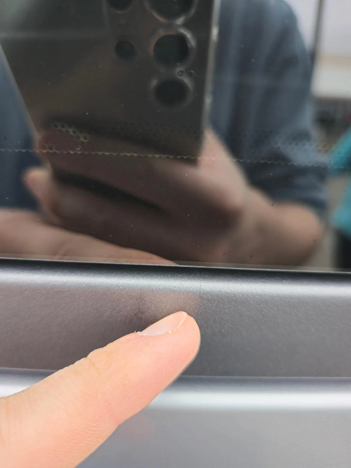

Baby powder applied will also show cracks. Smear it around.

Unfortunately these cracks have become "normal". Those who say they don't have cracks or delamination either haven't looked, haven't looked hard enough, haven't used a flash light, or haven't inspected the top at all angles in multiple light levels. I'm onto my 4th top and believe my current one is only a few weeks from showing signs of new cracks.
Listening to folks on the forum, it sounds like those of us with cracks are in the minority and the squeaky wheel. I know how the internet is and that bad news about something in a forum is not always the majority, but...
Since discovering cracks on mine and my revealing day at the dealership lots, I have checked 30-40 Broncos in the wild. I started to take pictures of each one but it seems documentation is just for me and I am well aware of what I see. Also, I was tired of the creeped out glares as I got up close to random Broncos to get pictures.
I have gotten "trained" enough to spot a delamination or cracking issue while sitting in traffic next to a Bronco.
Still at a 100% "failure" rate.
At this point, I think that the best bet is to mitigate the issue with Line-X. An upfront investment of around $1,000 pays for peace of mind, some extra sound-dampening, scratch resistance, and an end to visible issues. A couple of members have posted their results and they look promising.

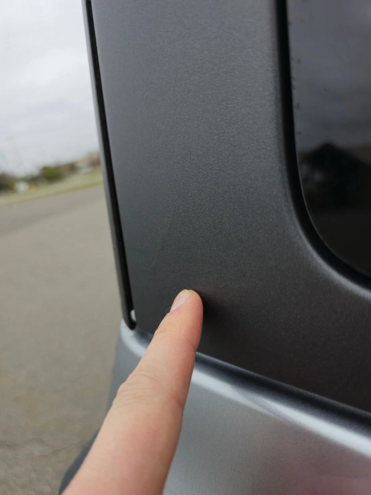

I just purchased a 2022 Badlands from a Ford dealer in Florida with 4,000 miles I recently noticed hairline cracks near the right side window Will Ford replace the rear section?
Under the warranty they should replace the top. I know this process after 3 replacement tops!
Yes they will.

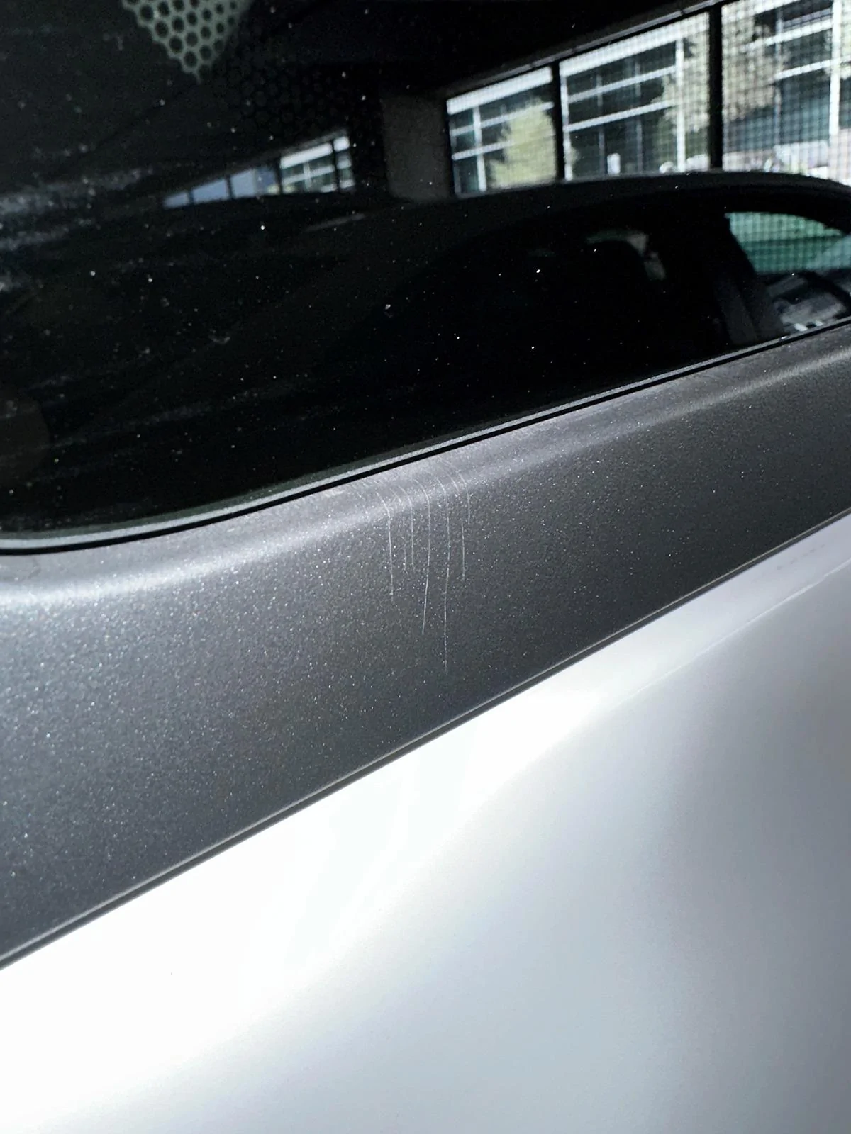

I pulled a creeper move today and checked out someone else's hard top in a parking garage. All looked good and completely unnoticeable until you put a light on it (as seen in my photo with flash on). Guarantee this owner has no clue their hard top is cracking, just like many others who think they have a good hardtop. The cracking was on the passenger side rear window (4-door Bronco). It seems the passenger side is more susceptible to cracking than the driver's side, but wonder why.

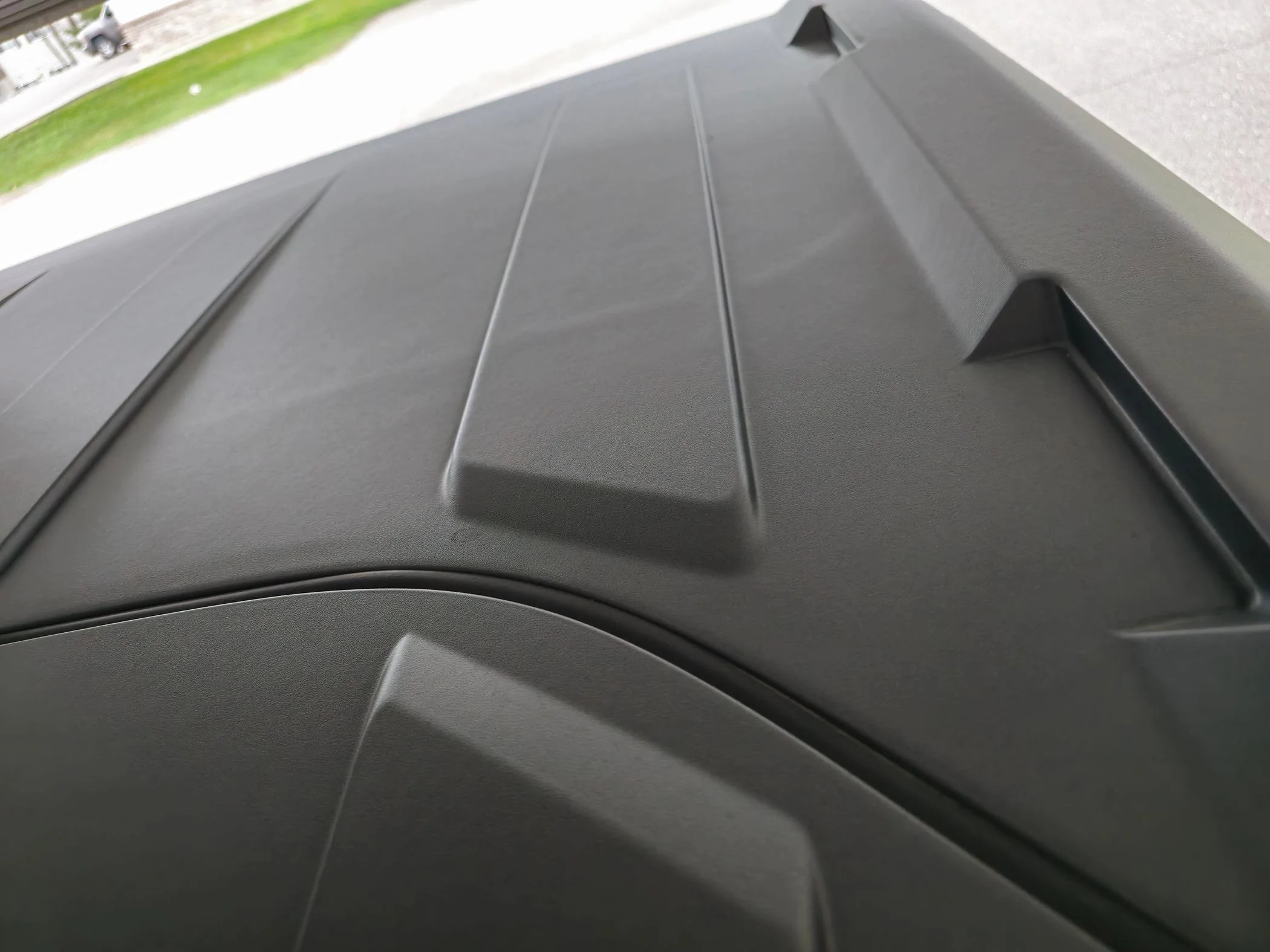

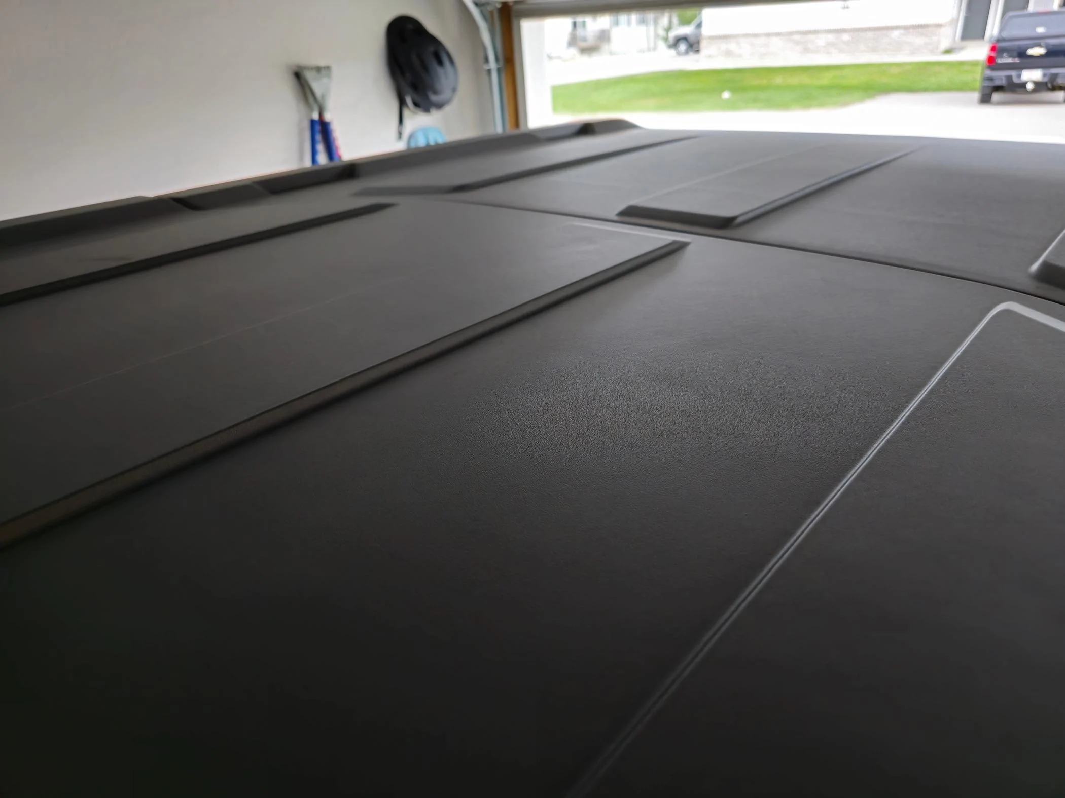

Can someone give me tips on how to approach my top getting replaced under warranty? Looks like deamination along with cracks. This is incredibly frustrating.

Take it in. Show them the problem.
It all depends on your dealership. If you bought it there and they are decent, they will probably just take pictures while you are there and start the process.
Unfortunately, everyone around here wants it for a couple of days (?) and in my case, it just gets denied.
I just submitted a claim through the BBB a couple of days ago. Supposedly that gets them moving quicker.

Also, rub some talc/baby powder on those cracks before you go in. I'm tired of this delamination nomenclature. Those are cracks. It's cracked. This should not be the stupid back and forth that is has become for some of us.
